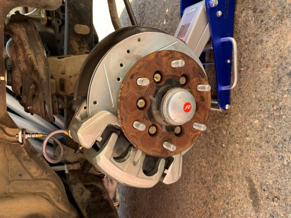

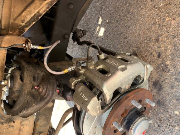

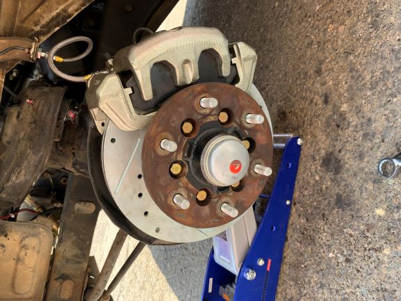

    Beautiful stainless line. Gold ends compliments body color.
    Hidden secret...
    Overall - a pretty easy swap. $108 for plated/drilled/slotted rotors and ceramic pads, $135 for rebuilt calipers that are also plated.
    I think the spindle assemblies were $75.
    Pop upper and lower ball joints, tie rod and brake line. Load assembly and done.
    I don't think it will need an alignment, but I'm going for it anyway.

    Excellent The hose looks close to the upper control arm - doesn't get too close under full lock on the steering? It would be a shame to ruin those nice new hoses from occasional contact.
  3. #203
    12-21-2020
    192
    Carson City, Nevada
    4G52
    ^^^ I checked for full lock interference. Even though it looks close in the pix, there is room. That is why I added the "S" bend to the line.
  4. #204
    Quote Originally Posted by boozehero View Post
    Knew you'd have the insight to make sure there wasn't contact, but it's better to ask

    The other side... Right side is done.
    Almost doubling the brake capacity, it really didn't make a huge difference - yet.
    I am driving normally and have been "seating" the new pads.
    The plating (nickle) is wearing off on the contact surfaces of the rotors.
    The pedal feels the same, I was able to flush the old brake fluid and add synthetic DOT 4 juice.
    All of the air was bled from the system.

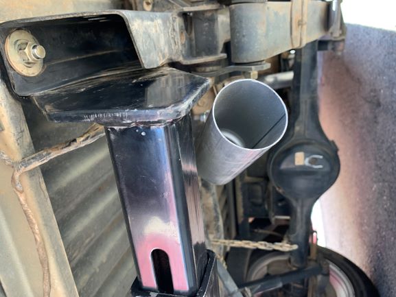

    I mentioned that I am installing a class III receiver on this rig. I have to cut the tailpipe and install a 45* turnout to re-route away from the receiver assembly. I also have to remove the license plate mount assembly.
    I bought a Curt "Multi Fit" receiver and have to modify the chassis mounting tabs. It looks like it will fit properly once I am done. Pix soon.
    My plan is to rent a Uhaul trailer and load all of the crap I have here and drive to Baton Rouge, then to Syracuse, NY.

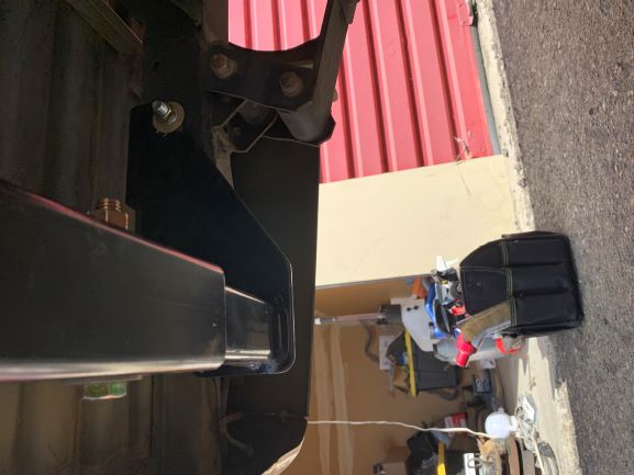

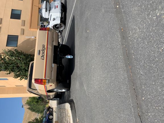

    More Pix:
    Detail of frame mount
    I had to cut almost 24" out of the tailpipe and install a 45* turnout.
    The tailpipe would have run straight into the receiver.
    There is a lot more clearance between the receiver and pipe. The pic is misleading.
    Yes Dicky, that's a big pipey. (2.25" big)

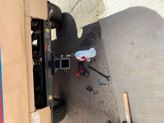

    Finished product.
    I am pretty sure I should NOT tow a Caterpillar D8 with this, but a puny Uhaul trailer will probably be ok.
    From a distance right there next to the Harley trike. Not a great pic for detail since there are too many shadows - sorry.
    Anyway, you get the general idea. They do not make a class III receiver for this truck (anymore?) I looked.
    "If you can't find what you need, find what works" Quote - Mr. Hack and Slash.

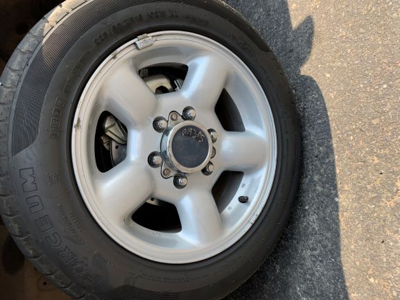

    I actually went to the tractor supply store and upgraded to grade 8 hardware from grade 5. I also used grade 8 lock washers. It's pretty solidly bolted to the frame, even though it wasn't made for this truck.
    I am pretty sure nothing will shake loose.
    The truck rides amazingly well. When I installed the front brake upgrade, I replaced the lower ball joints - which had very little wear. The uppers were tight.
    The PO had installed Delrin bushings in the idler arm, so that is tight. I checked everything else and (surprisingly) everything is tight.
    The dust boots have all rotted off long ago, I will be cleaning out all of the tie rods and installing new dust boots and grease.
    I also ordered a (new) matching extra wheel and will order a new tire too. It was a surplus buy from a closeout.
    One note - Going to 225/60-16 wheels and tires has to be one of the best handling improvements I've done to this truck. The tires "Z" rated - to 148 MPH - and you know this rig will never reach that speed.
    The one good thing about having such a high rating on a light truck: The sidewalls don't move at all, and the ride is surprisingly good for such a stiff tire. The 14" stock tires weren't even rubber bands by comparison. They were mush.
