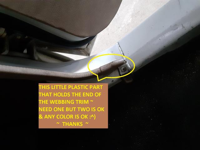

    boozehero ~ if you make more yard visits I'll pay for your labor parts & shipping for one interior door trim piece ~ not sure the part name but it holds down the end of the plastic rubber trim around the door opening ~ am needing the front lower corner piece
    Can you send a pic of the location on the panel? Usually when I arrive at a yard, the interiors are stripped or bombed.
