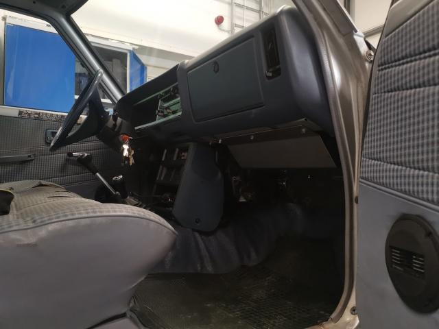

    The first modification was one of my favorite ones. I'm a music lover and I was missing something in the car.
    I wanted to be able to play music from my phone through Bluetooth, but I didn't want a modern car stereo protruding out of the dashboard.
    The solution? Take out the old cassette deck, modify its internals to house a Bluetooth amplifier and power the speakers from that.
    I had a thin, small amplifier laying around that fit perfect in the cassette tray. It had 2x8W of power and was more than enough for the small speakers and cabin.
    25.01.2020
    I wired up the on/off switch of the cassette deck to the amplifier so I could turn it on and off.
    Changed out the old 90's Pioneer speakers with JBL STAGE2 two-way speakers, but I kept the old Pioneer grille.
    Had to modify them a bit to fit the tweeter, but they looked retro, and sounded amazing.
    30.01.20
    Pretty happy with the result, as I tried to keep the old, worn retro style, but featuring great sound quality.
    The Philips cassette deck and Pioneer speakers weren't original to the car, I believe it originally had just a mono center speaker in the dashboard, and a simple radio with no cassette deck.
    Here's what the dashboard looks like:

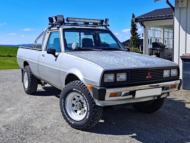

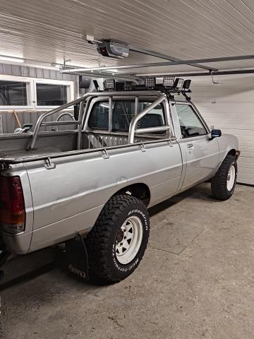

    Winters in Norway are pretty dark and depressing, and even though the truck has four H4 bulbs, I wanted more light.
    Went online and got a 32" LED-bar, I didn't want to ruin the look of the front of the vehicle, so my plan was to mount it on the roof.
    In addition I went to Biltema (scandinavian hardware store) and got eight 24W LED work lights and a couple of generic roof rack kits.
    06.02.20
    Made the two roof racks into a rectangle rack housing all the lights. Wired the work lights up in zones: front, left, right and rear.
    I also wanted to be able to easily remove the rack in case I needed to haul something that needed the roof space, so I wired up two waterproof plugs.
    06.02.20
    08.02.20
    Light's up on the roof, now the only thing left is to have a way to control them.
    The center console had a blank metal plate, not sure what it was for, but it was the perfect place for buttons.
    However I did not want to ruin the metal plate by drilling 19mm holes in it, so I took a measurement of the original plate, designed a copy in 3D and printed it in black ABS.
    08.01.20
    I used calipers for fine measurement, but this is the only image I have of the original metal blank plate.
    18.04.20
    Printed with a powder coated bed (Prusa i3 MK3) so it has this rough texture, hiding the lines from the print.
    Came out perfect! The four buttons on the left control the work lights in each direction, and the bottom right activates the LED bar control which turns on the LED bar when high beams are on. The top right button adds in the front work lights in the LED bar control, so I have "ditch lights" in addition to the LED bar. These are handy when driving in overgrown roads in the forest.
    09.07.20
    Final look, each button has its own light to signal activation. Here the front work LEDs are on. Mint!
    I didn't get the buttons until april, so I had to wait a while to finish the project. They were ordered on Aliexpress.

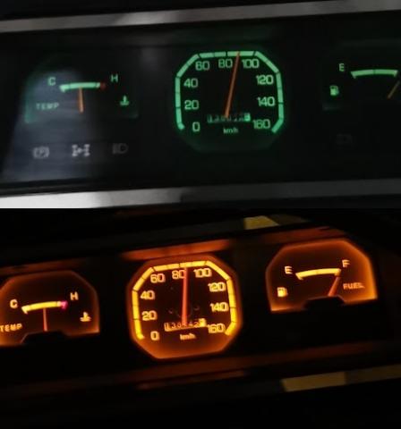

    Also, I changed out the bulbs in the speedometer which was actually original Toshiba bulbs (!) with a green filter cap on them, to orange LEDs. I like the orange look better as it is my favorite light color. I kept the original bulbs, still amazes me that they worked 34 years later.
    18.02.20

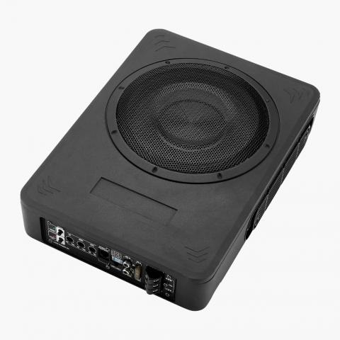

    I was missing some low-end with just the 4" door speakers, but space was limited for a regular subwoofer without sacrificing passenger space.
    Thought of getting a slim subwoofer and placing it beneath the seat, but there wasn't enough space. Space behind the seat is filled with necessary tools, air compressor, fluids etc.
    The solution was to mount the subwoofer up underneath the glove box. I made a plate in stainless steel, attached the subwoofer to the plate on rubber stands, and the plate to the dashboard with rubber gaskets to eliminate vibration. The reason I used stainless steel is I got my hands on some scrap from my workplace where we use 316L stainless.
    01.08.20
    01.08.20
    Plenty of leg-space left, and the subwoofer is mounted securely.
    The subwoofer I got was a generic 150W 8" slim sub with passive radiators for about $120. Pretty happy with it, and it sounds amazing. Jaws drop when people hear what it sounds like as they don't expect much from this type of car.

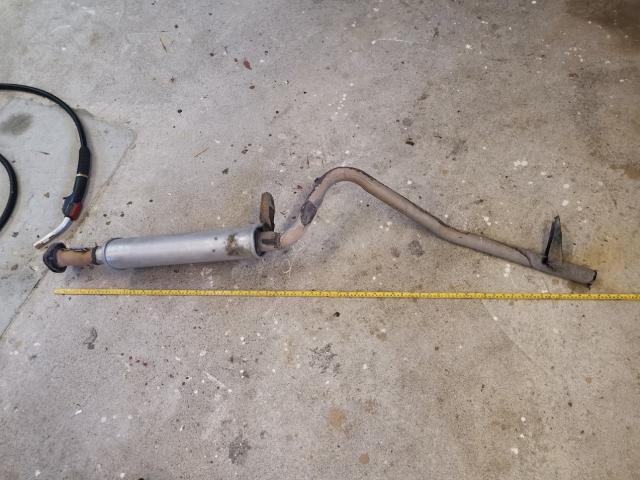

    After a year of little to no issues or mods, the rear exhaust rusted off.
    23.08.21
    Made a new one with custom bends and pipes, and reused the fasteners.
    25.08.21
    That's about it. Welds could be better, but it's still holding together with no leaks a couple of years later.

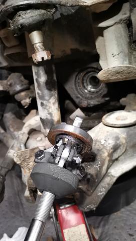

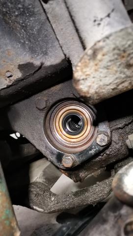

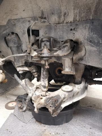

    Noticed an oil leak wherever the car was parked, and localized it to be coming from the front differential.
    Specifically the left axle seal.
    Ordered a new original seal and started disassembling.
    15.02.23
    17.02.23
    The seal looked okay, but I'm sure it was due to be replaced.
    Getting the new one in was a pain, it kept turning to each side and I ended up having to carefully line it up and do a proper, hard sledge hit to force it straight in at once. I used a plastic cap to distribute the force evenly.
    21.02.23
    Replaced upper and lower ball joint and inner and outer tie rod while I was at it.

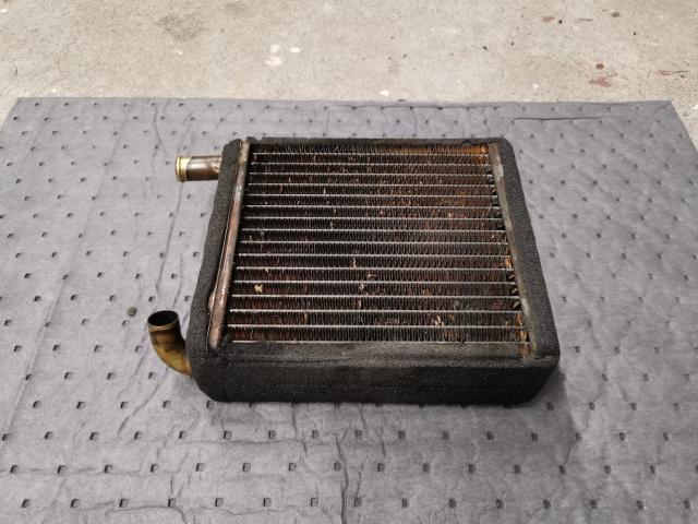

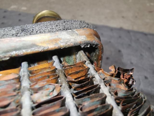

    Windshield started fogging up, I started smelling coolant and I noticed there was a puddle on the floor.
    Heater core started leaking. Great.
    The good thing about this is that it's quite easy to remove. Undo four screws on the center console, disconnect some steel wires, couple of hoses and undo four bolts on the heater core assembly. That's it, took me about 20 minutes the first time.
    22.03.23
    22.03.23
    Getting a new heater core part, however... Such a pain. Even used ones weren't available here in Norway.
    Tried our Craigslist equivalent, eBay, scrapyards, contacted my local Mitsubishi dealer, even tried to order from some american site that only allowed to sell and ship within the US, but with a shipping service as the receiver. They responded that they didn't have it in stock after all.
    So the solution was to contact a Norwegian company making custom radiators, I sent them my heater core so they could take measurements, and they sent me a new one. Cost me around $400 including shipping.

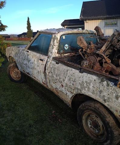

    Yesterday I brought home an '82 L200 that has been sitting outside for 20 years.
    These first gen L200s are so rare here in Norway that I just had to take the chance, and see if I can rescue any parts from this one.
    11.10.24
    When I first saw it, I thought "what have I gotten into" as it was burrowed in dirt, leaves and looked in really bad shape.
    It was also a 1982 model, which is somewhat different than mine. Headlights, grille, instrument cluster, steering wheel with stalks and seats looked a little different. Engine was a 4G63, same as the one sitting in mine, but with minor revision changes to some parts.
    This one is a DL022G while mine is a DL026G (VIN)
    12.10.24

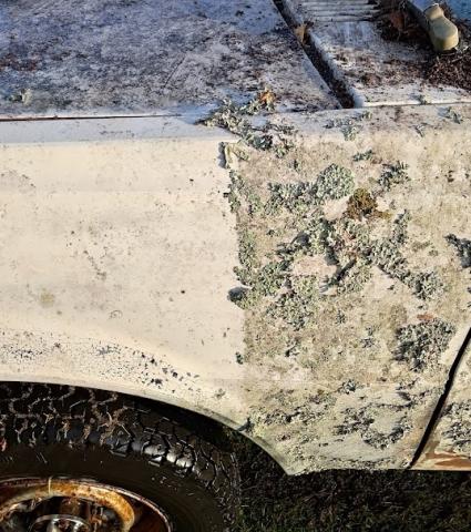

    It had a really nice patina once I got it home and removed the dirt and leaves. However, it had seen better days.
    The truck bed, floor and parts of the doors were rusted out, but the interior and engine looked to be in good shape.
    It came with a 4G63 and a gearbox from an L300 sitting in the truck bed. This one is slightly different to the L200, with the alternator on the other side and an upgraded carburetor.
    12.10.24
    Pressure washed it to remove the 20 years of growth on it, made it a bit easier to see what chassis parts are saveable or not.
    Shame to remove this patina though, part of me wanted to get it rolling and drive it as-is, but that's not going to happen as I cannot get it registered.
    12.10.24
    Found the original grille laying in the truck bed.
    Going to sell the parts that don't fit mine, save those worth saving, and scrap the rest.
    My main goal for the next week is to get the engine running and check the health of it, then part the car out completely.

    Quote Originally Posted by 1600cc View Post
    Great to see someone working hard to preserve these little old trucks. Heater core replacement sourcing is a nightmare, as you've discovered. I've got one good heater core out of 3 trucks
    Thanks for the encouraging words! Indeed, it was quite the job to find a replacement. Hopefully it will last me 30+ years, at least.
    It's getting harder to find parts for these 1st gen. trucks, that's why I'm constantly on the hunt for parts vehicles to hoard up a storage.
    I plan to keep this running no matter what, for as long as I can.

    03.05.25
    I test fit an aluminium roll-bar that I bought a couple years ago, it was originally painted black and the paint started to chip.
    I was going to display the car at a cars & coffee meet today (04.05) and decided last night to sand down the roller bar and glue it on temporary to see how it looked. Used about four hours of sanding, the worst part was the corners and welds.
    04.05.25

    Noticed a clacking noise from the front left, discovered that the lower shock absorber bushing was shot.
    Tried finding new shocks, but I couldn't find the original part number in my parts list.
    I found everything else for the suspension, except the shock absorber. Decided to check the parts for a 2nd gen, and they looked very similar. Part number: MB176291
    Ordered a couple of Sachs 290 639 (SOV30X126) in good faith, and lo and behold, they fit! Was a bit hard to get the lock nut on with new upper bushings, but other than that it went fine. Took me about 20 minutes for each one.
    05.08.25
    I was honestly surprised how much this meant for the ride comfort, it now rides smoothly over cracks and bumps in the road without shaking apart the whole interior.
    Definitely worth it, and I'm considering replacing the rear ones too.
    It's due for the bi-yearly road inspection on friday this week, fingers crossed!
