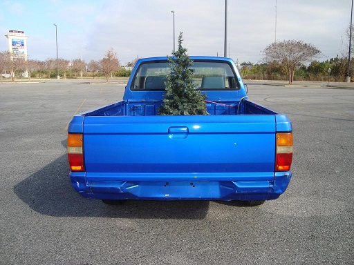

    This is a pic of another Mighty Max (1988) that I sold to a friend.
    I drove it back and forth from New York to Baton Rouge several times.

    ^^^ Oh, and yes... That is a Christmas tree complete with lights.
    I used a voltage inverter, extension chord and lights.
    I do it every year with several of my trux.
    This ^^^ is another pic of one of my S10s with a lit Christmas tree.
    People would flip out.

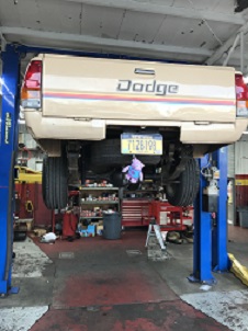

    I installed the header last Saturday and was going to take the truck to a muff shop to have a custom exhaust built...
    Well... Guess where I am?
    Yez, in the land of fruits and nuts - California.
    I called a shop named "Muffler Man" and described what I was hoping too have done.
    The tech immediately said that converters have skyrocketed in price and from what I described, it would cost a few clicks under $1000(??) He said a cat would cost about $675. I told him I would provide a Spin Tech muffy...
    I went to eBay, and found a 2.25" California certified cat is about $175...
    So, this ain't happening.
    I was considering going to Cardboard Freight and buying their high end TIG welder, but that would require shielding gas, rental of a tank -blah.
    So, I guess I'm going to have to use a cheap azzed flux MIG.
    The king of bird crap welds.
    I'm going to rent a car until I figure this out somehow.
    The truck is so loud - it gives me a headache.
    So much for improvements.

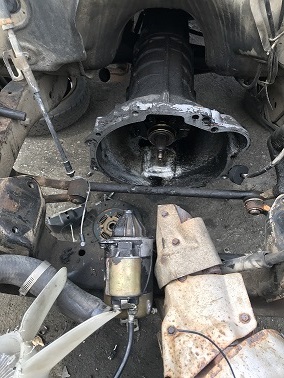

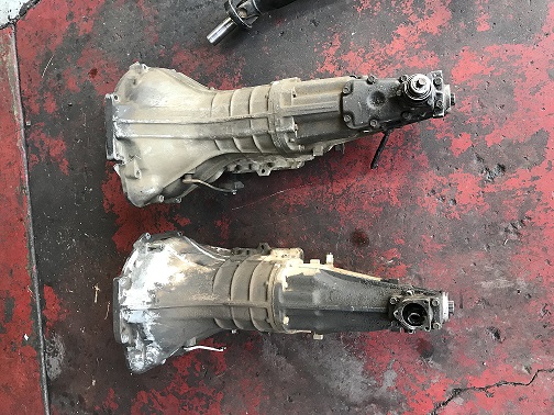

    I bought a KM 132 on eBay for $400 including shipping. It was advertised to fit a '79 - '80 2.6 or 2.0.
    Well, after pulling the 4 speed out... you KNOW the 5 speed didn't fit. It's for the wide block engines.
    Yeah, I was really happy about that.
    I am currently in Seattle, WA visiting my GF. I did a search at Pick n Pull and found 1 truck in a 250 mile radius from here.
    It's an '86 with a 2.0/5 speed.
    I went to the yard and the engine is already out, the transmission is hanging by the 2 mounting studs.
    I had decent clothes on so I couldn't get into the engine bay and measure the bell.
    I'm going back today and hope this is a NARROW block transmission.
    Truth will be told soon.

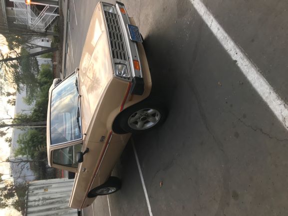

    Not sure how many pix I can post at one time.
    I figured out the pic issue. I have to resize them for the forum to be able to post.

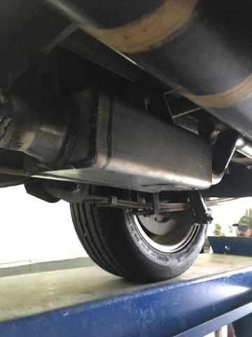

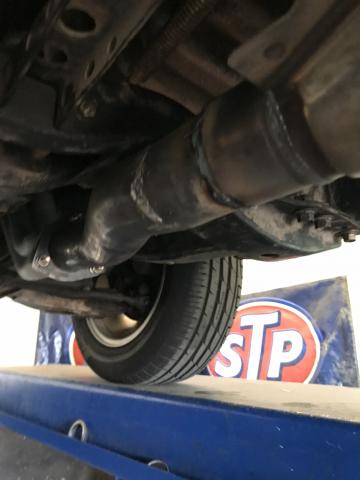

    I Bought a Cali certified cat and built the exhaust from the headers to the cat (2.5" pipe)
    I hung it all at the factory locations, so it looks and fits like it the factory installed it.
    I then took it to a muff shop and had them build a tailpipe (2.25") behind a Spin Tech muff.
    The truck is relatively quiet until you open the Weber. It howls at about 3000 RPM and continues to the red line.
    The power is totally incredible compared to the stock exhaust.
    I found the exhaust manifold was cracked, and the internal cat was also partially plugged.
    I also noticed that the 32/36 Weber runs super lean at higher RPMs now.
    Pollution? I bought a 38/38 Weber "Outlaw" carb. I'll be installing it soon.
    Needless to say, it is a completely different truck now.

    Went to the Pick-N-Pull in Arlington, WA.
    The transmission dropped out in 20 minutes.
    I found a duck with teeth!! (Some may call it a unicorn)
    It is the correct unit for a narrow block. I took a 13 month guarantee on it too.
    It's a nasty, grubby looking unit, but I am pretty sure all of the oil was from the engine.
    It even had a new clutch plate and TO bearing with it.
    Next: Total shine job, remove the bottom plate and clean everything inside, then install.
    Pix coming to a theater near you - soon.

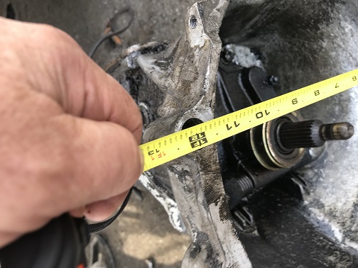

  24. #49
    12-21-2020
    197
    Baton Rouge, Louisiana
    4G52
    Correct dimension!
    Damn... SIDEWAYS!
    Still in the truck.
