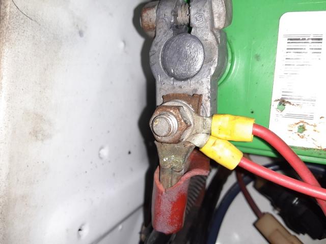

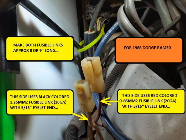

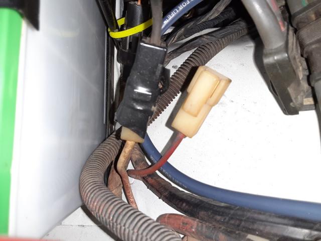

    MY 1986 DODGE POWER RAM50 TRUCK LOST ALL ELECTRICAL POWER ~ JIGGLED THE FUSIBLE LINK WIRES ON THE POS + BATT POST WHICH FIXED THE PROBLEM:
    1) Those small wires on my + battery post are not fusible links (THEY SHOULD BE) but they came from a junk yard truck ~

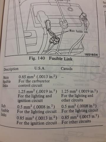

    2) 1986 FSM shows one 16ga & one 20ga fusible link feeding the truck's lighting/ignition & carburetor control wiring harnesses ~
    3) The 20ga fusible link can't be located premade on Google, but 18ga & 16ga fusible links are available premade ~

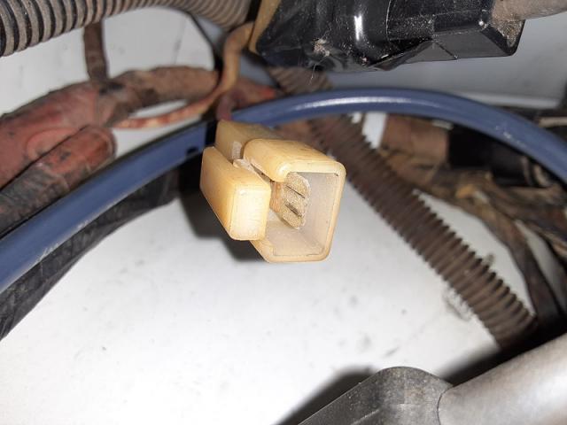

    4) Just ordered one 16ga & 18ga premade fusible links at O'Reilly's they come 5/16" eyelet & butt connector already crimped ~

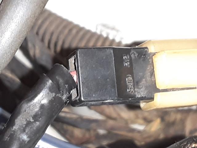

    5) Ma truck's wiring harness connectors don't have enuff wire coming from the connectors to crimp on the fusible links ~
    6) Gotta locate (SJD 32 CONNECTORS) C'mon Google & eBay please be nice in cyberspace ~
    I decided safe enuff with 18ga fusible link instead of being anal for 20ga ~
    Just sent email to http://www.globalsoftware-inc.com/co...ible_Links.htm asking to order 4 each female terminal FLFT7.9 which might fit the SJD 32 connector
    PHOTOS:

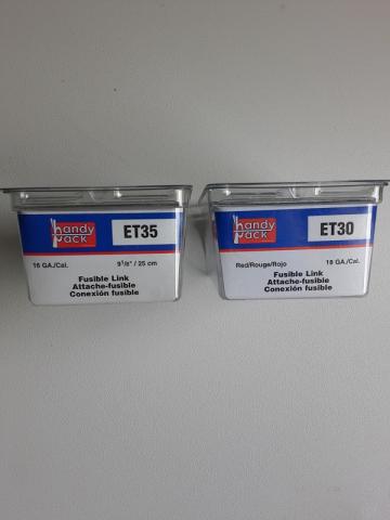

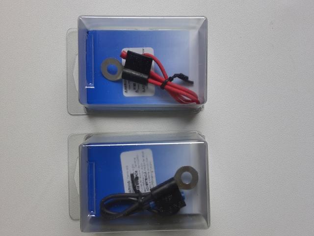

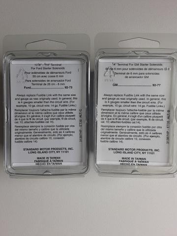

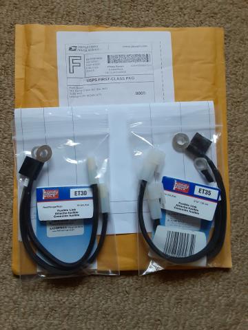

    Got these @ O'Reilly's today, gotta accumulate other connector & wire stuff for them to attach onto...
    one box says it's 1/4" eyelet & the other 5/16" but they look exactly the same to me 5/16" or bigger ~ at least the wire sizes look different ~ there is a 3rd fusible link under the hood for the alternator ~ will hunt for it someday ~ hope it's there & not just regular electric wire like what was coming off the battery...

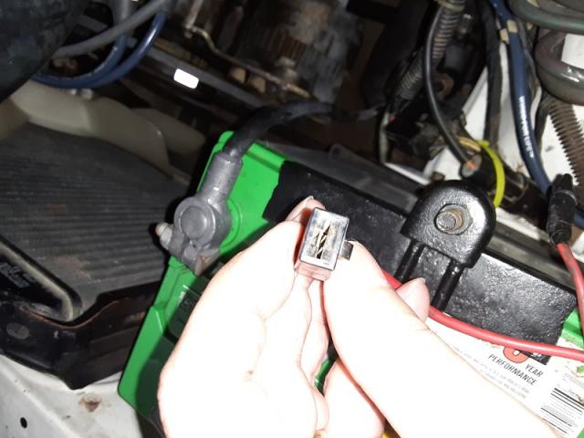

    Main fusible link

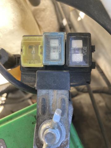

    Does anyone know what 3 fuses go into the small fuse block on the positive battery terminal? I’ve looked over the forums and was having trouble finding anything.thank you
    09-26-2014
    495
    Ca
    1993 Dodge Ram 50
    this is from My '93 4g, should be same same
    YELLOW for lighting,- 60A-
    BLUE for MPI control circuit -20A-
    BLACK for MAIN/ALT -80A-.
    the fuses are P.A.L. design , cable style ends
    03-31-2021
    22
    Philadelphia, PA
    1992 Mitsubishi Mighty Max
    Thank you greatly appreciated!

    Had to check notes before reply...
    SubG,
    Fuse links are easily replaced with more modern protection .
    The P.A.L. (pacific auto link) or JCASE (same style/bit longer) style 'fuses' will be just fine as they are really 'fuse Links' in a plastic enclosure.
    The design is 'slow-blow', essentially the same as a fuse link but without the insulation.No sizing magic is needed for replacement.
    I will use My Max as an example...
    There are 4 f/links on the Max each is .5mm² = 20 gauge in awg.
    @25°C max continuous load, 15amp is the rating needed for each link.
    So,
    'Fuse' holder of your choice & one to one sub circuit by circuit with
    P.A.L or JCASE design circuit protector with the amp rating of the original
    fuse link ,and done.

    https://www.oreillyauto.com/search?q=et30
    https://www.oreillyauto.com/search?q=et35
    It just so happens that the O'Reilly links are the proper Mitsubishi OEM wire color ~ Mark is gonna attach ends that fit the two white plastic connectors shown in the photo ~ heck, I am so confused now & just wished if these even need replacing again it would just be a fuse ~ I think you have a better set-up claych but I'm an old stubborn cuss + too scared in regard to electrical stuff and hard labor or thinking + I already got the ball rolling & paid for A.K.A. too late

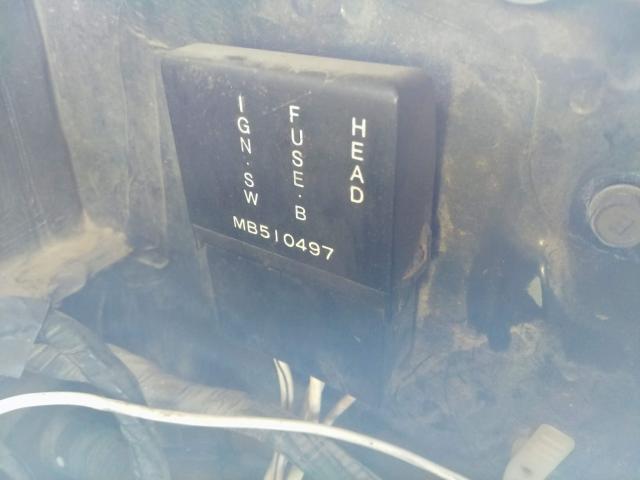

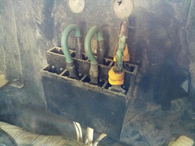

    Just to clarify, these are what I'm referring to, mounted underhood towards the rear of the (US) driver's side inner fender on my Gen2 '87:
    Notice how the Headlight one's already a homebrew replacement (courtesy of the PO) and getting pretty well-cooked by now.
    These link wires have female blade terminals, so I was hoping I could simply pull them and plug PAL fuses in their place, but now I'm guessing the "terraced" connections might not allow for that, even if the other dimensions were suitable for PAL fuses.
    In that case, I'd need to replace this entire box with suitable PAL fuse holders, no? Doesn't seem to be any such thing as a generic multi-slot PAL fuse box I could retrofit, so they'd prolly have to be individual fuse holders, unless I could find a used PAL fuse block like Claych showed above.

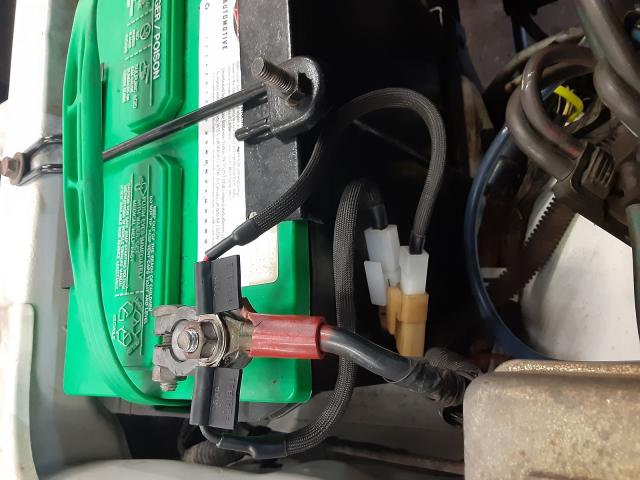

    HOORAH..!
    Received fusible links from Mark Baker @ http://www.globalsoftware-inc.com/co...gmainframe.htm
    He makes wiring for Toyota FJ40 vehicles but it just so happens the FJ40 uses the same fusible link wire & wiring harness connectors as our (mine anyway) trucks... I asked if he would crimp connectors onto the O'Reilly's fusible links and sent them to him, he did it no problem... Mark is a really swell guy, he even added heat sheathing to prevent sparks in the event a link wire gets fried... Not only that, he made an extra set in case they ever blow..!
    I am hoping others here might want/need a factory set of fusible links & if so, I highly recommend Mark Baker..! He is the BEST..!
    Mark as well as myself thusfar have been unable to locate spools of .85mm & 1.25mm sizes of fusible link wire that's why I bought the O'Reilly's 16ga & 18ga fusible links which are as close as possible to the same size .85mm & 1.25mm wires... Mark still has some stock of 1.25mm & .85mm wire which he used to make the extra set for me...
    PHOTOS

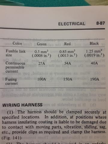

    Mitsubishi fusible links by color and size. Size shown is millimeters squared.
    Color and Wire Size
    Brown 0.3
    Green 0.5
    Red 0.85
    *Black 1.00 (diesel glow plug circuit)
    Black 1.25
    Fusible links are to be two wire sizes smaller than the wire they protect would would mean the following:
    A Brown fusible link is used to protect an 18ga wire.
    A Green fusible link is used to protect a 16ga wire.
    A Red fusible link is used to protect a 14ga wire.
    A Black fusible link is used to protect a 12ga wire.
    Mitsubishi uses these colors, others may NOT so you'll have to look at the wire size to be certain.
