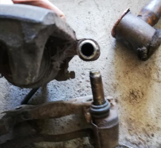

    1,222
    No the upper (small bolt) is holding the sleeve that the caliper slides on (the bushing is inside the caliper body), so you lubricate it still attached (i.e the piece the small bolt is holding doesnt move, it is the fixed part)
    The lower sleeve will push out of the caliper body and you lube between the removed sleeve and the body of the caliper
    1,222
    See pic here. You can see the small bolt is holding the post, the caliper slides up and down this post.
    The lower bolt that you have already removed holds a sleeve
    Shown on this pic.
    Push the sleeve out of the caliper body and lube the outside of the sleeve
