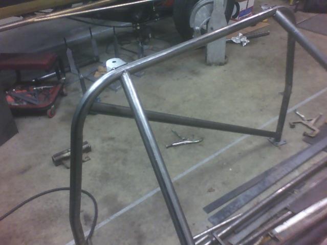

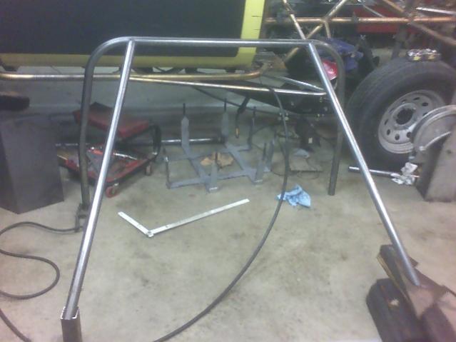

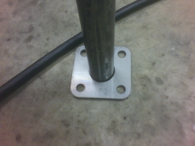

    Got it, 2 lights, no goal posts. 4 bends. You might want to grab a tape and check the mounting plate width. It will fit in the back of the first gen so we should be good to go. I always wanted to do this in the camo truck but never got around to it.
    Now it looks bad ass...

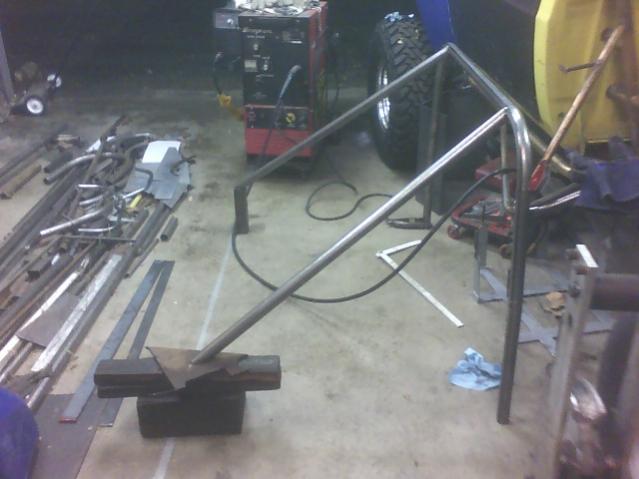

    She is all tacked up. Once you give the word I'll finish it off.
    ----EDIT----
    9" tall wheel wheel. top of rib to top of rib.
    35.5" tall from the top of bed rib to top of main hoop.
    55" outside to outside of hoop mounting plates.
    51.5" on center on the hoop.
    Down bars 51" On Center side to side.
    35" On Center front to rear.
    22.5 Deg inward angle on the top of the down bars..
    55" out side to outside of hoop mounting plates.
    31.75" light spacing On Center.
    If all is good then I will weld it up just as soon as you give me the OK.

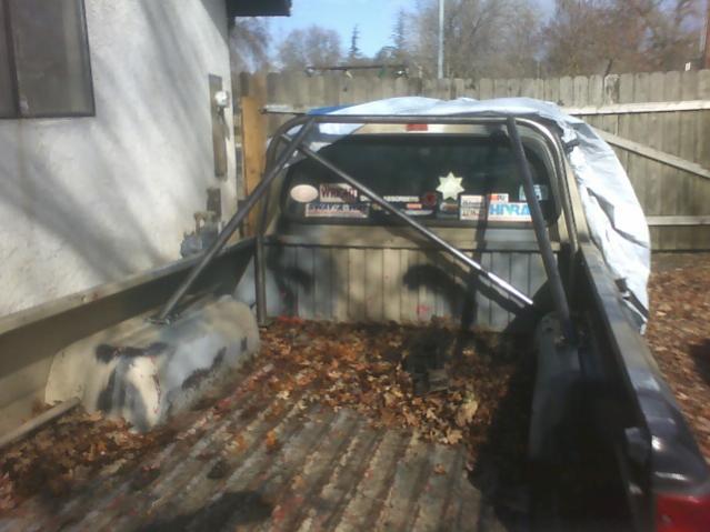

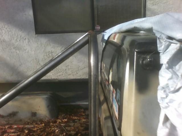

    Some minor adjustments need to be made. Other then that she looks good.
    Narrowing the outside to outside of the mounting plates to 55"

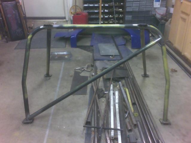

    Ready to go.
    Powerram, whats the inside measurement of your bed. I have 53.50" it fits, but it's a snug fit to the inside of the bed, on the first set of bends. If you have the bed liner it should still fit. We might just need to push it in.
    I made some adjustments to the fit it's at 53.25 at the lower bends. I gave it a rat coating of anti-rust paint on the bars. Ready for the final welding. Let me know if all measurements are good or if there is any adjustments that need to be made.
