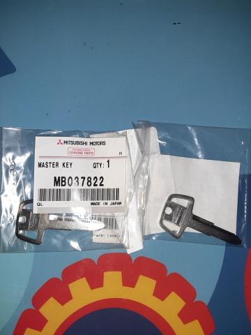

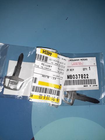

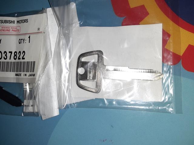

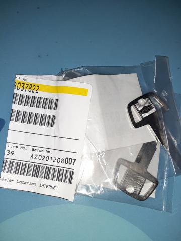

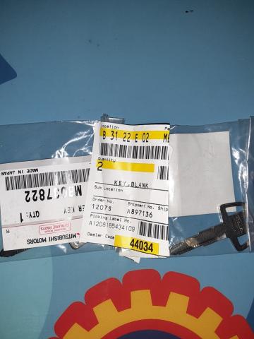

    New Key Source ~ MITSUBISHIPARTSCENTRAL ~ key blanks are still available $6.20 each ~ Hawaii local Dodge & Mitsubishi dealership parts departments both told me NO LONGER AVAILABLE
