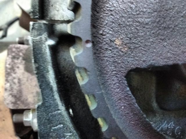

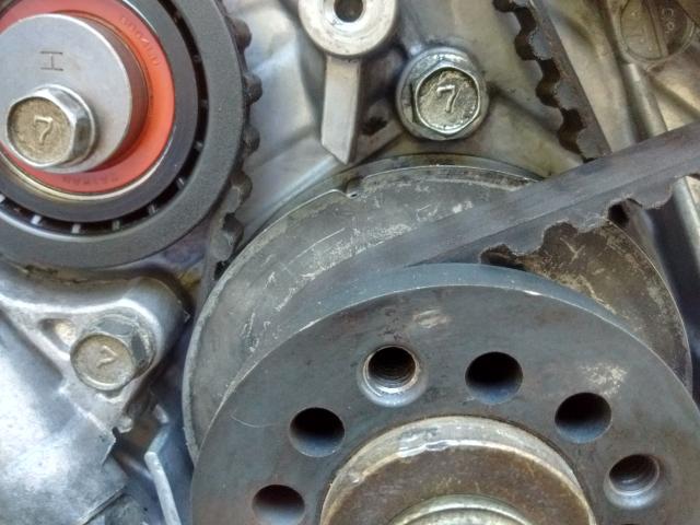

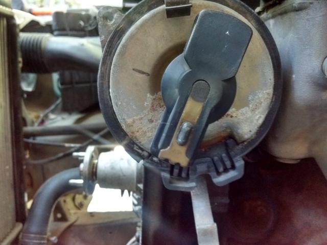

    can you post a picture of your engine bay? if the ecm checks out fine than its most likely the maf sensor. your o2 and coolant sensors can be bad and it will still run fine. ive tested with my truck, actually makes more power. i recently replaced my reman maf after it failed with a generic ebay maf and im pretty impressed to say the least.

    also, are your timing marks lined up as shown in these picks?
    ill upload a pick of my plug wiring also in a little bit.
    Thanks for the photos, yes my marks were all aligned and I managed to get the timing set yesterday, just have other issues to button up in the engine bay
