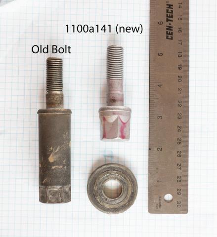

    Hi All,
    Can anybody verify if this crankshaft pulley bolt is correct for a 1992 MM V6? The old bolt and the new bolt a very different. The old bolt isn't even something I can cross reference, and probably something the PO installed:
    The new bolt part number is 1100a141
    I've got a feeling the 'old' bolt is definitely genuine. Mitsubishi put monstrous crank pulley bolts on their truck engines. The ones on the 2.0 look identical...

    Damn, that thing is a monster, definitely overkill. About the new bolt, can anyone confirm if that one is for the V6?
    B-line posted on your other thread that this is the new version of the OEM bolt as the originals were known to snap off in the crank.

    It appears my new bolt is wrong. I read on some other forums, the right part number is 1101A022. Ill got to the stealership and see if they have it.
