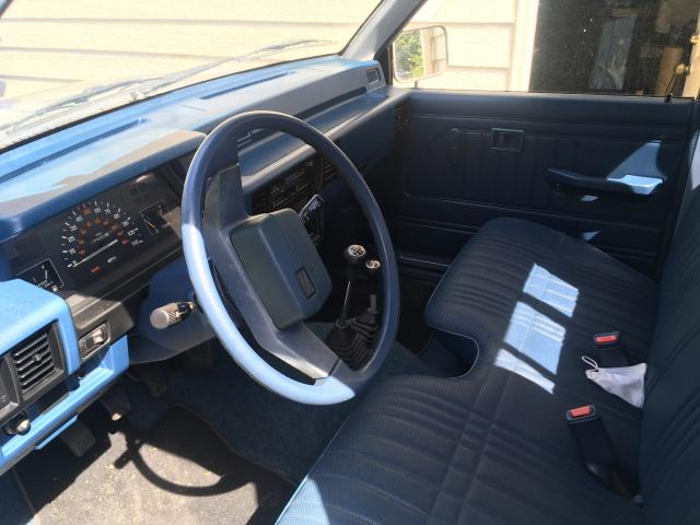

    Hey, I am an old guy pushing 70 and just bought an 1987 Ram 50 4x4 for around town to pick up whatever. I refused to pay the prices of a used Taco so ran a wanted to buy add on Craig’s list. Bingo I found a 1987 two keys and a heater 4x4 literally from a little old (well older than me) lady with 99k miles. The interior is like brand new and it runs great.
    It is my project and I am joining this forum to educate myself by others successes and failures.

    I spy with my little eyes... A MINT INSIDE!!! Wow this thing was very well kept, the first order of business is junking that old mikuni. I'm a firm believer in Weber carbs. Keep the engine cool, keep the engine cool, oh, did I forget? Keep it cool. Any kind of overheating send the heads and gaskets to the scrap bin. Very sensitive engines, otherwise super reliable. The 5 speed is a blast to drive, 4WD in mud is super. It'll be plenty enough of a truck to put around in.

    Welcome to the club. Might I add your 4x4 is in really good shape. Better than most. Stick around, there is a lot of information here as well as some great upgrades.
