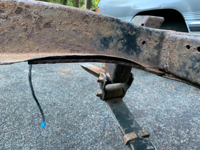

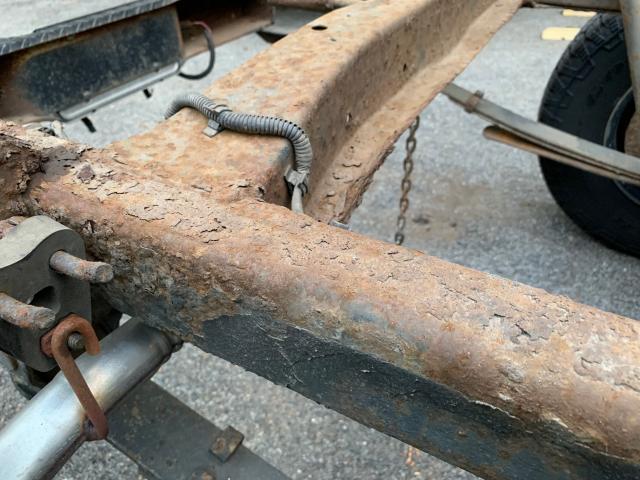

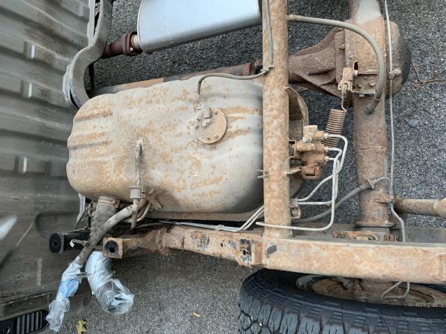

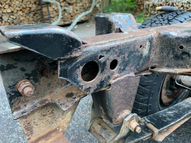

    Finally got around to removing the bed to get a good look at the condition of the frame, and everything else down there.
    The good news is that whatever undercoating got applied years ago (maybe at the dealer?) has done a good job for 30+ years, the bad news is that the areas that the undercoating did not cover, basically anything on the top side of the frame and out of view from below paid the price.

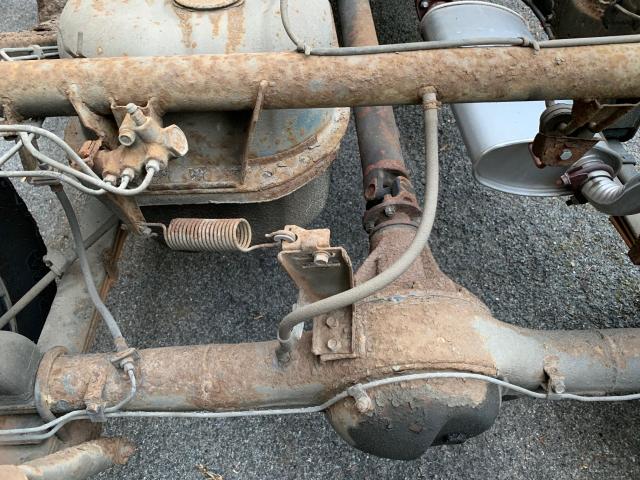

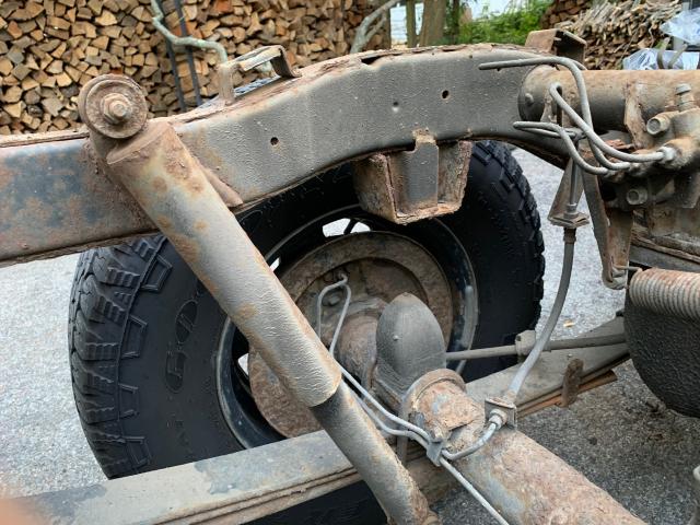

    You can see on the second picture the line where the undercoating ended, and all the rust above it. Overall not too bad, but there are some gnarly parts that need some serious attention. There's a few spot where the metal is flaking, that can't be good.
    This is my plan, would like to hear if you all think it makes sense or if I should consider other options:
    1. Hit the rusted up areas with a wire brush attachment on a drill until I get most of it out
    2. Use some kind of rust reformer to stop the corrosion from getting worse
    3. Cover the frame and other metal parts with a fresh coat of undercoating
    4. Probably do a fuel filter delete since on my specific configuration (2 gen, short bed, single cab, carburated) the filter is almost impossible to reach otherwise, and I have another filter on the line inside the engine compartment
    5. Maybe do a rear differential fluid change (it looks like it's leaking) since it easy to reach now
    Some questions for you:
    1. Am I missing anything? Should I be doing something else while I got the bed off?
    2. What is the best product to use to stop the rust? Would rustoleum suffice, or do I need something stronger, especially on the flaky parts, like rust-mort? Something else?
    3. Do you all see any areas of real concern in these photos? Anything that I should have a welder address?
    Thanks, and sorry for so many photos

    I'd use something more powerful than a drill to wire brush it. I'm think 4" grinder. Also use a strong scraper to get the flaky pieces the wire wheel misses out. Any rust left behind and not reformed will grow again.
    Edit- The rust reformer I used when I rebuilt the inside of my bed to Raptor coat it was Skyko Ospho. $20 gallon. It does real well on horizontal surfaces on verticals you have to repeatedly coat it until everything that will convert to black oxide converts. You want to get all the loose stuff you can get off and that includes the stuff that isn't loose but is flaky if you go at it with a tool because it is like water but won't necessarily penetrate a bunch of flaky layers and only convert the top. If you can afford it I like Tortron's idea for having it sand blasted. Por 15 is very expensive but I have never heard a bad word about it. https://www.por15.com/

    Thanks for advice, everyone. Because of time, access, and budget constraints, media blasting was not an option so I used a grinder, steel brush and scraper.
    Overall it wasn't bad, looked worse than it was. Even the areas that looked pretty bad it was mostly surface flaking, no structural damage I think.
    I already did an oven cleaner pass to get rid of the grease before the rust converter, but I'll probably do some more cleaning tomorrow before I treat it.
    Most of the converter manufacturers say that it shouldn't be applied to bare metal or painted surfaces, only rust, as the necessary chemical reaction wont take place. Easy enough to skip the big areas of bare metal and paint, but I'm not so sure how to go about the gas tank. It's mostly paint, and bare metal (after the oven cleaner), with a thousand little rusted pockmarks. Any suggestions?

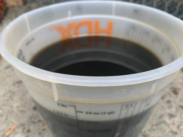

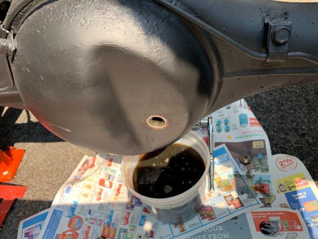

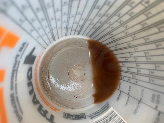

    Then I changed the rear differential oil. My driveway is not completely leveled (maybe 5 degrees off) so I raised the back just a little to compensate. The service manual says that the differential's oil capacity is 1.3 liters, so close to 44 ounces. What drained out was around 57 ounces, and what went in was around 59 oz (filled it up to the edge of the fill hole).
    It seems that it was overfilled to begin with (unless the manual is wrong), and that I managed to get an extra 2 oz over that when I refilled it. It's possible that I overcompensated when leveling the truck and the fill hole ended up higher than it should.
    Is this something to be concerned about? It seemed to be doing fine with an extra 13 oz over the recommended amount, but now I'm 15 over.
    One more thing to add, when draining the oil I lifted the driver side of the rear axle a bit, to get every little drop out of there from the drain hole on the passenger side of the differential. Is it possible that I got out more oil than would normally be extracted when doing an oil change and that's why I needed more to fill it up? That would explain the extra 2 oz, but not the other 13...
    i can get it to level surface and open up the fill hole to let out any excess, but I thinking it won't be much, maybe the 2 oz, bit not the full 15.

    I'm gonna plead ignorance here - but what does the hose from the top of the differential housing to the frame rail do? And is all of that soup you drained out oil? There is no physical way it could be overfilled through the fill plug on the rear cover that much. Either the PO used the 'breather' (?) hose as a fill point or it's contaminated from water and garbage through that hose. And I'm pretty sure the fuel filter in the engine bay is OEM.
    1,222
    looks like an extended diff breather. power rams are 4wd arent they
    bit of an odd place imo to let it breath to, but would keep the frame from rusting inside
    01-11-2019
    322
    Newburgh, NY
    Yes, that hose is the breather for the differential. That tube that it goes to on the frame is open on the sides.
    I don't think it had been filled through the breather hole, when I removed the fill plug the level was were it's supposed to be, just to the bottom of the fill hole. And It's possible that this was still the original oil, manual sasy to replace at 40k miles, when I got the truck it had 20k.
    Also, there's no water or any other obvious crap. Other than the color, it appears fairly clean (no residues or particles in it).
    I also filled it through the fill hole to the bottom of the hole (although the back is slightly raised to compensate for the driveway not being leveled), so I didn't think I was overfilling it. The reason I'm questioning it is because the service manual says the capacity is 44 oz and mine took close to 60 oz, that's a big difference. Maybe the information on the manual is off? Wondering if anyone had a similar experience.

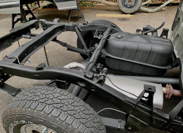

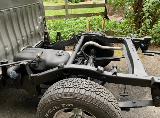

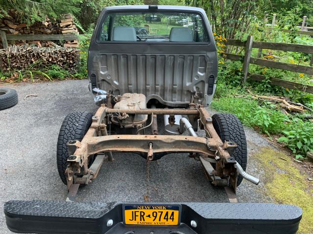

    I'm done with this project. It took a lot of work, but I was expecting that. All in all I'm pleased with it, I'm sure it's not a "lifetime warranty" type of job, but I think it probably added a few years to this trucks expected shelf life. I treated and repainted every inch of the rear portion of the frame (the front is next) and every element attached to it, I also did the underside of the bed. The bed goes back on tomorrow.
    I'll probably take the bed off again in a couple years to do some retouching as necessary.

    Looks fresh dude - worth the effort

    Dang..! You got the best seat..! WOW that undercarriage is looking new, awesome job..!
