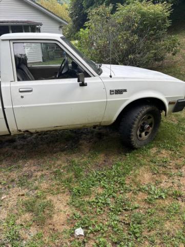

    So I know nothing about cars. Barely knew how to do an oil change. I grew up with one of these trucks and wanted teach my kids to drive a manual on the same truck I learned on. Enter my project truck, 1985 Power Ram I picked up this past week. It is going to take me far out of my comfort zone so I can actually learn how to work on cars and hopefully teach my kids not only how to drive but also not be as ignorant as I have been for all these years. Driving it home I had many many problems and the posts on this site have helped tremendously start to diagnose it. I have a long way to go but wanted to start this thread to post pics, update progress and have a place that I can come back and see how far it’s come too. Thanks in advance for the help y’all and I am open to any suggestions!
