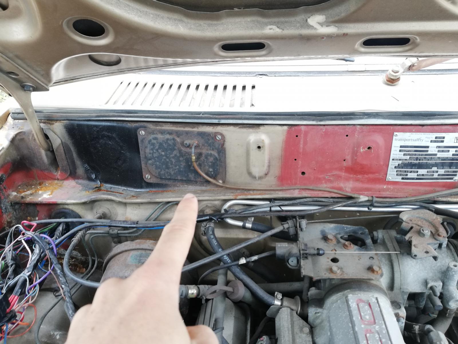

    Cowl is welded in on 1st gens

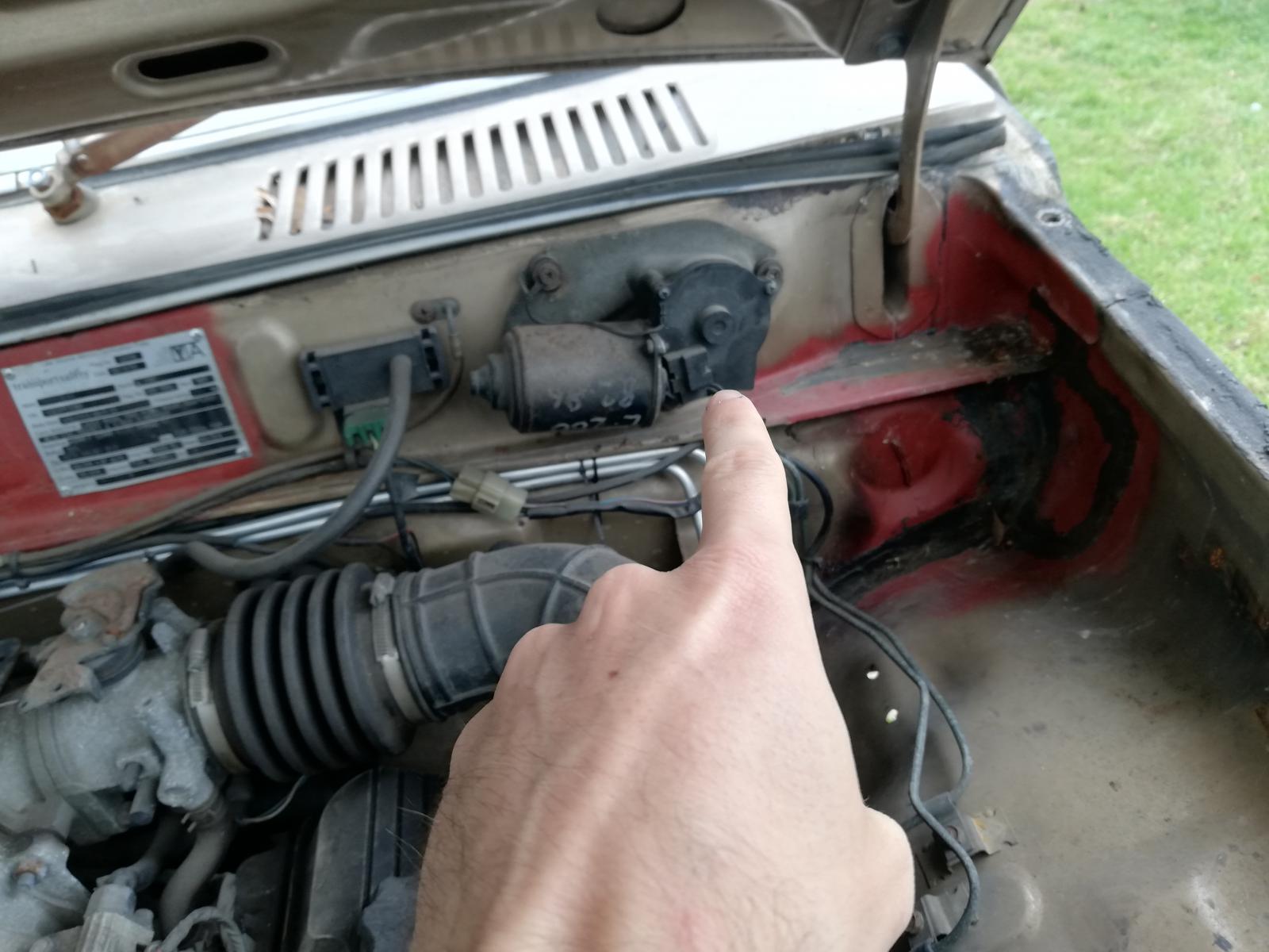

    Access via removing the wiper motor and the identical panel on the other side of the firewall in the engine bay.

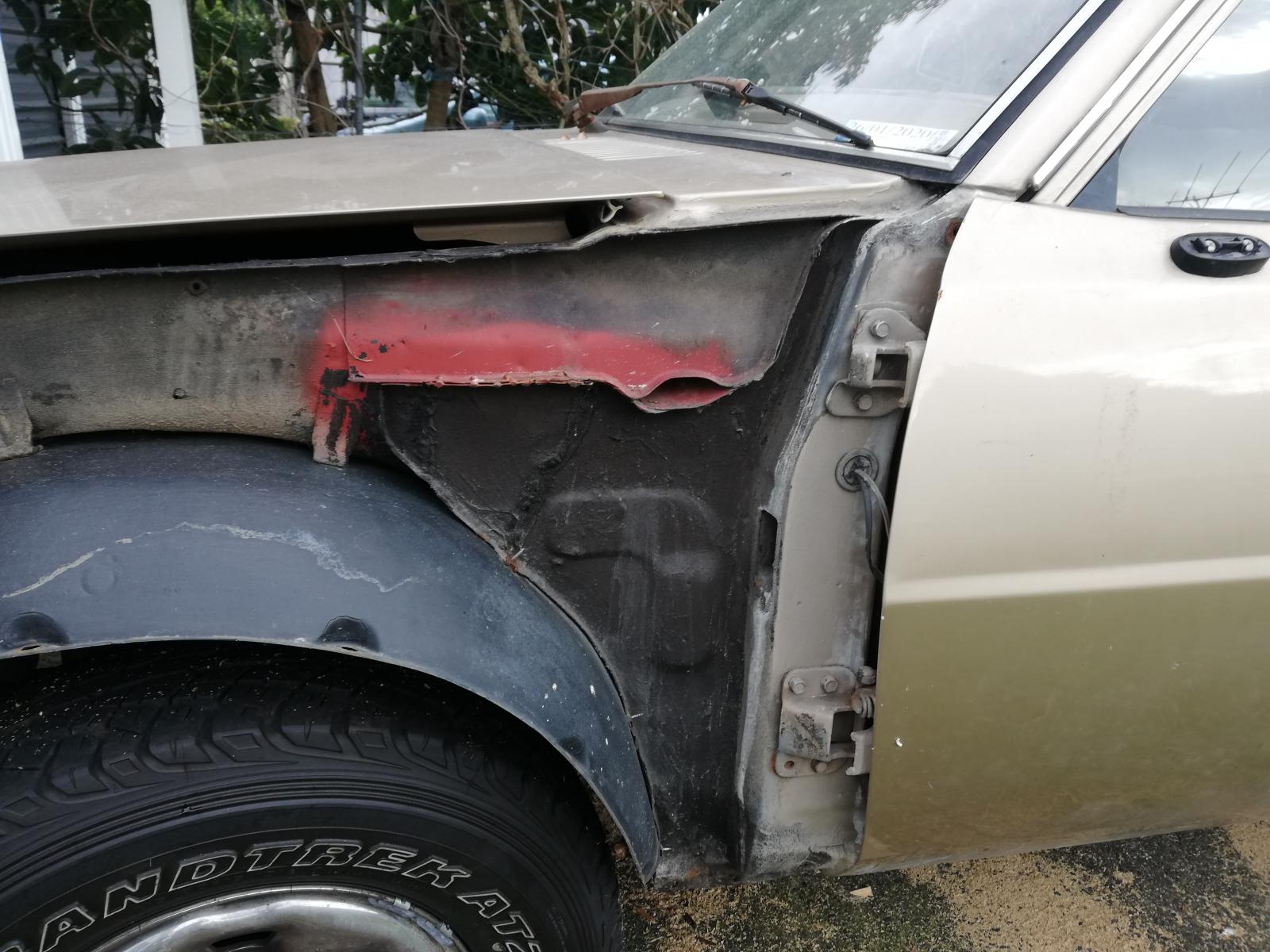

    They drain out behind the guards.

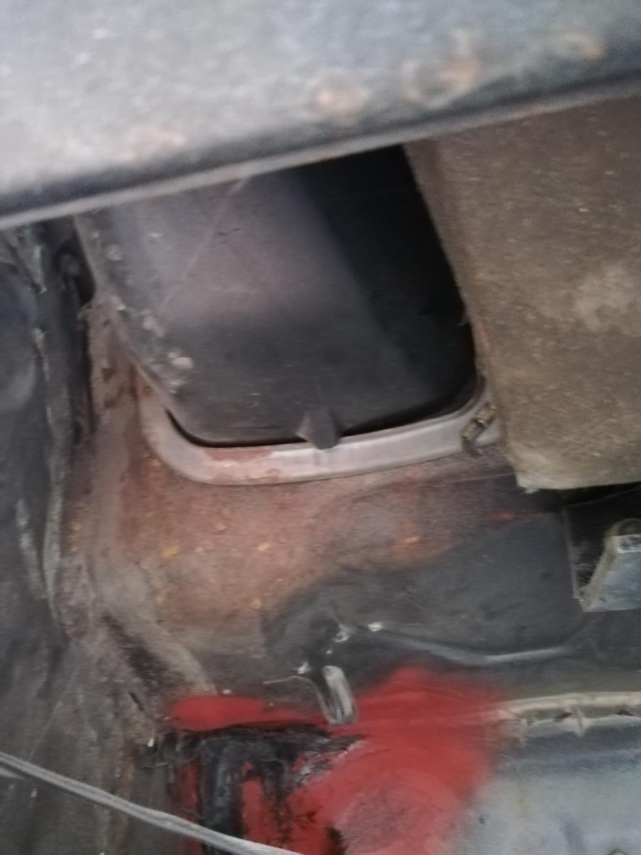

    Lesser access via the heater air intake in the middle of the dash or the vent air duct on either side. These have a rubber foam gasket under them which may be where your leak is
    There's a lip around the heater intake in the cowl. Designed to stop water running down into it. It's a prime spot for leaves to gather between it and the firewall and rust through. If that's the case there's probably some bubbles forming on the firewall as well, you have to cut it out and fix inside then weld it back.
    Basically every red spot on my photos is where your truck is likely to rust
