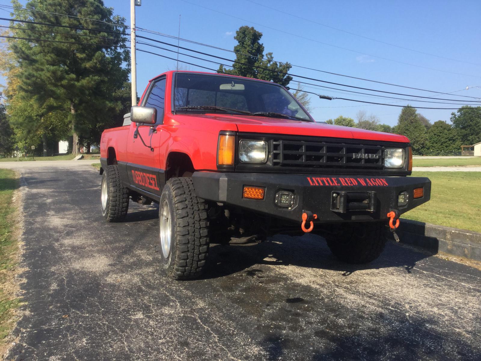

    Finally made enough headway on my truck to make it interesting, and thought I'd do a build thread to get some opinions on the way things are going. So here is my baby. A '91 Ram 50, 4x4, that we did a 4d55t swap on last year.

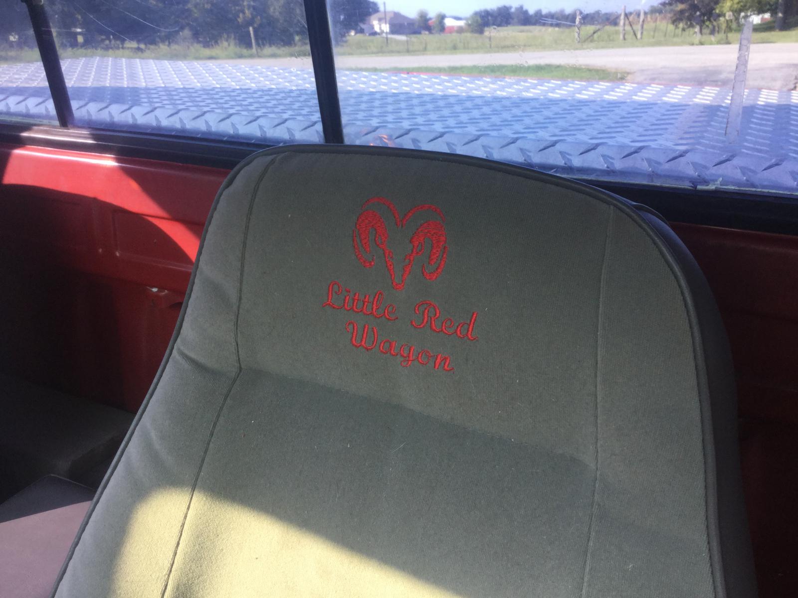

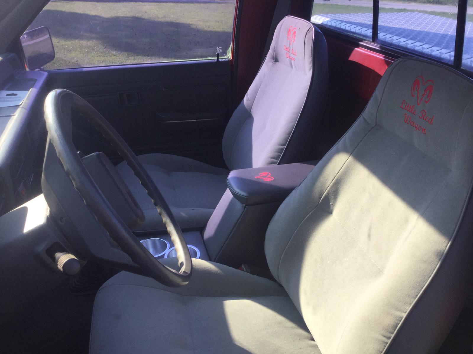

    On the interior we have replaced the factory bench seat with factory buckets that we reupholstered. I also made a center console after I gave up at finding a factory one. I've got a piece I'm working on to go up around the shifters and under the dash out of aluminum tread plate, but it's still in the works.

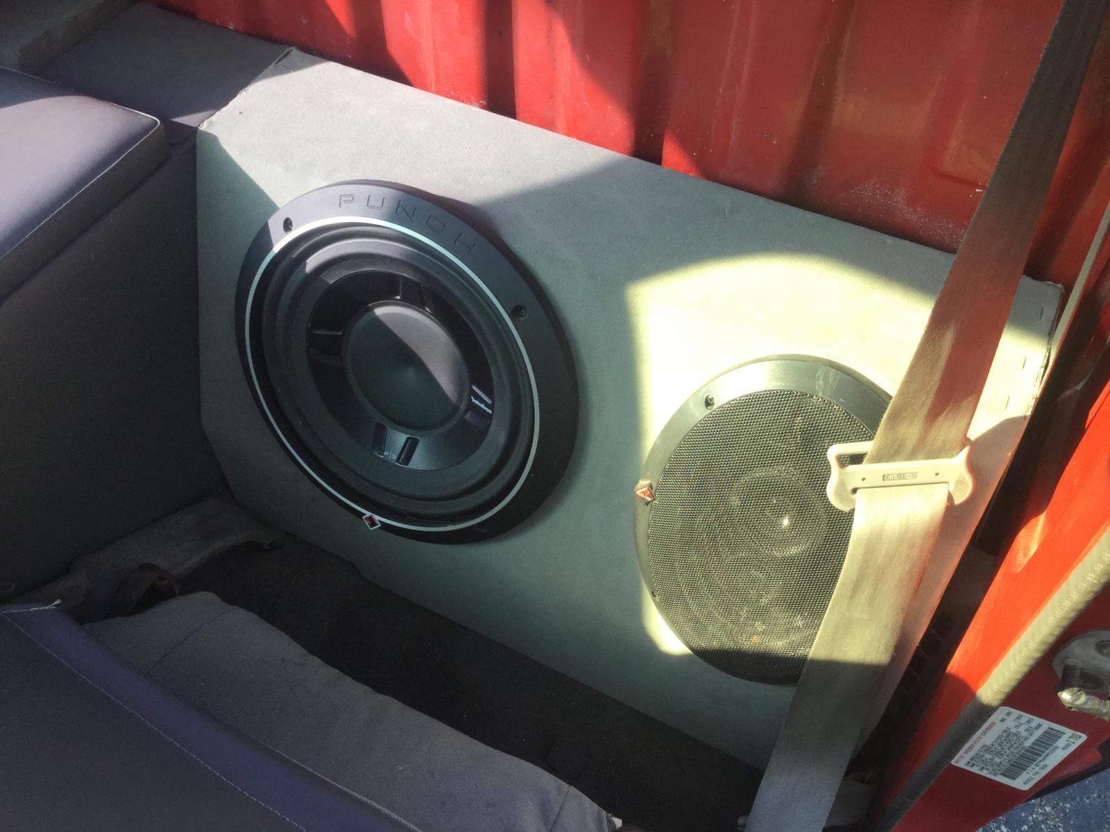

    I've had a little bit of fun with the stereo system. I'm running two 10 inch Rockford Fosgate Punch shallow-mount subs off of an old-school 400W Fosgate Punch amp. My dad and I built the boxes ourselves to fit over the transmission tunnel and line up with the center console we made. I'm also running two 6x9 Fosgate 3-way speakers in the back and two 4 inch circles up front in the dash off of an Alpine radio and a 180W Alpine amp. Suffice it to say the little truck's stereo sounds good.

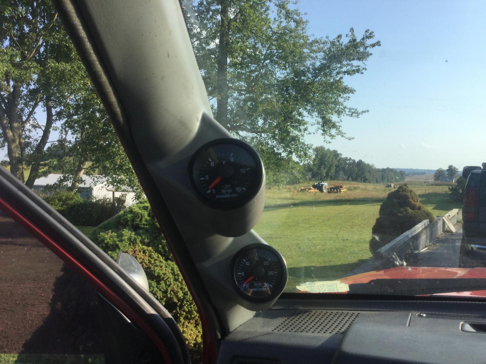

    With the diesel in it I wanted to have a little closer eye on whats going on with the engine, so I got ISSPRO Boost and EGT gauges that I mounted in a custom pillar gauge pod. We just took a universal 2-gauge pod and molded it in with bondo.

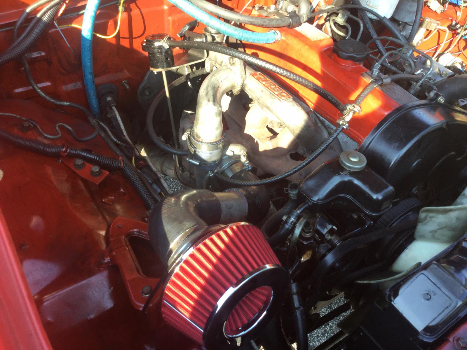

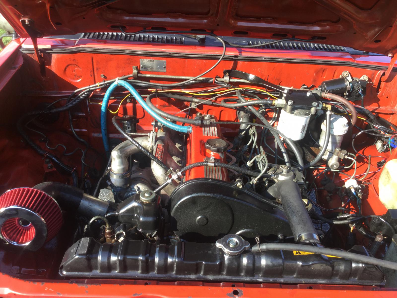

    As far as the engine goes it is a 4D55T out of an '84 Ram 50, we fully rebuilt it, new sleeves, pistons, and everything. The factory pump was bad, but we managed to get our hands on an '83 injection pump. Replaced the factory TD04-9B with a Kinugawa TDO4HL-15T, had to do a little fab work to get the wastegate actuator mounted up, but we got it all plumbed up right. At this point the engine is stock other than the turbo upgrade. We did get a bigger exhaust put on there, but its only a 2.5 inch. At some point I'll probably redo it with a 3 inch exhaust but for now this is working well.

    Geezer approves The seat retrim looks awesome. And good work on adapting the the A/C to the TD engine. This might be worth a write up by itself. Could do with some sound deadener in the cab (just an opinion) It will kill off the vibration in the cab panels and make it more bearable in the heat and cold (it'll improve sound quality too). Nice work all round.

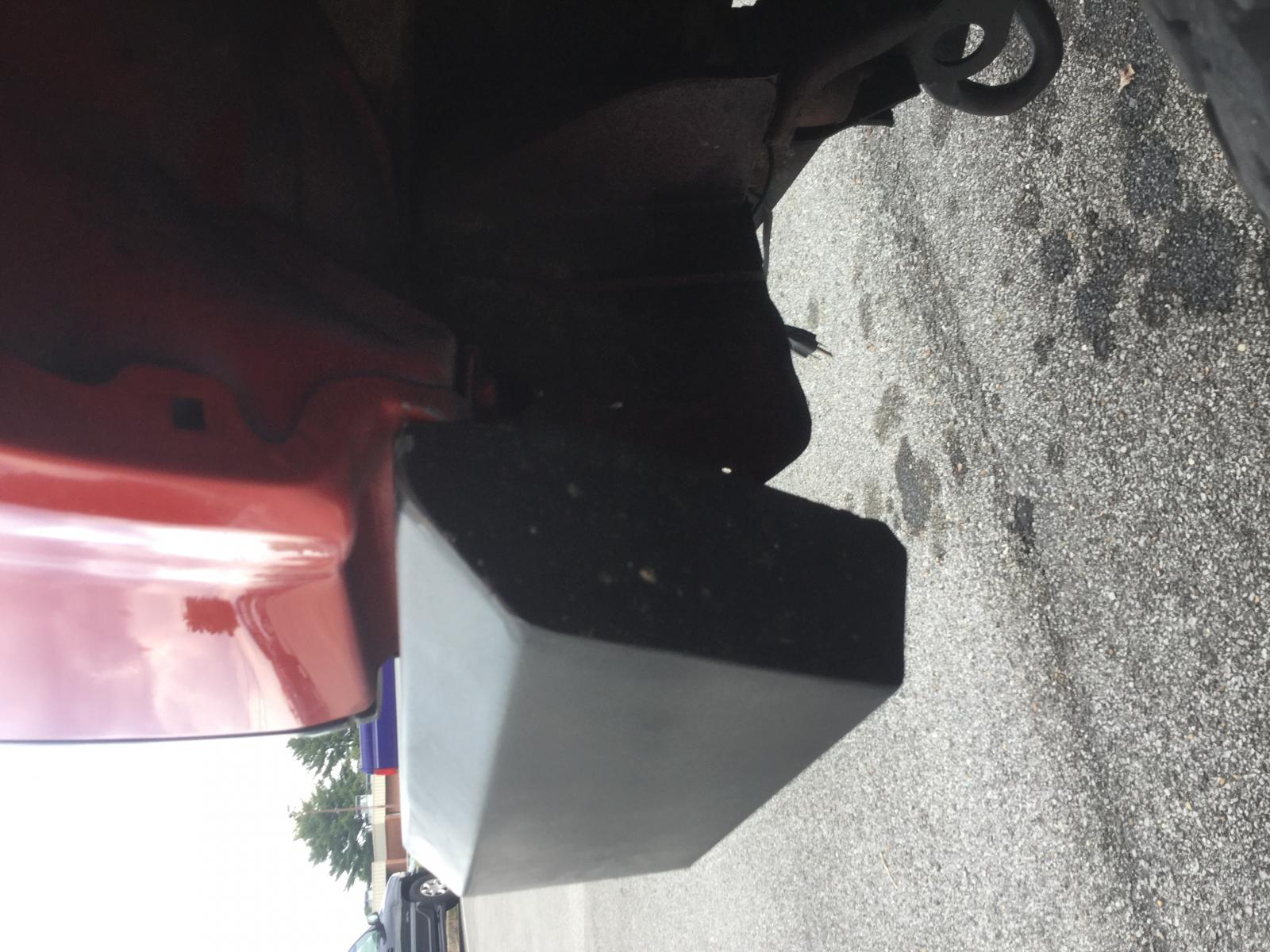

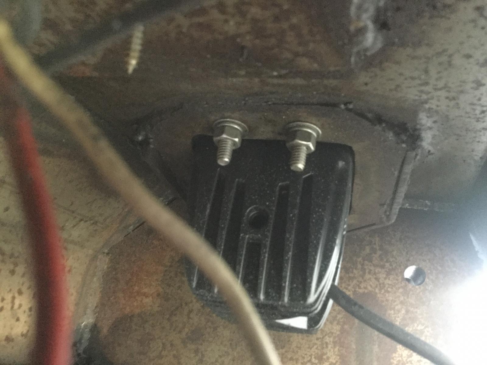

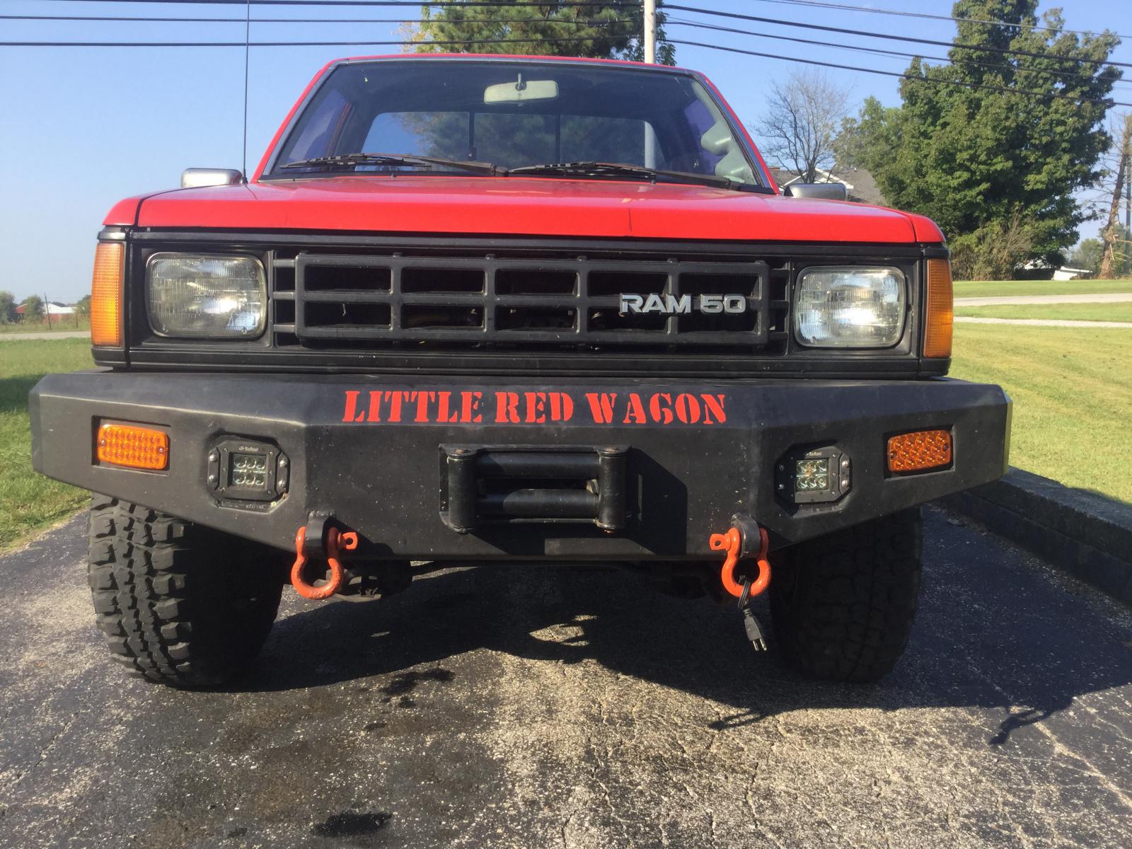

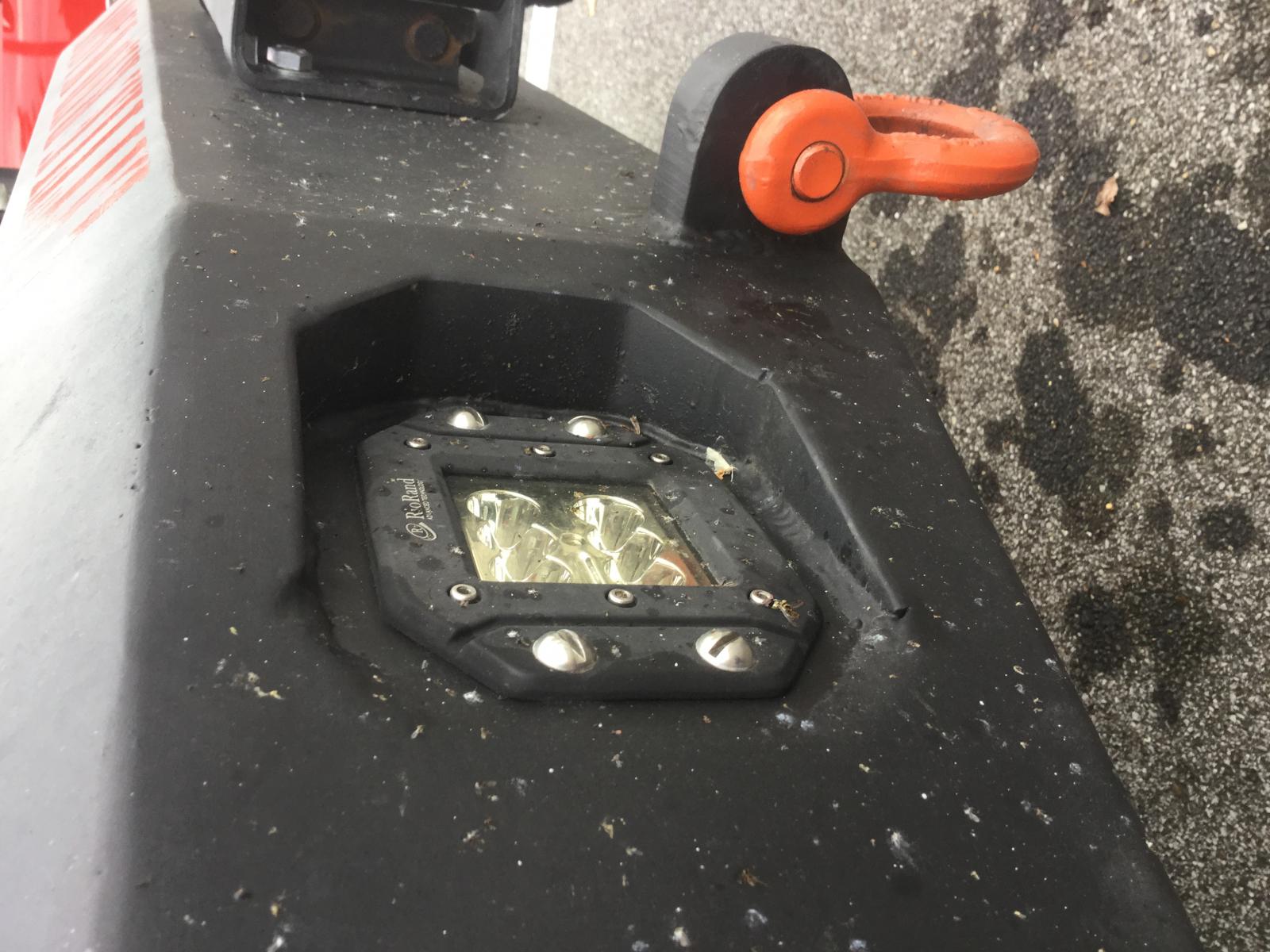

    Sorry for the delay, but here are those pictures of the bumper we cot out 2 plates(the first picture) that had the profile we wanted the bumper to have, and just took some 2 inch angle steel to make the bracket to mount it with. Then we took the steel plates to our local metal working shop to break it over to the angle to match. I had made a cardboard template of the bumper to get it where I wanted before we started welding stuff together, so I used that as a template to mark my cuts on the steel plates so we could get the sides and corner pars you see. The tow hooks are just held on by 2 pieces of 1x2 inch flat bar stock that runs the length of the 2 brackets to connect it as strong as we could to the mounting point. It would kinda suck to be hooked up to someone to be towed and they tear my tow hooks off. Then for the light pods I cut out a template that was the same shape as the lights, angled it to mark the bumper so we could position the lights facing straight ahead, and then cut it. We just cut-and-checked the pieces that go straight back until we were satisfied with the way it fit.

    That looks great. The mounts are more simple than I expected. I have a bad tendency to overthink things. Thanks for the photos. This gives me some ideas

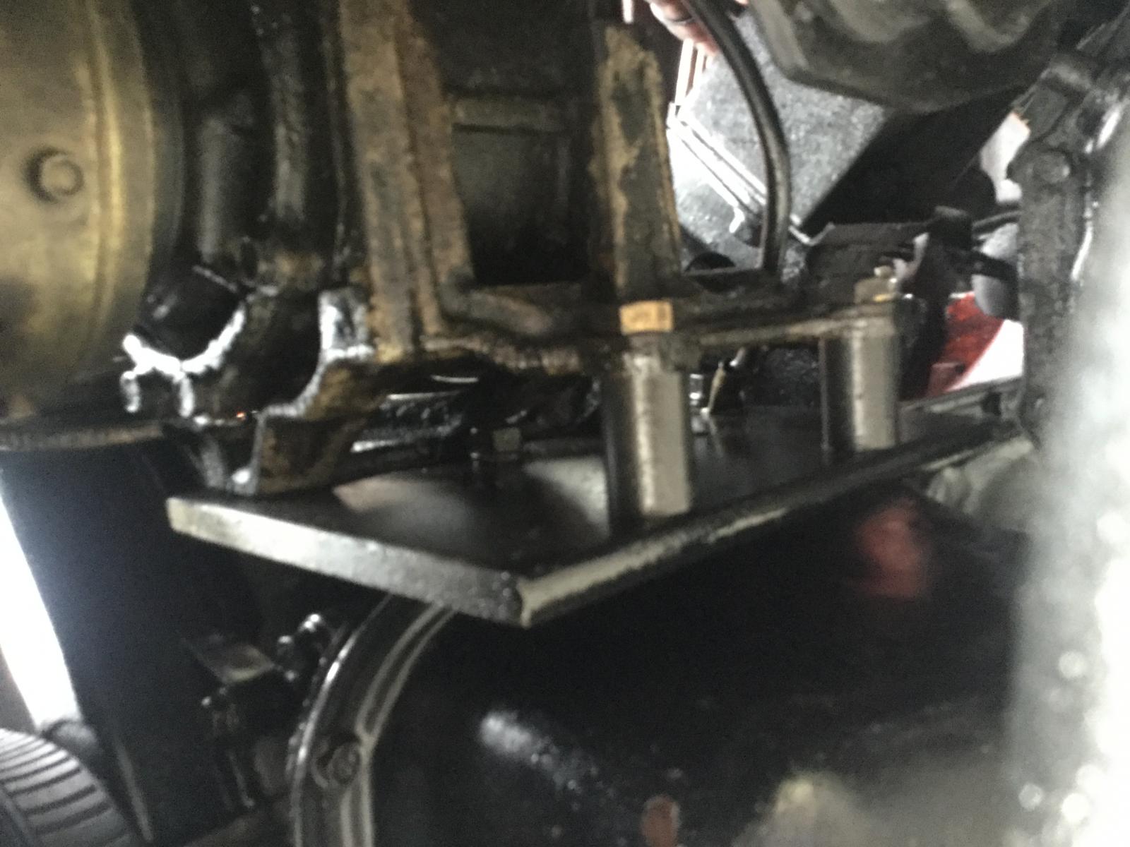

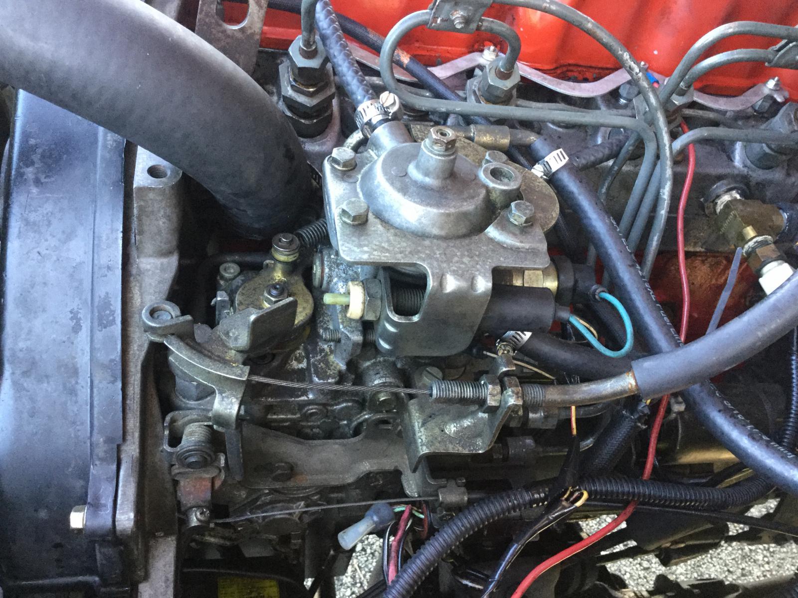

    Here is the adapter plate we made for the factory condenser bracket. It is really just a 3/8 inch plate that we cut and drilled to line up with the holes in the block. We milled off as much as we could from the factory bracket to get it as close as possible to the block, but even then we had to redo the AC lines on the condenser because they were hitting the steering box.

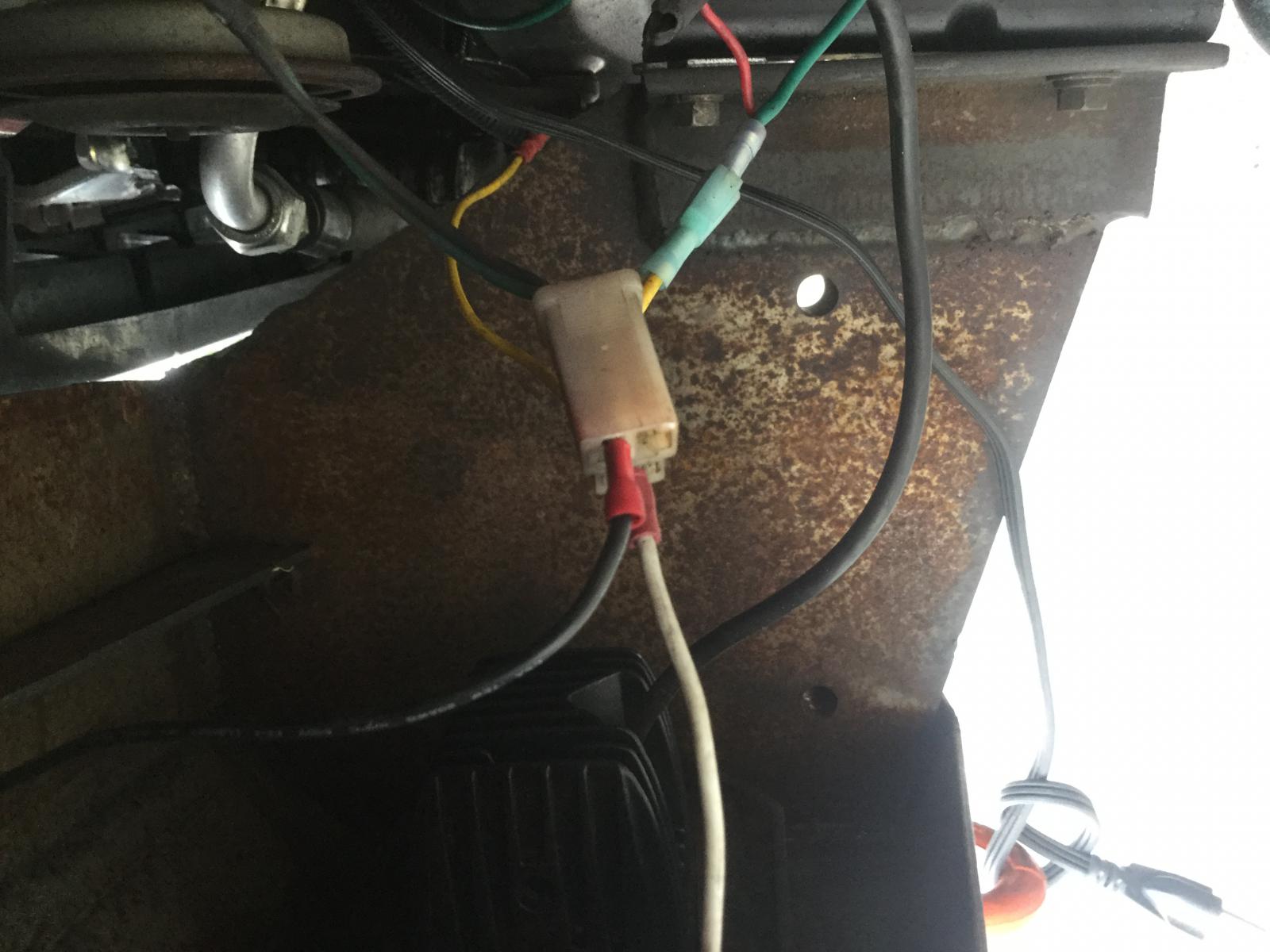

    Now a question:
    The little switch directly above the throttle cable, with the blue wire coming out of the back of it, what is it?
    Quote Originally Posted by dancinggecko View Post
    Now a question:
    I'm going to take an educated punt at this. It looks like it is only triggered on full or near full throttle so it might be a rev limiter. Either that or a solenoid to enrich fuel supply so it doesn't run lean. Diesel gurus will jump in on this one.
    06-12-2015
    185
    Owensboro, KY
    4D56-T
    I know it's not a rev limiter. If it is it is definitely not working, but I heard somewhere that the California spec pumps had a solenoid switch of some sort on the fuel return, I just don't know if that's what it is.
    If you're game - try bridging the circuit with the engine running and see what it does. If it's hanging off the engine and the throttle is meant to trigger it, there shouldn't be a risk of doing any damage to it.
