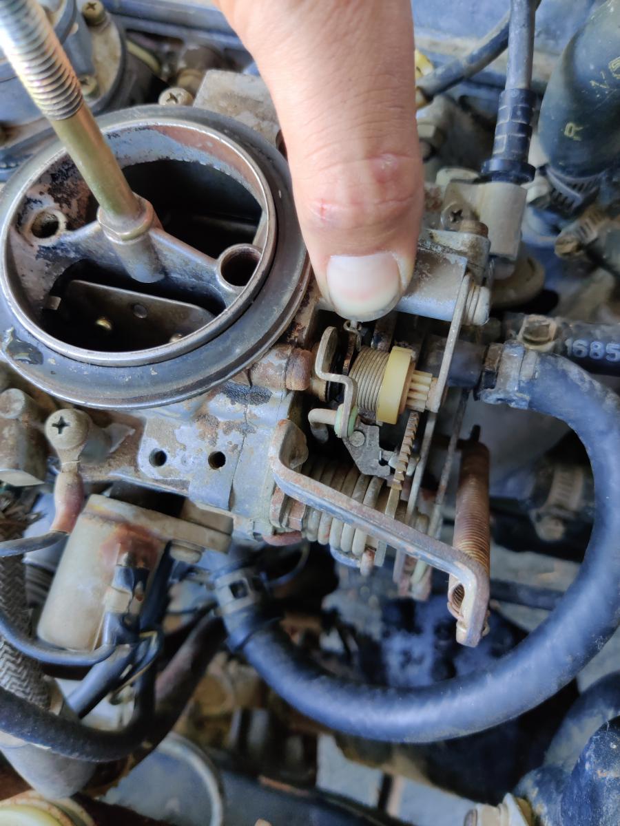

    I will check out the EGR & PCV valves, and clean them out. My buddy swears up & down that my rough idle is due to the open choke. I'm just not sure if it has been open when It was running fine. Does anybody have any input on fixing the choke flap?
    Check the choke butterfly when the engine is cold before starting. If it's almost completely closed and the butterfly has a little play in it, that would be considered normal. If it's open when cold, the wax choke pellet may have failed but the engine will run fine when warmed up. A tell tale sign it has given up is a thick looking grease built up on the throttle linkages below the choke housing. If that is the case I'd start looking for another carb. It is 'fixable' but #1 - the replacement wax pellet assemblies aren't easy to find and #2 - I have never been able to successfully remove one without damaging the choke body in the process.

    Before I get to work on everything, I want to show you guys the fuel pump? Looks like a line is missing, but idk what the hell is going on here. Also I have a pic of the choke butterfly, it stays fully open, but I'm safe to leave it this way? At least for the time being?IMG_20200701_105004.jpgIMG_20200701_104923.jpg
