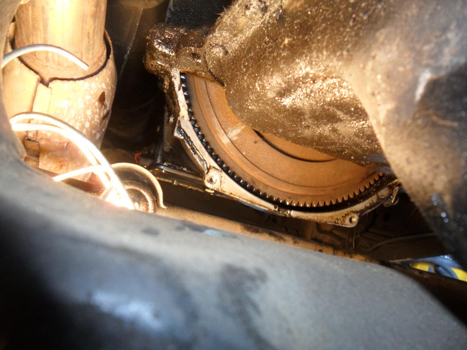

    I have pictures. More than 50% of the ring gear has shiny rounded edges. I'm thinking that is the problem. There is a section of it that is not rounded over and not shiny. I only added two pics.
    I did not remove the starter. When I installed it (it is a manual starter) the pinion gear had no visible wear or rounding over on it.
    Edit- Duh forgot to ask, does this look like the problem or should I focus on the starter still? I have a feeling letting that new solenoid get loose, and the lesser kick out it gave to the pinion gear, caused this problem.

    I think your theory about the starter solenoid not making full travel is on the money. Partial engagement of the starter drive will risk damage to the ring gear.

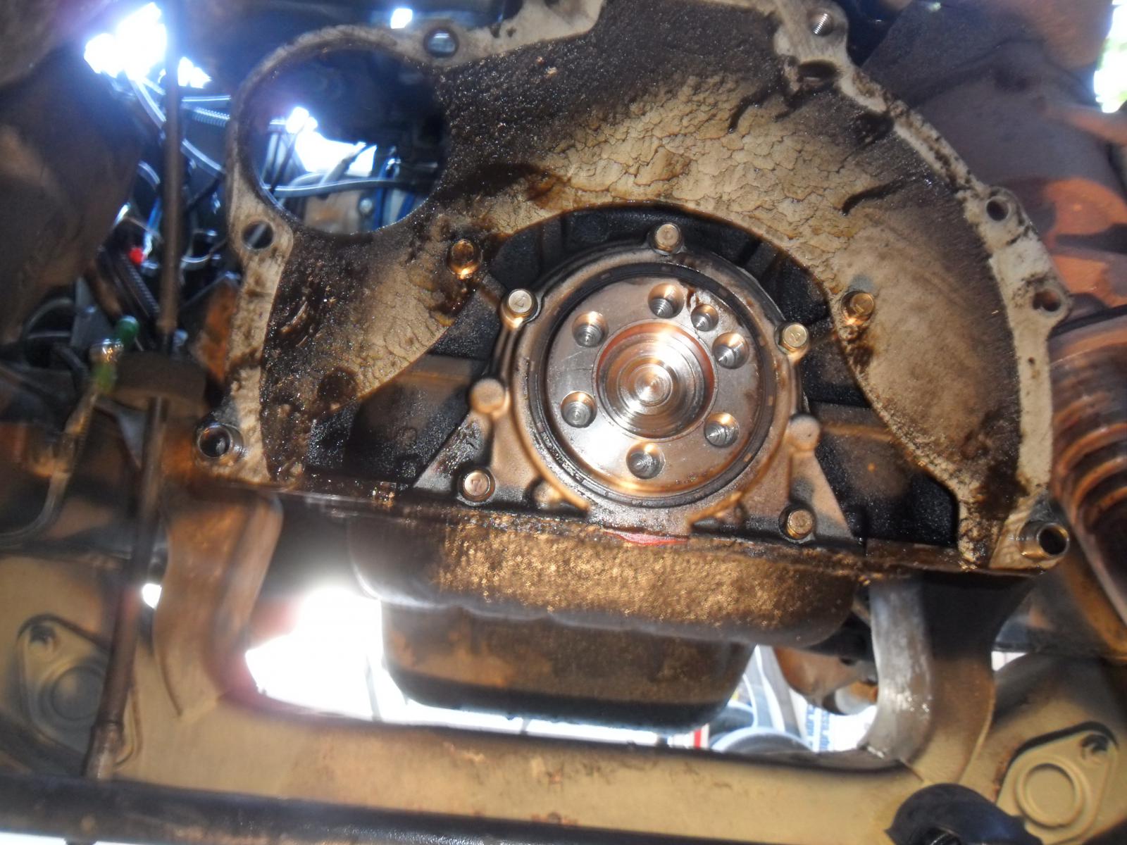

    Flywheel off. The inside of the trans was just as dirty. Took two cans of engine cleaner and 3 cans of carb cleaner to get it clean. The rear seal is in the local post office distribution center, I should have it today or tomorrow.
    Lots of chipped corners on the ring gear.
    Yeah that looks pretty (nasty) normal. I've noticed for some reason oven cleaner isn't as effective at removing gearbox grime as it is on engines. The carb/brake cleaner is usually the weapon of choice for this kind of gunk.
