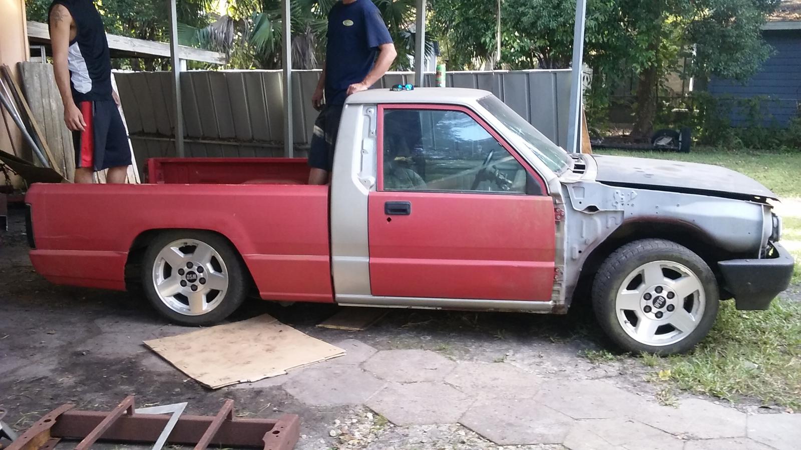

    Thinking about all the metal I have cut up.....and then looking at all that I still need to cut ......Decided to buy a plasma cutter.
    Picked up a versa cut 40 from Eastwood. Got it super fast after ordering. Having difficulties right now as it only strikes an arc when it wants to. It will blow through metal once it gets going but when I let go of the trigger to pause and start again it gets no go.
    Maybe just operator error but Ive used a Hobart at work and never had any problems. Ive got an electrician to help guide me through a new circuit in my fuse panel for a dedicated circuit.
  13. #163
    04-06-2011
    485
    Jacksonville, FL
    G54B-T
    Got a replacement plasma cutter. Working well but not in tight spaces so I picked up a set of extended tips that are good for getting into corners. Still playing with it before I start cutting on anything real important. It draws a lot of power and I still need to work on a better dedicated circuit. Thinking about using my dryer outlet which is on its own 30 amp breaker.
    The s10 parts truck is gone to the big scrap pile in the sky. Filled it up with as much junk as possible and drug it away. The whole time I waited for scrap prices to go back up they just kept going down but it was time to get it out the way.
    Thanx to Woody65 for driving up and buying my old gray truck bed. He brought the whole crew which made it a lot easier to get it out of my back yard. Ive still got the green bed from my parts truck which I dream of making a trailer to pull behind my truck. Not that I really need a trailer but I just like it. Maybe some dump action so I can scrap metal with ease.
    No problem man, thanks for making my truck look soo much better.IMG_20160103_120620.jpgIMG_20160103_120620.jpg
