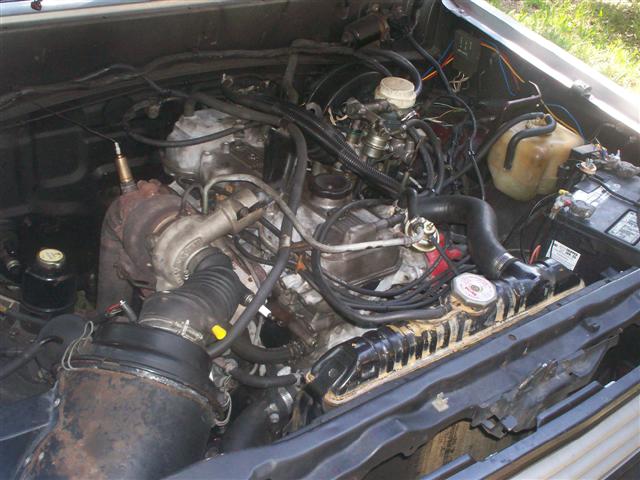

    100_0376 (Small).jpg100_0381 (Small).jpg100_0438 (Small).jpg100_0383 (Small).jpgYou guys can check the old board for the beginning of this thread. Ive got some new plans for upgrading the turbo to a big 16g td05h I just picked up. Some new paint should come along in the next few months. Ive had some new ball joints for a while now but havent put them in. I want to go ahead and replace all the bushings while I am at it since its squeaking. Hopefully some new coil springs as well...mine are saggy.
    03-21-2011
    767
    WA
    The big 16g turbo fits without modification to your starion manifold? A lot of people on dsmtuners claim the evo 3 16g outflows the big 16g turbo. Just a little curious on your choice of upgrade.

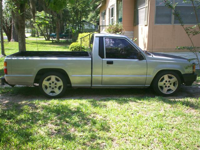

    thats a fairly clean truck you got there.....ill be tuned into this one..

    Quote Originally Posted by 4doorciv View Post
    Slight modification for the turbo. I can either send out my starion turbine housing and have it machined to fit the 16g exhaust wheel ( which will let me keep my existing downpipe) or I can make a new downpipe and use the 16g turbine housing. The starion manifold has about the same bolt pattern. There are a few ways to go about it. I need to reclock the compressor housing so that it points the right way and do some mods to the oil/water cooler lines.
    Im not overly concerned about the flow rates. Not sure what the difference is. Its already a big upgrade for me since I only have a stock 12a on there now. I have already installed new injectors and a walbro 255 fuel pump. I picked up the turbo used and its an actual mitsu turbo...not some ebay stuff. A direct bolt on turbo would have been a lot more$$$. Trying to make big power with the g54b is much easier with mpi and before I go through all that I would just go 4g63 twin cam. There is a much larger aftermarket support and parts availability for the eclipse stuff. I have a 2.4 shortblock my buddy is trying to get me to put his turbo eclipse head on.

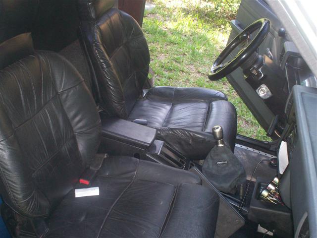

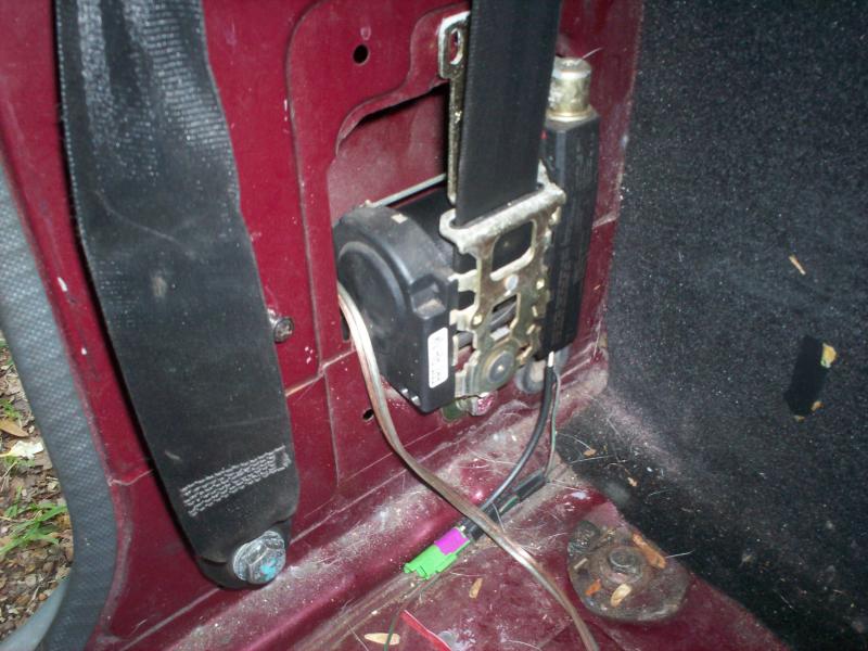

    Got some black seat belts to replace the old gray stock ones. I cant remember what year exactly (2001 I think) Daewoo. My belts would not hold tension any more and would just slowly unroll until they werent holding against my body. Id bet there are a lot of other cars you could get them from. They look really similar to Honda belts as well. I have Bucket seats from a starion so the belt latch just bolts to the seat. I think every mighty max I saw in the junkyard had the same issue with the belts and I dont believe they ever came in black.

    Even the small interior alterations make the difference. I had a gray and black thing going in my civic hatchback before. I miss the ac on that thing. I'm going to try to see if the civic belts buckle into the Mitsubishi latch if my oem mightymax ones are still there.

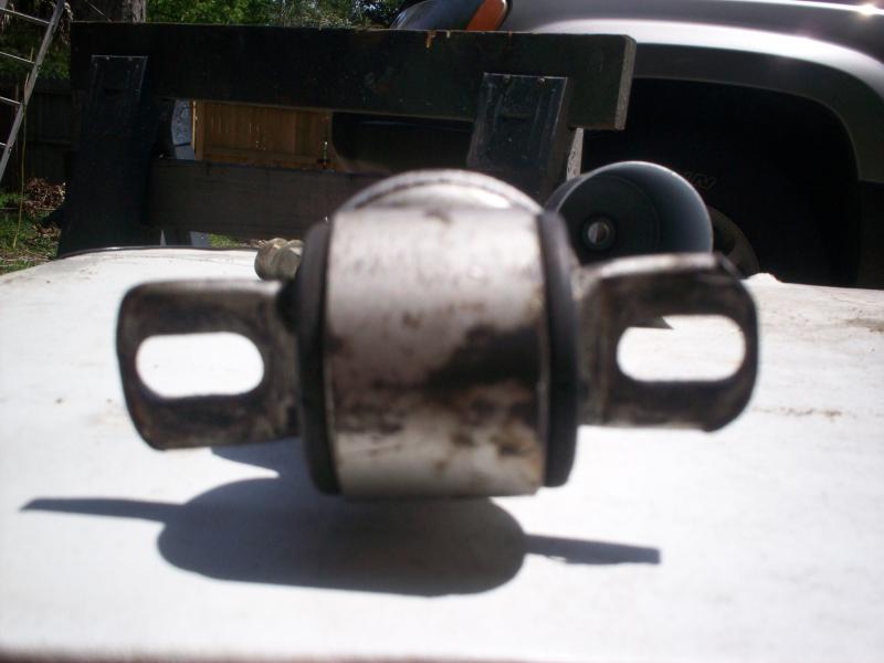

    They had one max at the yard yeaterday.......beat to death. I did find a rear sway bar from a 88/89 F-150 4x4. Getting it off while laying on the dirt wasnt fun. When I got finished I walked around some more and found another that was less rusted....probably cause it was a 2 wheel drive 91 model. Same sway bar as far as I can tell except the end links were different.
    They also had an old caravan with the 2.6 carb motor. I was looking for a temp switch for my electric radiator fan but the one on there had already been jumped with a wire to stay closed so I figured it probably didnt work. I am running out of ports to screw it into my intake and was hoping to get one that fit my radiator drain plug hole. I got a bunch of honda ones but they are too big.
    When I noticed the valve cover with the mitsu name on it I had to get it......since I was already there anyway. Dont remember ever seeing one on a starion like that.
