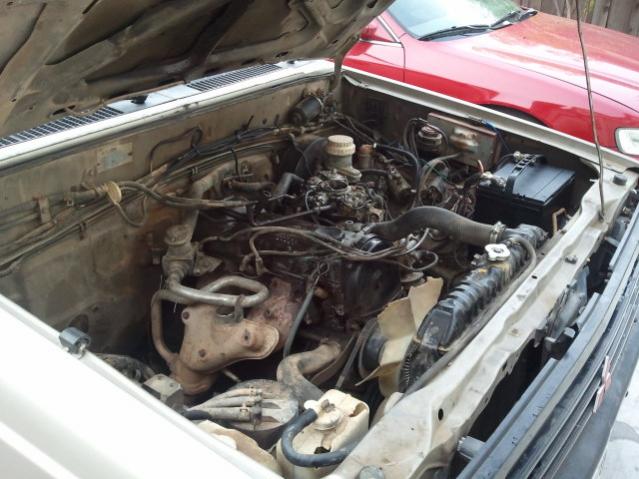

    I always wanted a beater to drive around the fishing hole. Now i got one that wont idle right.

    That was so bad, but clever. Maybe if you tilt it to the left it'll idle smoothly... jk. Check the hoses inside the box on the drivers side inner fender - critters crawl in there and eat the hoses or they dry rot from heat or age. Also check that the metal tube coming out of the exhaust manifold is not cracked. and tighten up the intake, exhaust, and carb bolts/nuts to eliminate leaks. Welcome to the site - we are a great lot that sometimes has an unusual sense of humor...

    The vehicle is running better now after i adjust the a/f mixture screw to 2.5 turn out and 3.5 turn on all the other screws(SAS,Fast Idle,Throttle opener) I also adjusted the distributor for timing to 8degree BTDC by moving the rotor counter clockwise and turning the distributor clockwise all the way. I don't know how im going to adjust the distributor anymore to get my timing lower. The engine still does a loopy idle but has been holding idle at stops. Took it for a 95 miles drive and back this weekend out of town. The Max got 23mpg on freeway driving so im sort of happy.
    pennyman, I have checked the box on the driver fender side and everything looks A OK. I tighten the exhaust and intake manifold bolts also.
    Time to do some fishing now!
    3,848
    You will need to pull the distributer out until you can move the rotor 1 tooth, and re time. But if you are at 8 then it's ok.

    Sup Camoit, Which way do i turn the rotor, clockwise or counter clockwise one tooth? I pull the distributor out today and move the distributor rotor counter clockwise one tooth. The truck started bogging and running retarded(slow). I tried gas'n it and it won't rev up at all but still hold idle. I move the rotor clockwise one tooth and it won't start. The timing on the crank jumps back to 10degree btd also sometimes, I have to wiggle it clockwise all the way to get 8degree btdc.

    To advance it 1 tooth you would turn it the opposite direction of the way you twist the distributer to advance it. That can be confirmed by looking at the direction the vacuum advance pulls the breaker plate.
    (Advance is always opposite the direction of rotation, OR opposite the way the vacuum advance pulls. This is for ALL cars and trucks make or model.)
    ....BIG THING..... You just said the crank timing jumps 10 deg. Does this happen all the time or when and how?
    There is a possibility the gear on the distributer is warn and needs to be replaced. Always move the tooth when the engine is on TDC #1. Then you can look and line up the electrode in the cap to the rotor to confirm all your settings.
    You can always pull the valve cover and look in there.

    I pulled the valve cover off and look to see if what you was talking about, but i didn't see any where that shows the distributor teeth visible. I put the timing back to 8btdc and notice there was sparking coming out of the distributor mount , where it is bolt down to the manifold when i turn the distributor.
    I think the timing skips around from 10btdc then back to 8btdc probably from a surge in the idle.
