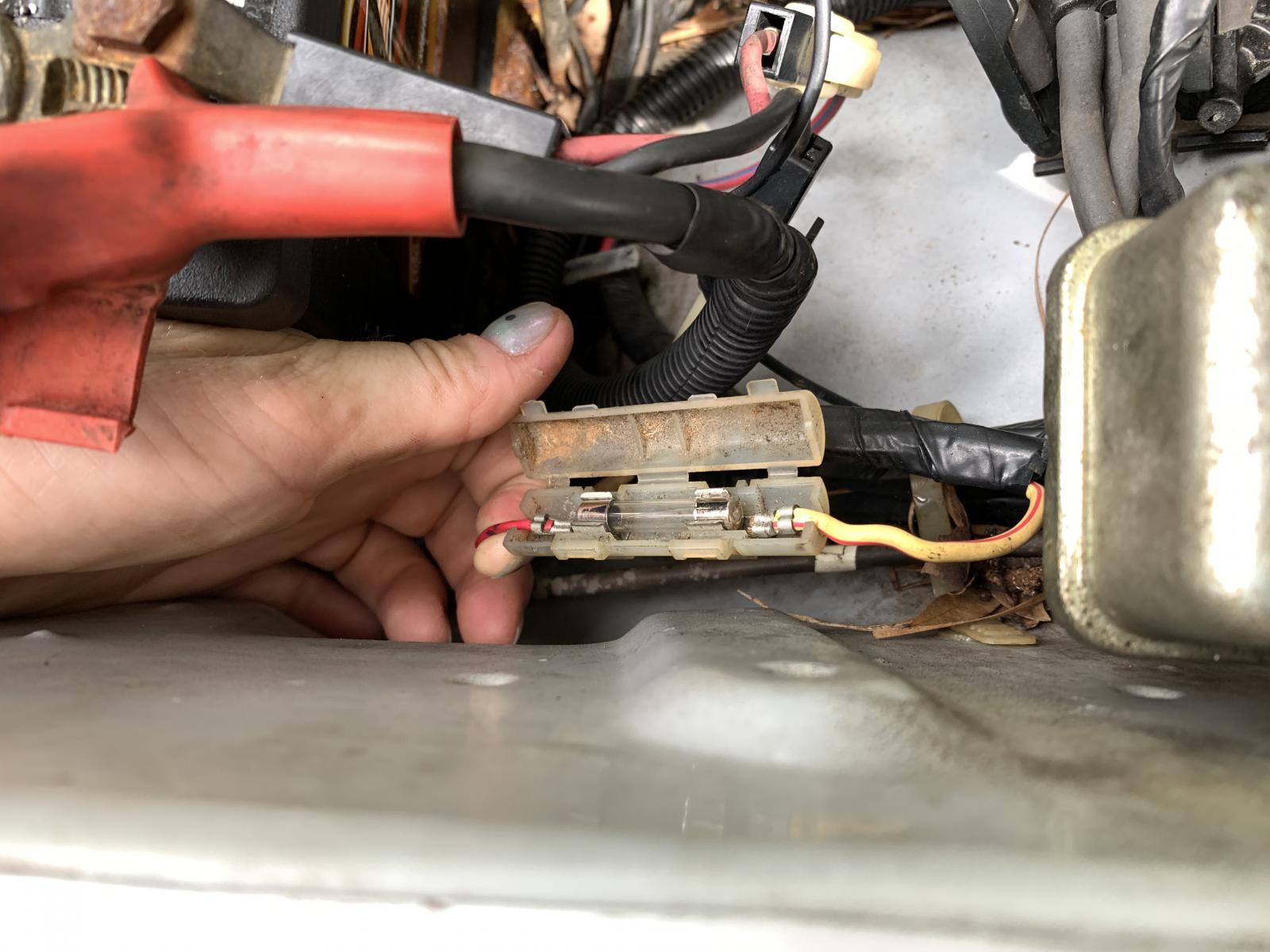

    There is an in-line fuse near the battery and i had changed that already but maybe the housing is toast? I can't really see what it goes to but it does connect to the wire bundle that holds my headlight wires near the headlight relay.IMG_4840.jpgIMG_4839.jpg
    I'm just not sure what else to check. Am I correct in thinking that as long as my relay is making clicks it's receiving signal from the switch in the cab?

    OK, so took the relay apart, hooked it up to my drill battery, and it seems to be working fine, cleaned up the contacts, threw it back in and no change. I think i must be missing a fuse or something somewhere. along the line. I'm getting all the other lights so i can't imagine it's a bad ground. anyone know of a secret fuse panel hidden somewhere? wheres the fuse for the headlights located?
    Yea. It's not getting power on one side of it. Use a test light and work your way back.
