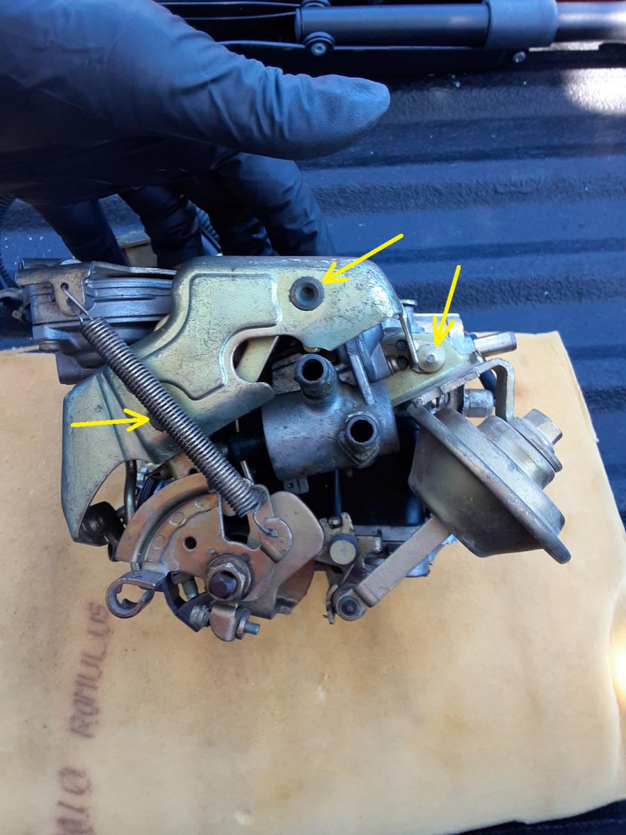

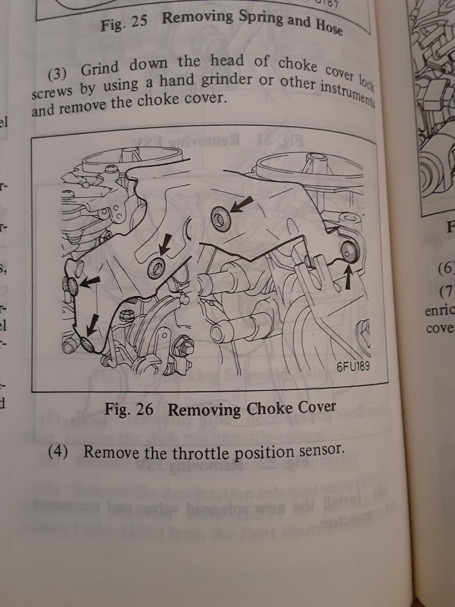

    Srr7172 what choke cover screws or rivets did you use to rebuild your carburetor..? anyone..?
    ANSWER discovered at my local hardware store ~ all 5 screws are male threaded & size is Metric M5 x 80
