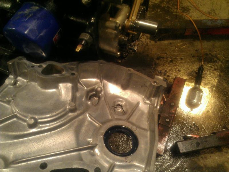

    Well the ticking was from the front cover. It appears the oil pump gear bolt backed off and pushed it's way through the front cover. Which would explain why the engine purred at first (10-12 minutes), then I heard a pop, and then the ticking started. I am having trouble posting pics, but I can email them to someone if they can post.
    No damage other than I had to pull the cover, clean the first few bolt threads and first few threads on pump shaft, weld the cover and reassemble using loc-tite this time.

    Here is a highlighted picture of cracked cover and backed out bolt. Luckily an easy fix. Just haven't gotten to drive it much since :-(
