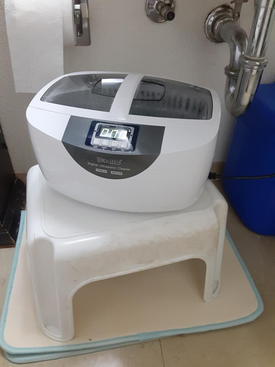

    Here are photos of the little ultrasonic cleaner which tested ok today (heat & ultrasound sat) Amazon $95.00 includes tax & shipping... I put a bead of sealer around the tank top & case -- might help keep fluid out of the electronics inside... They also included a small clear plastic sticky to cover the control panel to prevent water getting inside... Size matters but price goes up accordingly; hopefully the Mikuni will fit in the small tank, even if it requires flipping onto all four sides in four separate cleaning cycles to clean it... Instructions say ok to remove basket to clean larger items & use regular tap water NOT distilled water (distilled can damage some items..!)
    Cleaned Wifey's jewelry to perform the unit's test ~ sheeze happy
