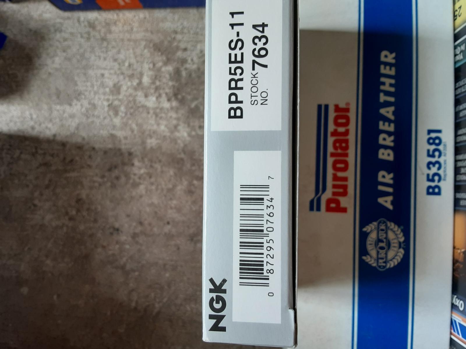

    LATEST: today installed new coil no help & starting fluid no help... My mechanic friend Vernon said he saw too much gas down the carb air intake -- says the engine is flooding... He will remove & work on the Mikuni carb float needle seat jets etc...
    Removed one plug it was black black black but it still fired a spark... I will install new plugs as well...
    At least I got the Made-in-China coil off the truck the NAPA ECHKLIN (sp?) coil is Made-in-USA
    I might even put new NAPA Echklin cap & rotor (the expensive brown color parts) already have a new NAPA set of plug wires left over from the shop working on the truck = all new secondary ignition = IF IF IF the Mikuni gets correctly fixed then this truck should run really well
    Fingers X'd

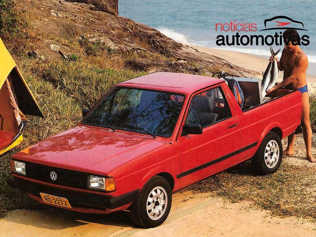

    VW has been making these in Brasil since the 90's (maybe earlier?) for the latin american market, looks like they still are. A fast, fun, and dangerous, little car truck.
    https://www.vw.com.br/pt/carros/Saveiro.html

    MrPaco, wow, good catch finding that cool VW truck; I want the long bed regular cab version with snap on silver colored plastic wheel covers and body color white... If DELETE options are available I would select every one; don't need no stupid radio, CD player, in dash GPS, etc... My cell phone & a bluetooth small BOSE speaker is all I need...
    Much as I would hate to; I would even pay $2,500.00 USD for a damn automatic transmission (for my wife to drive me around :^)
    I bet geezer likes it too even tho VW deserves an ass whipping for polluting 'n cheating BUT it's still better than sumpthin Made-in-China... They really hurt the world...
    Peace/Forgive

    It's based on the Gol, the Brazilian-made econo version of the Rabbit.
    https://en.wikipedia.org/wiki/Volkswagen_Gol
    I like the look of the late 80's models. A friend had one of these, it had a small engine (1.3 or 1.6lL ?) but it was so light and fast that you had to drive around with ballast in the bed, otherwise it would fishtail like crazy.
