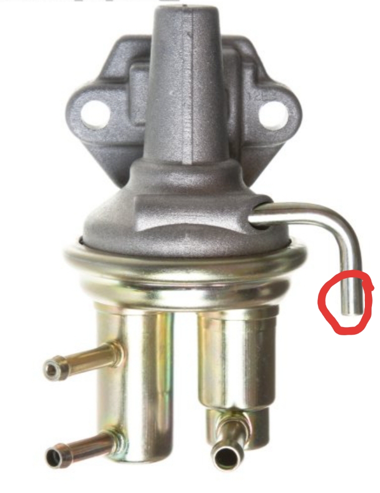

    Ok, update and question all in one. I noticed that there was a small leak of fuel around the fuel pump. We have installed a new one and here comes the question. I have hooked up all the hoses with the exception of 1, my son got a head of me and pulled all of the hoses before I could label them, D!@N Teenagers..... where does the hose in the picture need to go?

    We put a new fuel pump on the truck due to low fuel pressure and here is the question from the post that didn't get thru....
    Where does the hose that hooks to the port circled in the picture above go? My teenage son unhooked all the lines before I got out there

    I believe that is a vent line. There is a supply from tank to pump, pump to carb and return from pump to tank. Those would be the 3 with bulbs on them to help the hose clamp on.
    That 'line' doesn't get connected to anything. If the pump fails, any oil or fuel from inside the housing will leak from that tube.
