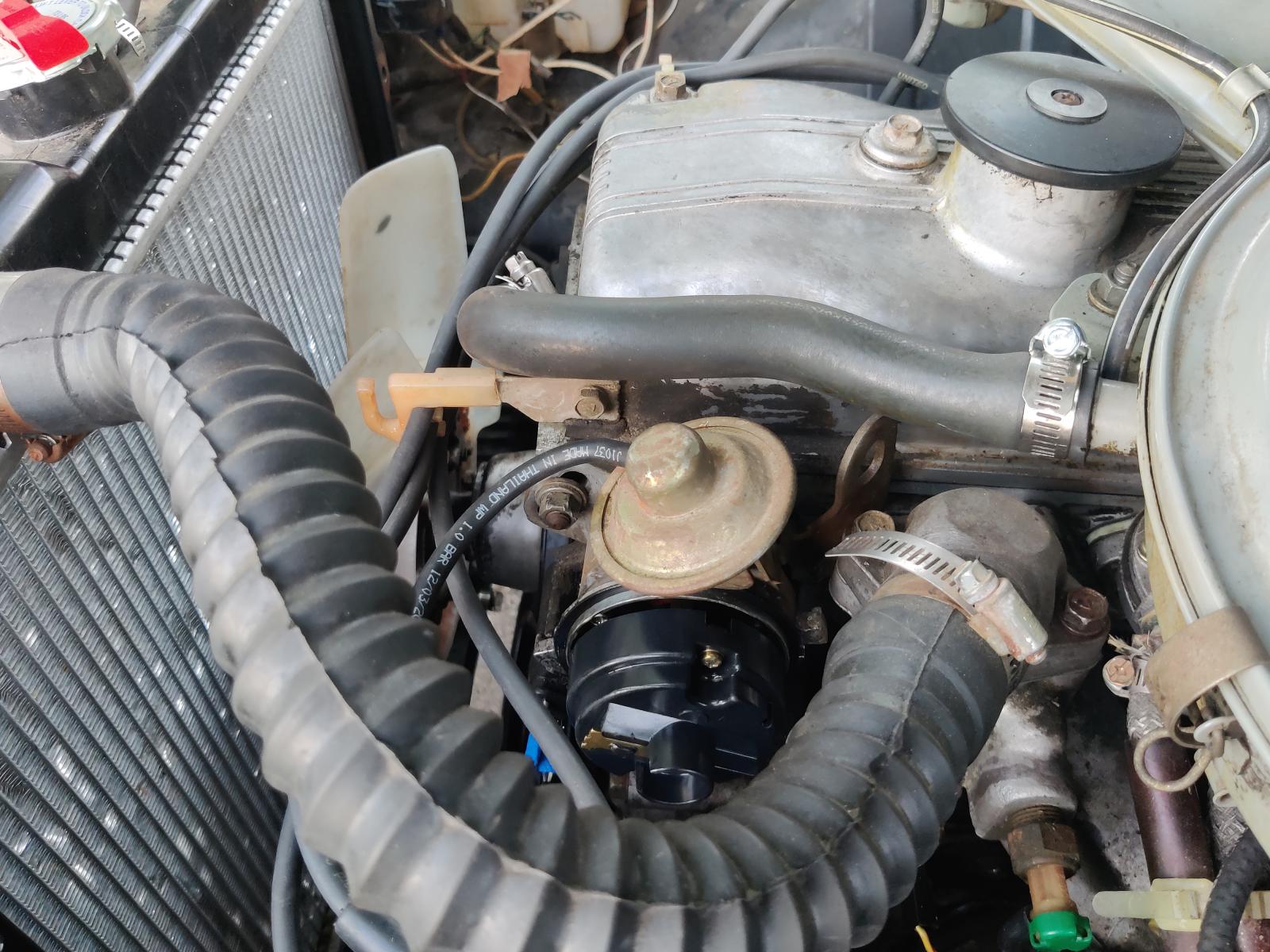

    That is a full blown timing problem - it is knocking itself to death. Take a pic of the distributor as it is now and post it up. Maybe a keen eye will spot what is going on with the advance/retard on the distributor and you can begin to unravel the issue.

    Okay, this is at TDC, plugs are gapped, wires are all correct. Cap is sitting where it sits. Don't trip on the second coil that's just a test coil that I haven't swapped back yet. Please take a look guys & let your tinkering minds go wild.IMG_20200708_200257.jpgIMG_20200708_200345.jpgIMG_20200708_200354.jpgIMG_20200708_200425.jpgIMG_20200708_200548.jpgIMG_20200708_200600.jpg

    Ok it's not exactly @ TDC (closer to 7 degrees BTDC) and the distributor is sort of pointing @ where #3 cylinder should be firing from
    I think the distributor is way off. I'd be getting a timing light and checking it out (this is about the only time I use a timing light now...) My guess is the timing is really advanced. Turn the crank to TDC 0 degrees, get a white marker and put a little dot on the body of the distributor that is as close as you can get to the leading edge of the rotor contact and install the cap to compare where the mark is VS distributor cap plug lead post is. If the mark is to the right of it, the timing is advanced. Left of the mark is retarded timing. Another test is just start the engine in a garage at night and kill the lights - look for misfires. If it's not obvious, use a hand trigger spray bottle full of water and lay a few fine mist sprays over the plug lead paths. Orange or reddish electrical arcs = high voltage leak. Misfires and ignition timing tests aren't specific to these engines and any method described online will generally help you diagnose a problem. Luckily the ignition systems in our trucks are fairly simple.

    Okay, so today I took a quick look before I even had my coffee, ( I have a deal with my wife that truck time is when the whole fam is comatose), so I went to actual TDC, I thought 7° BTDC was how I was supposed to set it. I cranked it, and still nothing. I marked the distributor like you said & rotor terminal is nuts on the #1 lead post. Something definitely isn't right here with the timing, & it may be beyond my feeble mechanical mind. If the ignition system is really that cut & dried, I can't find where I goofed. On a side note, I was taking a look around for any damaged wires & I found a leaky ectoplasmic mess in the cab next to the a/c vents by the steering column side, not sure what that is either...IMG_20200709_082923.jpg

    I have never seen that sort of rotor and my distributor sits in there with the vacuum advance on the bottom. The middle T is TDC or zero degrees. Even that little bit off matters a LOT.
