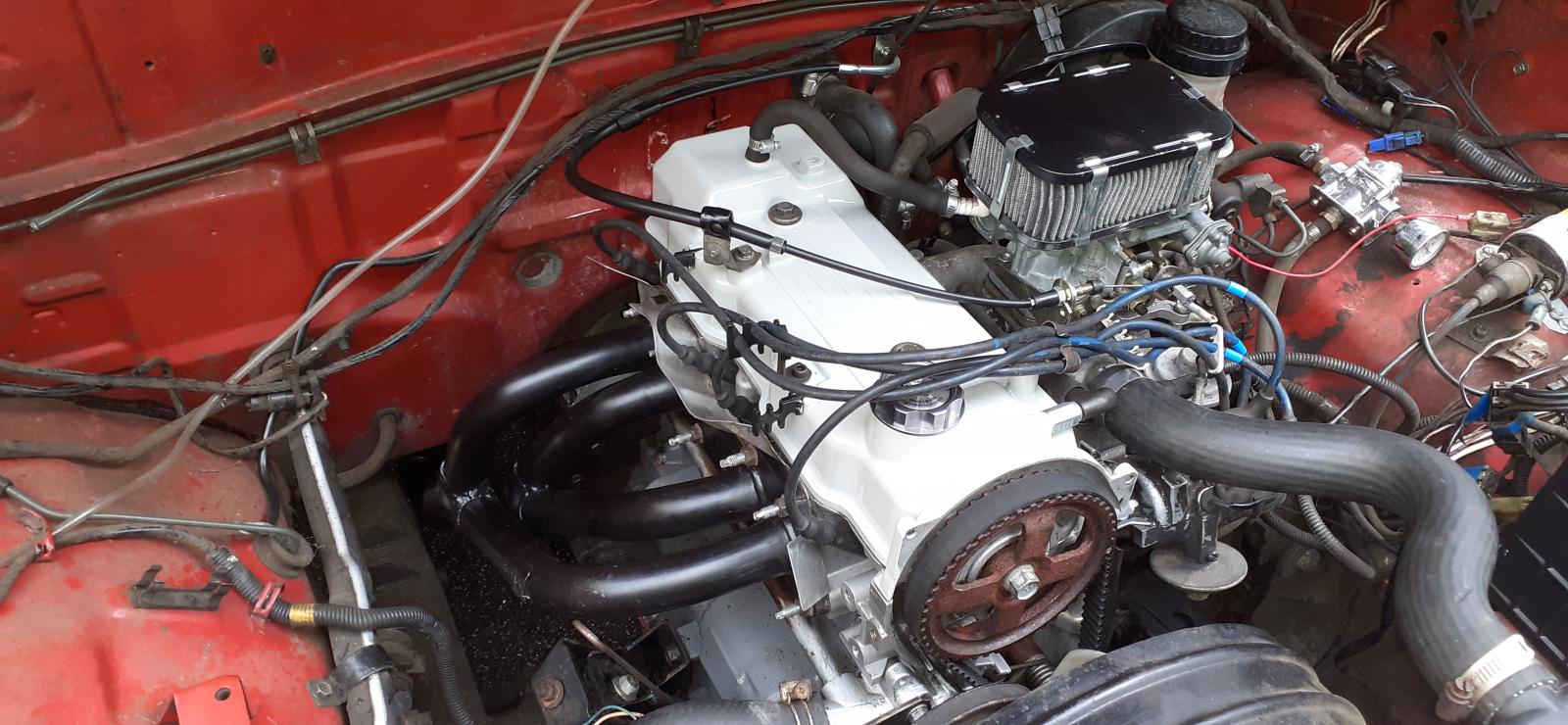

    It sounds good but I have take it to get it welded . I dont have a welder . It's just sitting together . I started the motor and broke it in . The header smoked alot at first . Lol. But then stopped . Its loud but will quite down when I do get it welded . Also going to hollow out the cat . I have 2 1/2 to 3" exhaust tip . Straight pipe exhaust.

    I got them in today. The papers say they are for the L300, 4g62, 4g63. Is that the same experience MaxDSM and CatDog had? The welded tag says Redback 136. They are lighter and smaller than I imagined. The tube end got banged up in shipping.
    Edit- just logged off and the message thru ebay came back that the 136 is code for the L200. He didn't tell me what they coat it with. Any ideas? There are small spots where it needs to be coated. I suppose wood stove paint might work.

    Nice headers but if they stated for an L300, they're gonna be fouling somewhere. Is there an O2 sensor bung welded into them? That would be good if it does - you can install an EGO/air fuel meter to monitor what the engine is up to.
    They responded. The 136 is code for the L200. No bung. Apparently this is how they streamline their listings. If you contact them and ask for L200 they respond with a code you put in the order message and you get the L200 version by ordering through the L300 page. They sure beat the 8 week delivery estimate.

    Yep finally got mine welded . Decided to keep the cat and it's running great didnt foul out once and drove it all day today lol. To several stores . The pickup is very noticeable. And as geezer101 said you can have a 0² bung plug welded in for cheap. 85ram50 that dent shouldn't matter any basic automotive welding place can fix that dent easy ..make sure you brake in the header with w0T !
