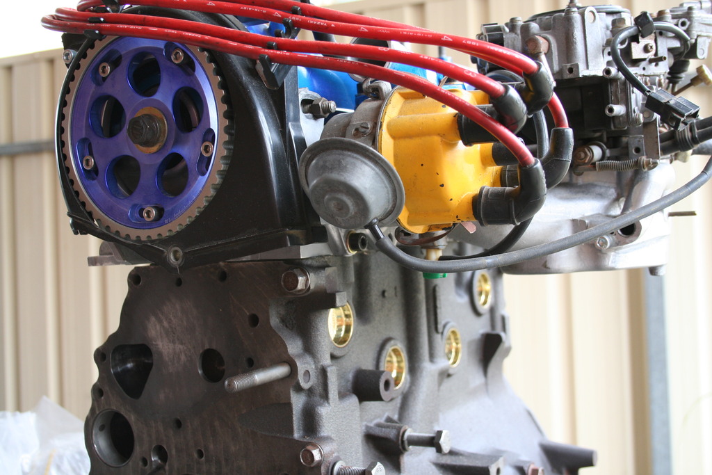

    I cut out the cam gear cover on my 4G63 - the front face of the adjustable cam gear sits flush with the cut out section of the cover. You can see the whole gear without the teeth being too exposed. Here's a pic of it dummied together:
    http://i1089.photobucket.com/albums/...psjo1csrec.jpg

    geezer101, that looks fine. Doesn't protrude much at all. I can live with that

    Clean, consciencious work is always a joy to behold. Nice work, Neil!!
