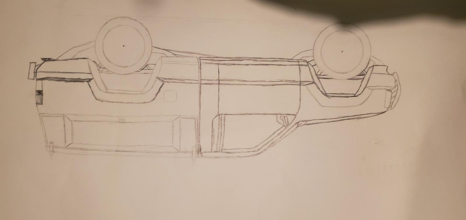

    I have a large scale sketch, yes
    Its incomplete, still getting lines corrected and dimensions more accurate

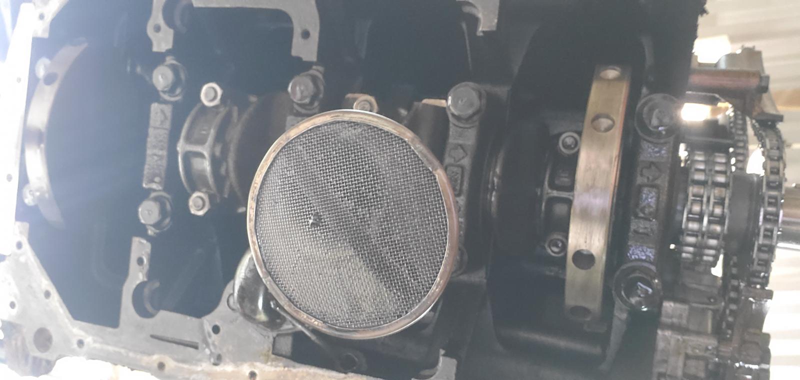

    Ah. Here.
    The block is honed, all bearings looked amazing, babit was still on all of them. I beleive it is an original 50k mile truck. Too bad it's so rotted out

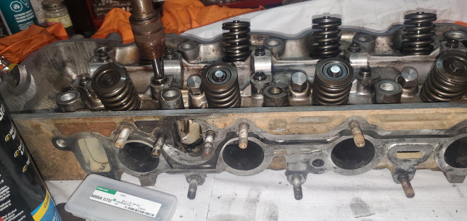

    Jet valve elimonators in! Also tapped my head bolt holes and rocker arm bolt holes
    just gotta give it a weapons grade clean and some port work, some tidying up in the valve bowls and it'll run super smooth

    Already cleaned the valve bowls, I think I will try to port match the head to the gasket with a die grinder. Or, since I am V6 swapping, may just ignore it.
    Well, you've got the head off and it's half way there... the valve bowls are the harder part of the head mods.

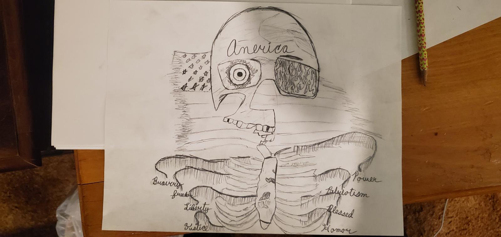

    Made a little free time sketch with some minor detailing, might me the start of the painting under my hood
