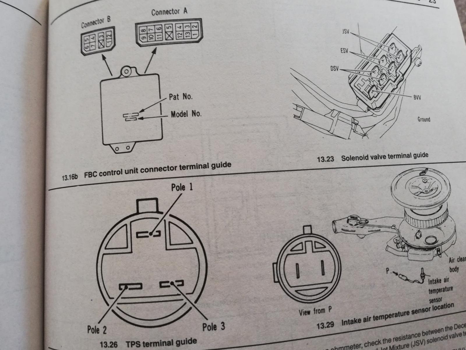

    1,222
    Emissions box is the Feedback carburetor system (FBC)
    some numbers for checking
    Throttle position sensor
    output voltage
    2.4 L engine - 0.28 to 0.52v
    3.0L engine - 0.4 to 1.0 V
    resistance (at closed throttle) 3.5 to 44 ohms
    egr control solenoid valve resistance 36 to 44 ohms
    engine coolant temp sensor resistance
    32F - 5.9 k-ohm
    68 - 2.5 k-ohms
    104 - 1.1 k-ohms
    176F 0.3 k-ohms
    motor position sensor resistance (2.4l models)
    4 to 6 k-ohms
    oxygen sensor output voltage
    1990 2.4L models 1 volt
    1991 2.4 and all 3.0L models 0.6 to 1 volt
    purge control solenoid valve resistance
    36 to 44 ohms at 68F
  7. #107
    1,222
