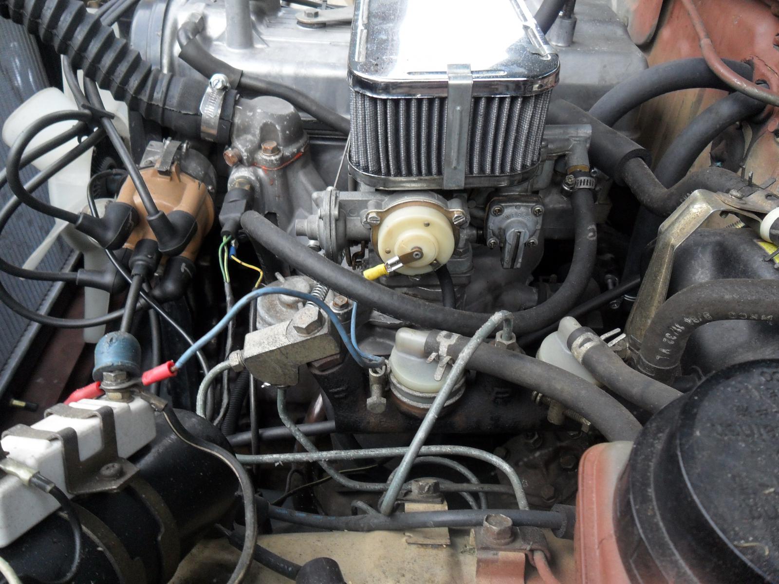

    Mine has always had puddles of gas in the intake. It never seemed to affect how it ran. The only problems I have had starting it are due to how long I leave it sit. Once it starts it will run and start normally as long as I do it every 3-4 days. I just forget to and..... This is the first time it has been do finicky about starting. Usually pouring gas in 3 or 4 times does the trick.
    Posted so I can look at my old wiring

    I put the coil wires back the way they were and charged the battery some then poured gas in the carb and goosed it with the 50amp boost and it started. Drove it a few miles. I'll see in the morning if it starts again.

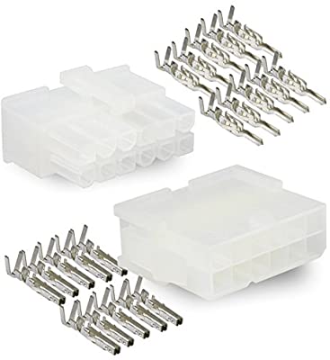

    I have quoted the picture into this post. Can anyone find the part number for this connector? I am talking to a NOS parts salesman who needs the number to search for it. He did not recognize the picture.
    I have also purchased a terminal removal tool set hoping to be able to just undo the connector from the harness and only have to change out 1 or 2 wire ends to put it all in to the new to me connector housing. As is there is still a danger of a short across that gap where the plastic wall should be.
  25. #100
    1,222
    Cheap enough to try.
    Id go ahead and swap it for a Deutsch connector personally
