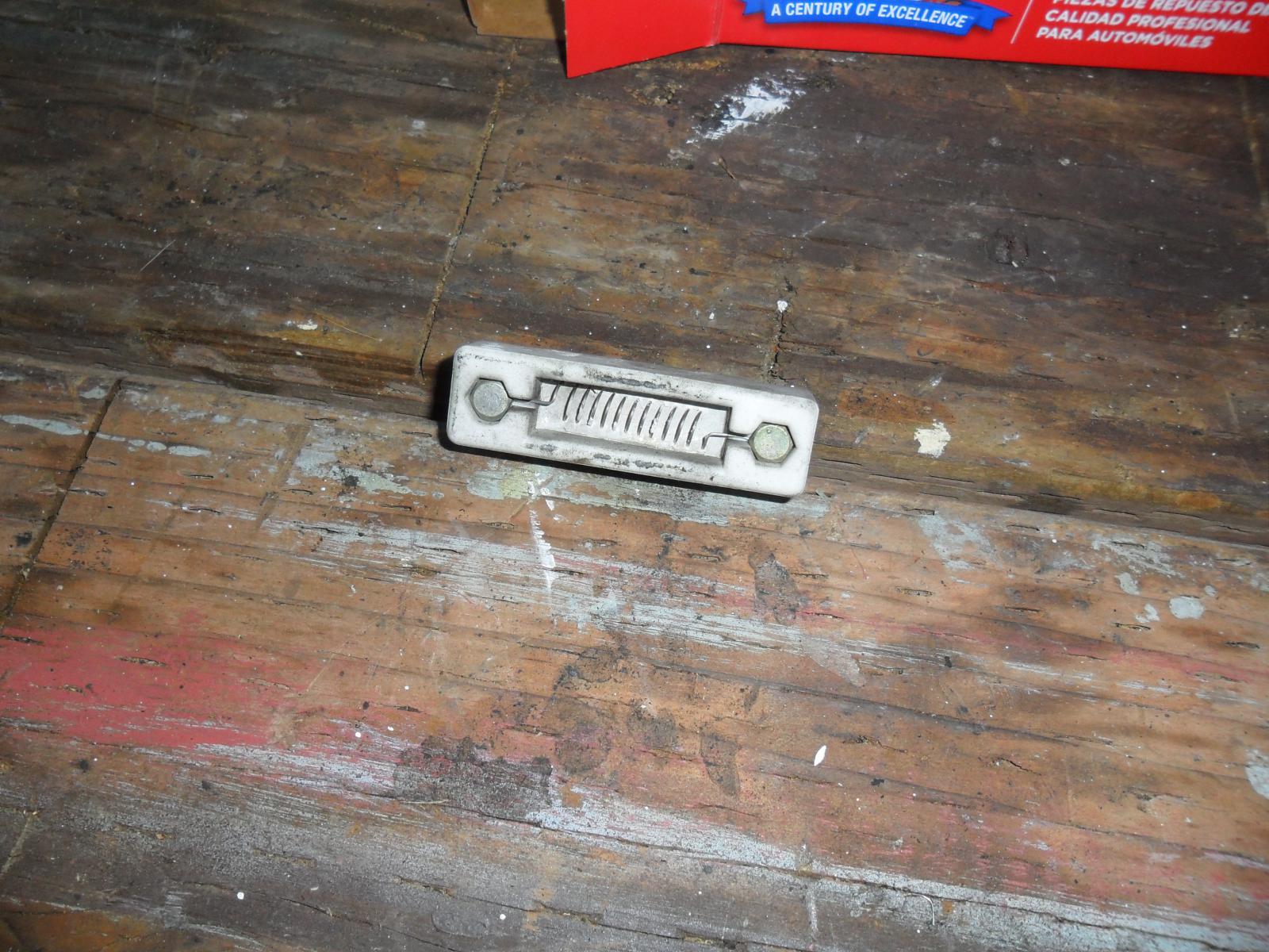

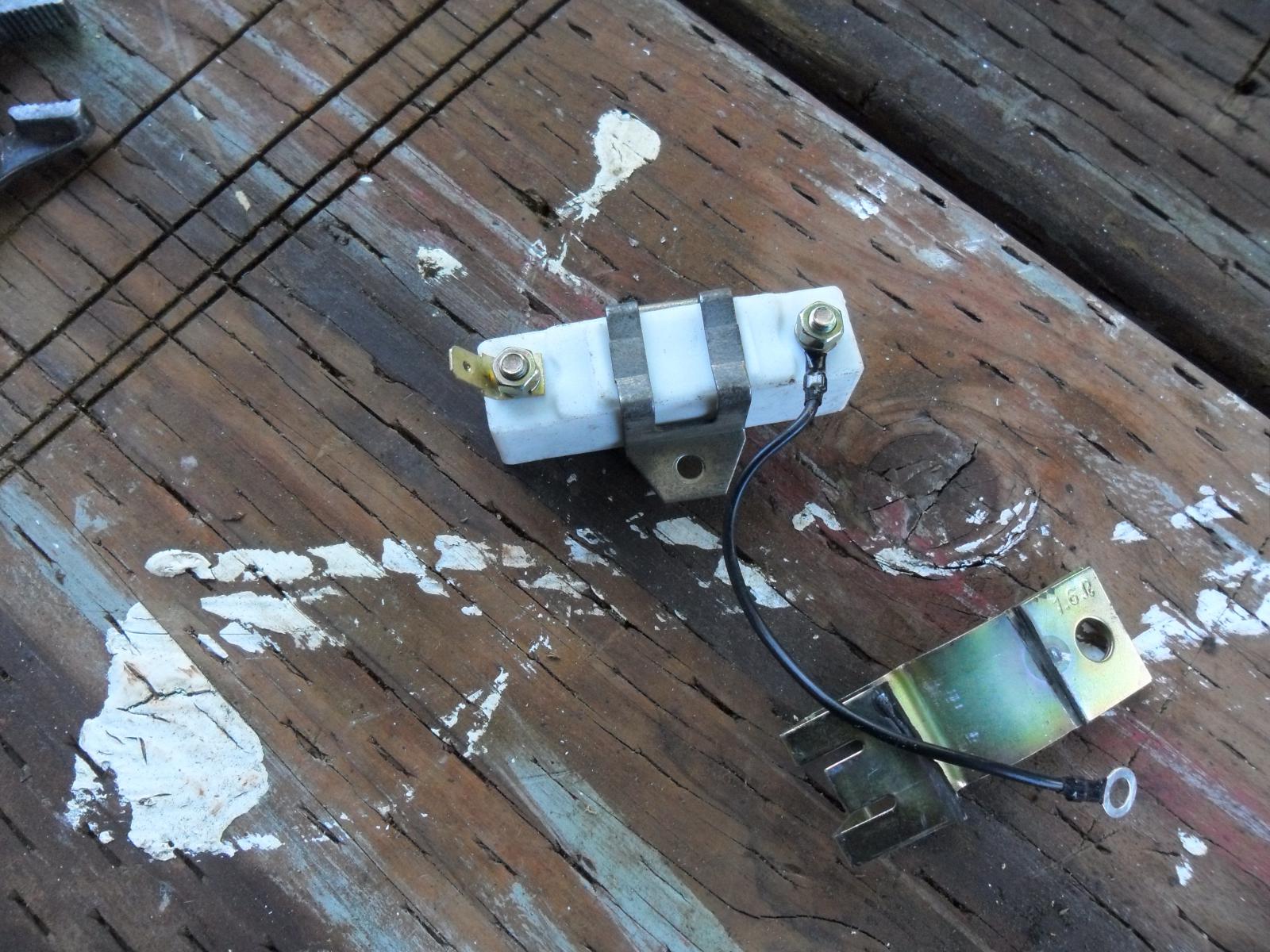

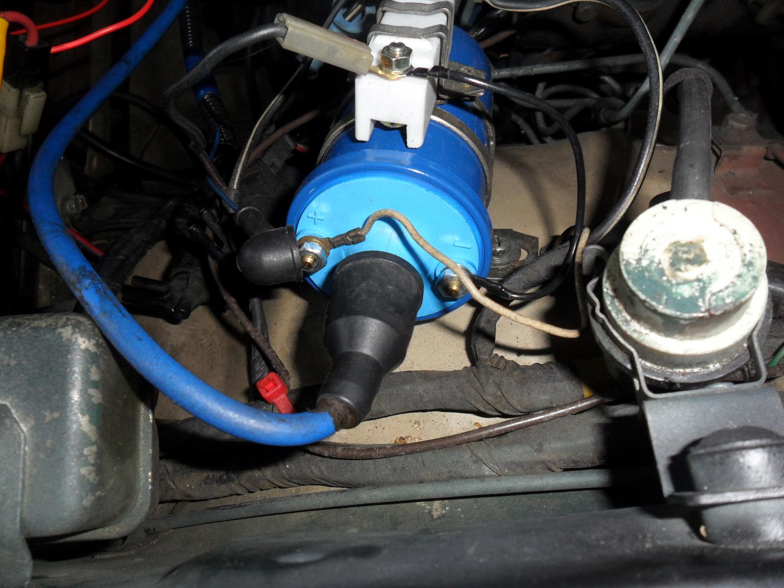

    I got the new coil and ballast. The coil clamp was tight to get back on. The ballast had a new style clip I had to cut off. The ballast spring is not molded into the ceramic and the bottom has a small piece that come out. I glued mine in with superglue after cutting off the new style clip. See pictures.
    Now the new ballast had the wire and the slip on connector on opposite ends as in the picture of the coil installed without the wires connected.. The way it was when I took it off they were both on the same end. Is this something? It ran but it did like to give problems starting if I did not start it every few days or it got very hot. I'll finish it up in a bit then put the other batteru in again to see if it starts. I fear I may need to take the harness apart and look for shorts.
    new ballast hanger cut off.jpg new ballast old clip.jpg coil and ballast installed.jpg old ballast.jpg

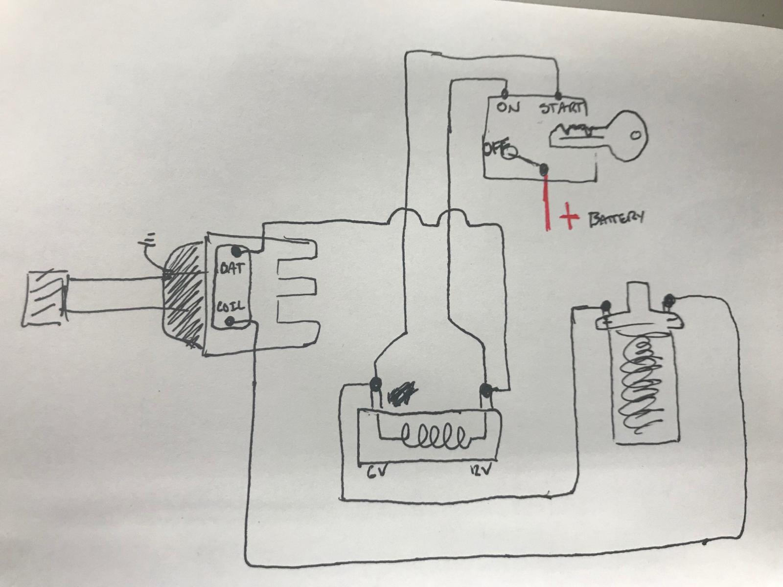

    I forgot I had drawn this up a while ago. Might be handy to have. Yes, 12v is distributor side.

    Thanks for the drawing. That looks like how mine is wired. So I got the spark tester to sit in the top of the coil and plug into the wire and got absolutely no sign of light while I cranked. I have it trickle charging right now. I also took the remote starter S post wire and put it in both of the ballast connectors and when I hit the switch nothing happened and I heard a tiny click. You were right about the blade connector and removing the wire. I had the remote wire clipped to that S post and it would only turn the solenoid until I removed the vehicle wire.
    I'm perusing the FSM and am not sure yet how trace this. But I think this means for some reason power is not getting to or through the coil/ballast resister.

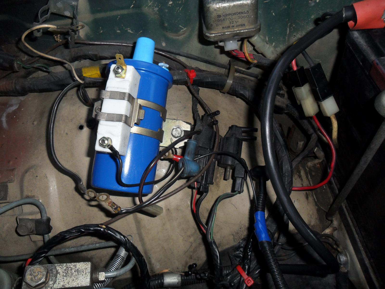

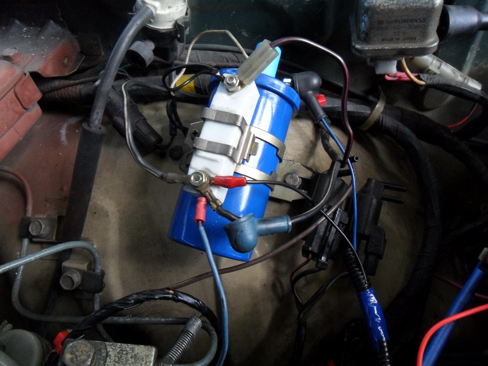

    Here are two picture one of the top of the coil and one from the other direction showing the wires. The blue on the + is from the dist. The other wire from the Dist is the black one that runs under the black/yellow one with the blue boot. The blue one on the ballast is for the choke.
    I just noticed that the other black wire with a yellow or white stripe is also connected to the same ballast post but it came from a different section of the loom. You can see it in the top down picture.
    Does anyone see anything incorrect here?

    The coil terminals are reversed. Distributor blue should be to - side of coil. I'm assuming the white wire on the + is a tachometer signal wire. That should also be on the - with the distributor wire.
    The jumper from the ballast to the coil is how it gets it's power. That should run to the + side of the coil.
    Reversing a coil will cause lower output. The way they work, electricity flows through the primary windings on the + and - terminals creating a magnetic field. When you break off the flow of electricity (which is actually done by breaking the ground on the - side of the coil, blue wire) the magnetic field collapses. The primary winding circuit is now open so the field is forced into the secondary windings and through the coil wire, distributor cap center terminal, rotor, distributor cap outer terminal, plug wire, and finally plug. When you reverse the terminals on the primary windings, the magnetic field that is formed has a different shape, and it does not collapse into the secondary winding as effeciently.

    Also, I'm not sure what the second black/white or yellow stripe wire is on the ballast resistor. You would have to follow it in the loom. Could be the voltage sensing wire for the alternator, or something for emissions equipment.
