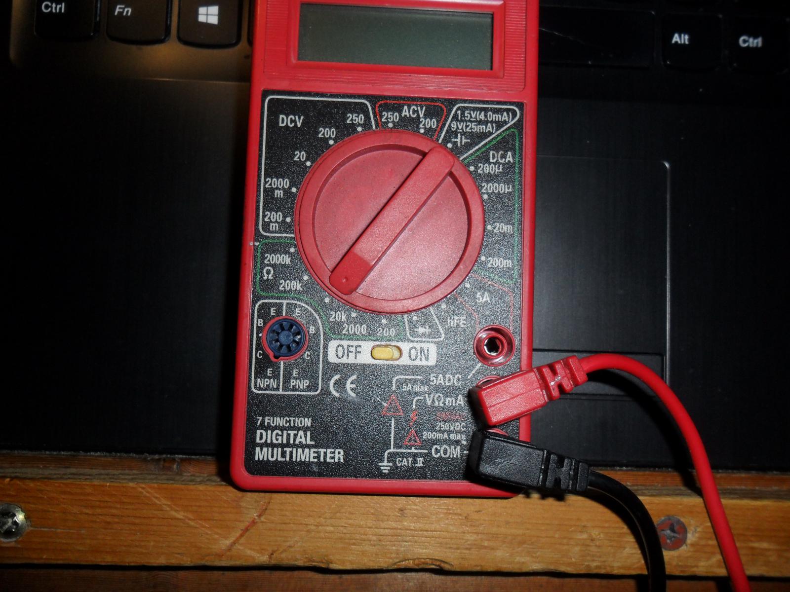

    I tested it with the harbor Freight 7 function digital multi meter. After removing the wires from the + and - pins I touched them with the tester and got 0. Then I tested the output of the coil and it read 10.01 ohms. Here is a picture of how I had it set. I am putting it here because I am not used to using meters like this.
    How many volts are you getting on the + side of the coil?
    You can always run a jumper and power it directly to test. Also test the voltage drop resistor that is before the coil on the + side.

    I got zero when I touched both the + and -. Touching the+ and output I got the 10.01. I have to got get a remote starter and rewatch the vid on how to test. I will also post a picture of my coil and the bolt on ballast is it? I am not sure of what parts are what. the ballast is OE AFAIK.

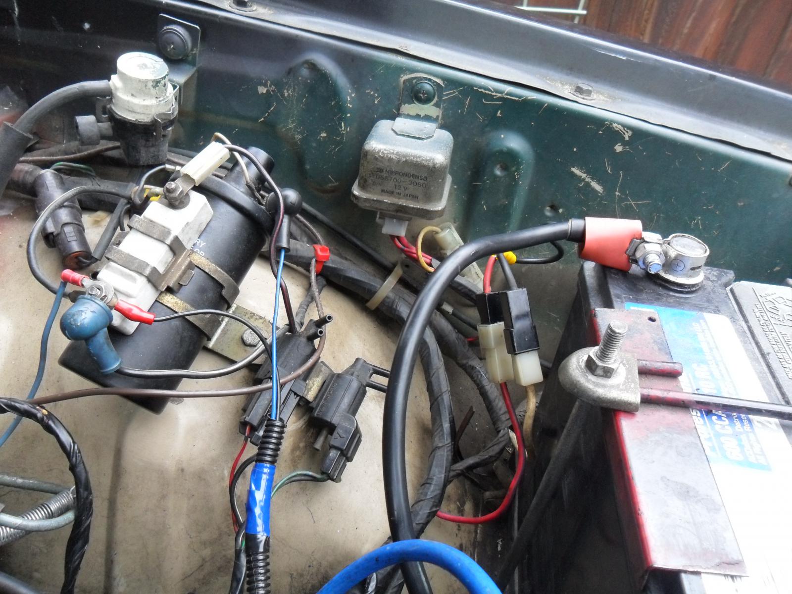

    If I did step 4 on page 8-31 of the manual correctly I got no spark. Which means I have to check the control unit, pickup coil, ignition coil, or secondary cable.
    I assume the ignition coil is the main coil in the picture I attached, the pickup will be in the dist which is new and IDk what the control unit is. I took the squarer part in the middle top off, cleaned the connections and added dielectric grease. The fuse leading to it looks good. I'm guessing that is the control unit. When I had it off with the multi at the same setting it also gave me nothing but zero when I touched the 6 pins with pos and neg probe.
    Suggestions please.
    Is there a coil with an internal ballast I can install on here to clean that up?

    Found and old picture of my ignition wiring. Looks like you have everything connected correctly. The ICM does run on the 12v side of the ballast resistor.
    If you got the lisle spark tester, the lead is reversible. I suspect most are. You can pull the section of plug wire off of the tester and flip it around, with the 90 degree boot connected to the tester and the straight end on the spark plug.
