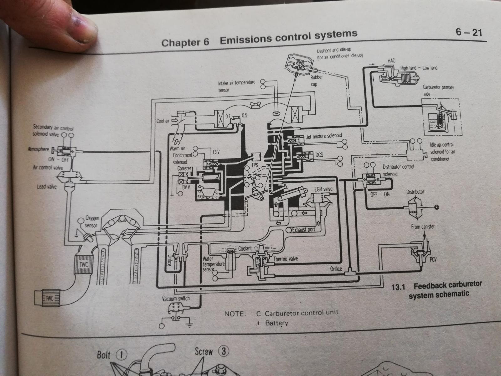

    Pull the ECU out. Just unplug the connectors and there is 2 bolts holding it in. It's at the passengers right ankle. Open the ECU and look at the capacitors before you waste anymore time and money. They go bad after 25+ years lol. They will become corroded and the fluid leaks out of em and you will have the exact issue your having right now.
    There are actually two bolts at the bottom and a nut at the top right behind one of the connectors where it is grounded that is a bear to remove unless you take the ducts out. See post #62, I had it out and it looks good. I do not think it is doing much of anything for my truck since it is for controlling the Mikuni and I have a Weber.
    03-16-2018
    341
    Raymond New Hampshire, USA
    I believe you are correct. The emissions box is not the same as the ECU. Capacitor failure in the ECU only applies to fuel injected engines I believe.
