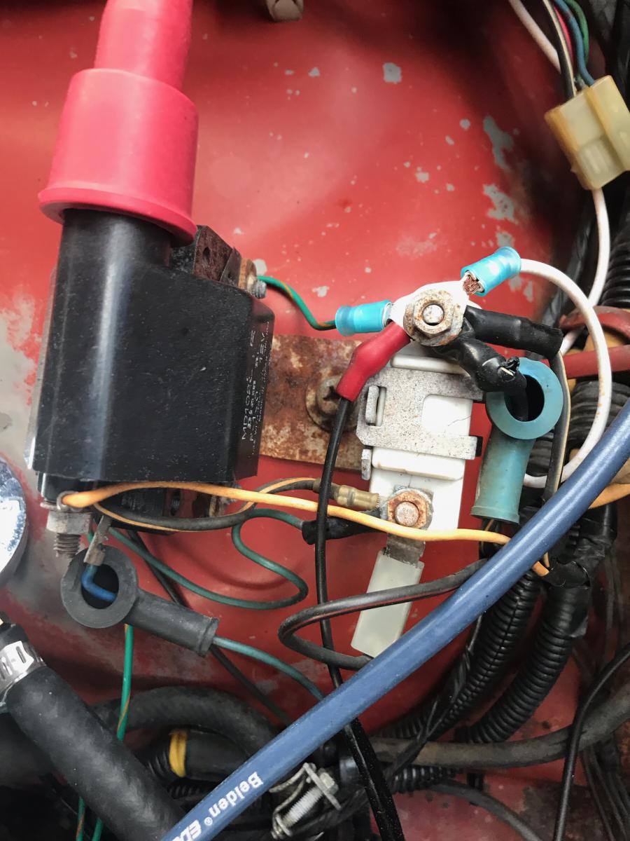

Looking for something that looks a little more appealing than this cluster.
Any suggestions?
Any suggestions?
You can go with an Internal regulated coil from a more modern EFI car. (ex. 86up Mustang) or a MSD Blaster coil.
Rewire the ghetto fix with a better connection block. The solid state coil is better than oil filled coils and changing coils won't sort out the eye cancer wiring.

Coil has had it.............. If I go with a blaster coil or the mustang coil what about the ballast would I need to run a ballast with either of these coils. I have went to the local auto parts stores and they all carry a coil which looks like a coil on my 95 Bronco (looks nothing like the original coil) and they don’t have a ballast do I need the ballast? Or is it internal? Thanks
I have accel coil . Haven't had a problem . No ballast .https://sportcompactwarehouse.com/ac...f635680f31388&
I am going to order one now.
Thanks for the input.

When I bought my Ram 50, the PO had repaired some pack-rat damage to the wiring, and the coil was a generic aftermarket oil-filled can-type coil zip-tied to the stock transformer-type coil, so my setup there was even uglier than Lil Red's pic. Chucked all that nonsense, tidied up the wiring, and installed one of these a year and a half ago, been running fine ever since:
https://www.ebay.com/itm/381825243549
Well wish me luck, I stopped by advanced auto they said online they had one in stock picked up the coil. Used an old thread from 86MAX on the wiring diagram. Truck fired right up. I do have one left over black wire that has a female spade that went to ballast that I am not sure what it does. But truck is running fine with no ballast wired as the old thread said. Sure hope it doesn’t take a shit in 5 months.
