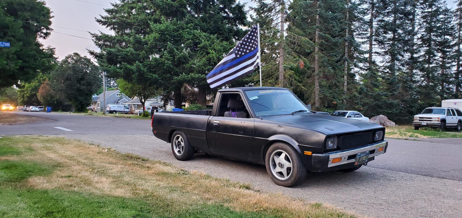

    Okay i have looked for a few months now for suspension for my max. I'm looking for a drop spindal for our trucks or if anyone knows if we can easily swap over to another spindal that will work. the 2.5 spring is not cutting it i need a 3 to 4 inch drop in the front since ill be doing a 4 link in the rear end. my plan is to auto cross the truck and it has to much body roll from the suspension i have now. Im also working on the 2nd 4g63 swap to the truck changing up a lot of things. so that is where im at please help if you can because i dont want to run on cut springs with limiting straps.

    20190704_204833.jpgpicture of how it sits now
    What about a coil over swap? I've looked at Mustang II front coil overs and to me it looks do-able. I think guys have used C10 (?) coil overs on Mitsu/Dodge minis and it will ride nicer than bump stops. The coil overs should be the ticket for autocross but it will obviously take some fab work to install them. Swap your front steering hub assemblies with Gen 2's and you can have vented discs with improved brake calipers - nut and bolt swap
