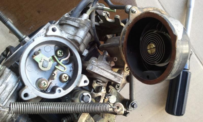

    hey, sup camoit , Today i did the cold choke adjustment you said, adjusted the fast idle cam lever to the second step from the manual and screwed the fast idle screw to tighten it down. Then I screwed the SAS 1,2,3 down and backed off 3.5 turns. I read some where that those are stock setting for the carb. I plugged the air hose going to the distributor to to check if the timing is off , then started the motor up and the truck ran with a high idle. Which is normal on a cold start, I waited to for the idle to go down and it never did. The truck warmed up and i adjusted the idle a/f mixture screw by screwing it it 8/16 at a time and waited 10 seconds on every adjustment. I ended up screw the screw almost all the way in, I found that out when i took count to see how many more turns i can get it all the way in(1.5 turn). Guess i had the a/f screw out too much.
    After that i adjust the SAS 1(idle control) by backing off until the engine idle lower. Did the timing and found out the crank pulley only has one(white) marking. Can i use this for setting the timing ? Well i hooked up the light and it was way off, so Turn the distributor clockwise towards the motor and the white mark on the crank went to 12degree BTDC (guesstimation). I'm starting to think it's timing now , guess im going to have to buy that equus timing light with the digital rpm display.

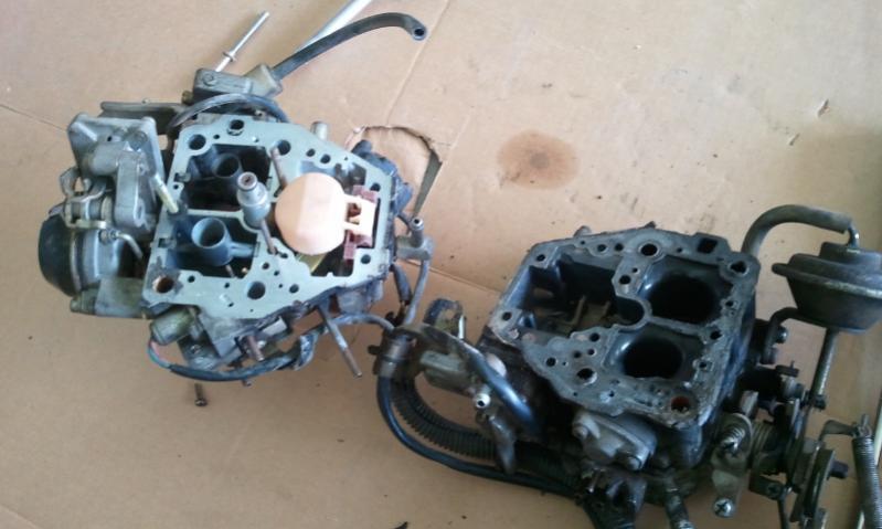

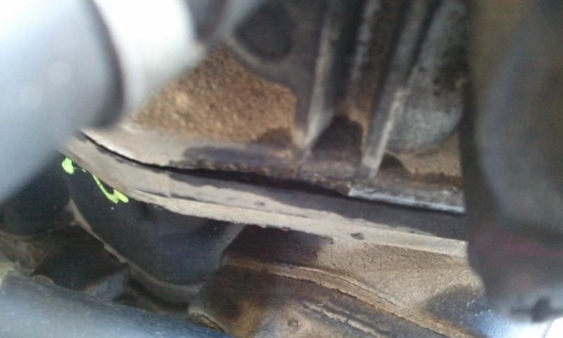

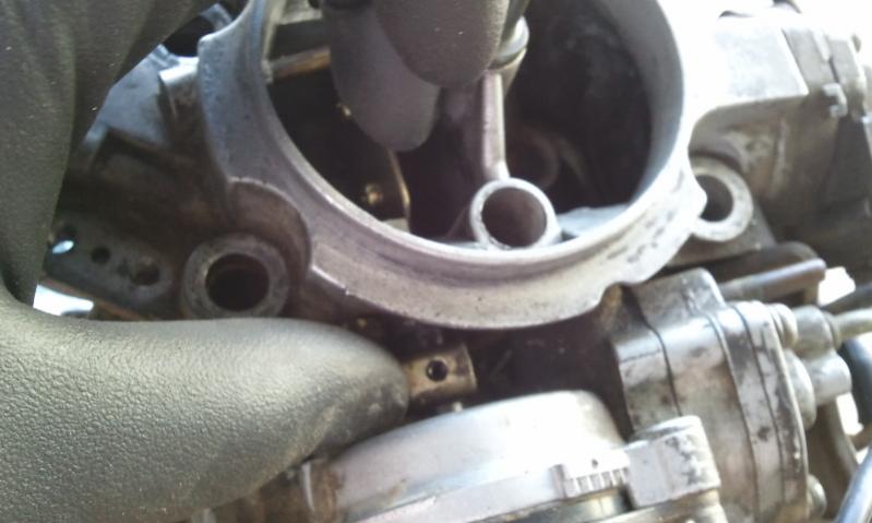

    Back again with more plms. I ended up buying a Carb rebuild kit($24@KRAGEN) for the pickNPull carb. I unscrewed the 5 screws on the top piece of the carburetor to install the gasket. In order to remove the top part of the carburetor i need to detach the electric choke. After that i put in the two new gasket and screwed everything back together. I tighten the screws as hard as i can, before and after i tighten the 4 carburetor bolts to the manifold.

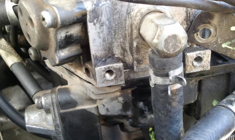

    i FOUND out there was a leak in my intake manifold(top stud on the right port towards the firewall). Found this out when i sprayed some starter fluid for the hell of it to see if it was the manifold that was leaking like everyone was saying about the truck. Ended up finding out the stud is stripped. I unscrew that stud out and place a bolt in the thread instead of the stud. Then i bought a new IM gasket with some gasket silcon to keep it seal. (torque 14ftlbs) It worked and the truck idles steady now.
    I installed the pickNpull Carburetor on the IM and plugged everything back up . started the truck and it idle really high. It was going from 3k rpm to 4k rpm and i was worried so i shut the motor off. I think when i took the electric choke arm off I might of messed up the cold idle adjustment. I just mess with the idle cam to lower the rpm and drove it around. I test drove it around town and on the hwy for about 30min. Everything seems to be working in order, Until the next day.
    I'm thinking the truck is running good now, Idling reaaaaaal smooth, right? (NOT) I'm going to take this baby fishing. Loaded all my fishing equipment and the cooler in the truck bed. Started the truck up and the battery is dead. I still haven't fix that short yet. haha I got a jump start from dad and it started idling high again. I just play with the idle cam and lower the rpm to where i can drive it. While driving i notice the rpm going to 1500, I kept driving and almost ran a stop a light so i slammed on the brake real hard to stop. The truck just shut off and wouldn't start back up, but it cranks. I push the truck to the side and let it cool down. Looking around the motor i notice the carburetor gasket has leak around the 4 screw area. DARN! Will i be able to make it back home? I did, Now im here typing on the laptop to help a future mighty max member with any similar plms they might run into that i have encounter today or through the whole time of owning a mighty max(carburetor)
    So now the question is , What can i do to seat the top carburetor part to now leak. Could it be warp, did i forget to install something, what's going on with the electric choke, and can i adjust it ? I still have the other carburetor , but the middle stud is broken off it for the air cleaner to screw onto .

    you probably over tightened the carb top screws. They aren't that tight to begin with. 10 inch pounds. s for the choke it is adjustable I think. Like a weber you can loosen the screws and rotate it so the spring doesn't push as hard and it comes off high idle faster.

    Never, ever, ever, use a silicone on a carb. It will turn into a runny gelatinous goo that will run into the carb or engine. A trick I learned a real long time ago is if you ever plan to remove a gasket later on in life you use a very tiny amount of anti seize AKA Never seize on it. Just a film is all I'm talking about. This way when you take it apart it stays in one peace and never sticks where you need to scrape it off the parts. I can't tell you how many times I pulled the weber base gasket, intake, and exhaust off and just reused it over and over. Hell Mopar_JA is running on them now. Water pump is OK, carb base to manifold is OK, Carb top gasket is OK, Head gasket A BIG NO NO, Exhaust a BIG YES. Intake OK, Oil areas like the pan or valve cover is silicone. There are differences between silicones. Not just the color, heat, or resistance. One big thing people overlook is how thick of a seal it makes. The package will tell you the gap it will seal. 1mm to 100mm or so. One of my favorite is LocTite 518 gasket eliminator. I use it around the timing chain cover. Great for areas of good metal to metal contact that does not move.
    You might get away with loosing the 5 screws and re-torquing them. You just need to remember what they felt like when removing them. You can check the top with a straight edge.

    camoit, when you say a thin flim on the gasket to save it from sticking to metal, do you mean a thin flim all over the gasket or just in certain area's ?
    I end up taking the carburetor apart to check the float and the pin. Everything looks okay to me, so now im thinking i shd just run double gasket since there's two gasket that came in the rebuild kit. what do you think, either that or im going put on a thin flim of permatex gray on the gasket around the float to try to stop the leak.

    Choke is easy to set, loosen the 3 screws,Flick the carb to wide open throttle (not running and when cold), turn the choke so it just closes, then fire up the truck with the choke closed. quickly do a rough set on the high idle screw. Turn truck off, let cool and try it again till you have it run at 1200-1300 rpm when if first fires up.then flick the excelarator to drop it out of high idle and adjust to low idle speed

    2 gaskets are ok. You coat it on both side of the gasket, the hole thing.

    antiseize%20006.jpgThanks for the tip Fordubishi, I will give it a try once i fix this broke thread in the intake manifold. So i went to harborfreight and bought a thread extractor to remove the m8x1.25 thread. With my lucky this is what happen. haha 2012-04-18 18.32.56.jpg
