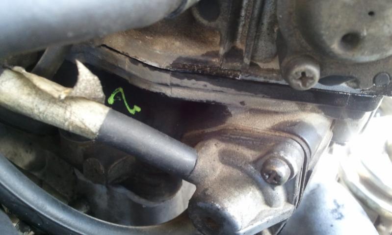

    Thanks for the quick reply camoit, I still haven't replace the pcv for a new one yet. I checked the vacuum on the pcv and it's sucking air to the carburetor so do i still need to buy a new one? I have checked the EGR without a vacuum pump, by lifting the diaphram up and pluggin the nipple to see if it hold suction. It does hold suction and when i let my finger off the nipple it release the diaphram back down. So im thinking it's in working order, right ? I don't think my EGR has a ding-a-Ling thing, haha
    I don't understand why it dies out right when it gets cold outside? I then have to hop out of the truck and screw the SAS 1 in about half to one full turn or more to keep the idle high to keep it from dying at stop lights at night. The thing it is it runs fine in the day time without adjustmenting the idle it's still a loping/erratic idle, but it doesn't die. I Think i can't get away from doing a rebuild on this carb, but not before i try everything i can to fix it first.
    You wouldn't happen to know the part nbr for the Thermovalve for the 1989 Mighty max SOHC 2.0 motor would you ? One of the nipple is cracked that i glued but coming a apart. The one that is connected to the EGR system.
    Also i do hear a large amount of vacuum suction coming from the secondary valve on the carb. Let me know if you need any photo's to identify some parts im refering to .
