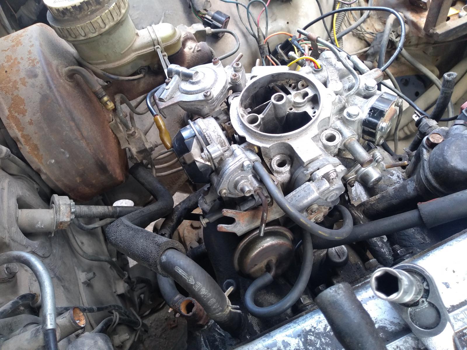

    Hey guys whats up new to the site. And i have a bit of a little issue with a little mighty max i just.got in the shop. This truck came in with a carb issue ..turns out the previous mechanic installed or tried to install a toyota aisan carb even made a steel plate to make it fit...very bad job...anywho i told my customer we need to get the original so we did. Now i have the issue of not knowing were all the vacuum lines go since they removed all of them. I have the tag were it shows you the diagram but i dont seam to get it. Any help will be apreciated or guidence.IMG_20200406_093538676.jpg

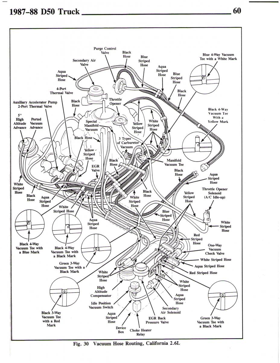

    Welcome to the site. Here's a post with the general hose routing:
    http://www.mightyram50.net/vbulletin...vacuum+diagram
    Plus here's another below that shows the color coding of the hoses and 'T's. It's for the 2.6L engine but most of it should apply to the 2.0L. If you find a difference, just ask.
    I believe some 'T's may have restricted ports, so if the owner didn't provide them, you may have to get them and the hoses from a wrecking yard. Good luck.
    Found the diagram for the California 2.0L, the lower one below.

    Wow! that has to be the most detailed vacuum diagram on the vacuum setup I have seen, sorry for the quick threadjack but what book is that from? my factory chrysler books only show the functional schematic showing how the system works. unfortunately it appears that the OP is in comifornia like me and almost all counties except 2 or 3 require smog inspections every 2 years with all counties requiring it upon transfer of ownership. I might have some extra vacuum line stuff if the OP cant find a complete vacuum harness although everything I have has came from the 2.6L and I am unfamiliar with the 2.0 so I may not have everything needed for it
    The diagrams are from a Chrysler training programs book I found on eBay some time ago.
    Only covers 1987 and 1988, but probably applies to 1989, too. Includes sections for the Colt, Colt Vista, (Ram) D50 Truck and Ram Raider. I've created a compressed Word Doc of the D50 Truck pages, but at 28mb it's too big to upload. I'll add it once I reduce it's size.

    Not yet... Here's the D50 (Ram 50) Truck section. Couldn't get the full PDF to upload so broke it into two parts in case size (or corruption) was the upload issue.
    1987-88 Mikuni Vacuum & Electical Fuel Control Systems_Part 1.pdf
    1987-88 Mikuni Vacuum & Electrical Fuel Control Systems_Part 2.pdf
    I skipped pages that were duplicate illustrations or ruled for notes only. Has very good illustrations, explanation of component functions plus some diagnostic tests - easier to follow and more thorough than the FSM. It's not perfect but is the best I've found.

    Hey guys. That diagram helps alot. Thank you very much. Im currently looking for the vacuum hoses or i might just make my own. Im down here in baja California. If anyone has them im willing to pay for shipping. Since im having a hard time looking for a donar truck or anywhere online. ...... Im pretty sure imma have an issue due to the t's
