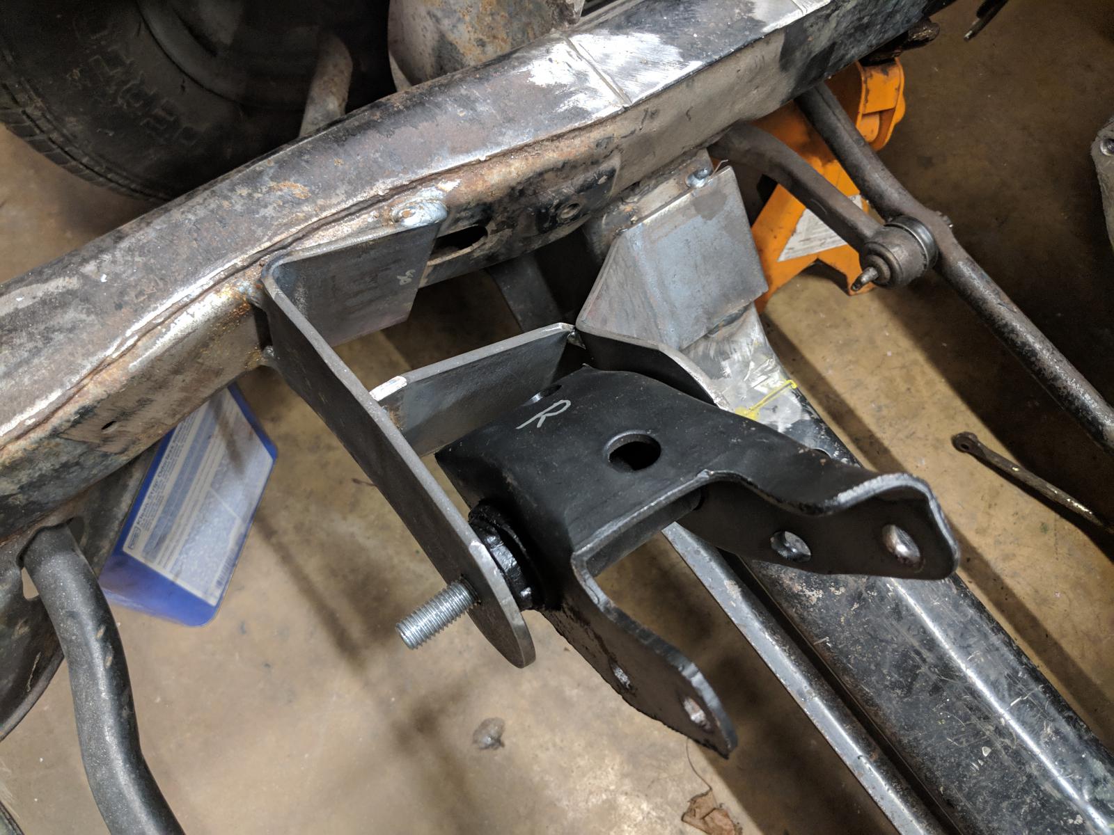

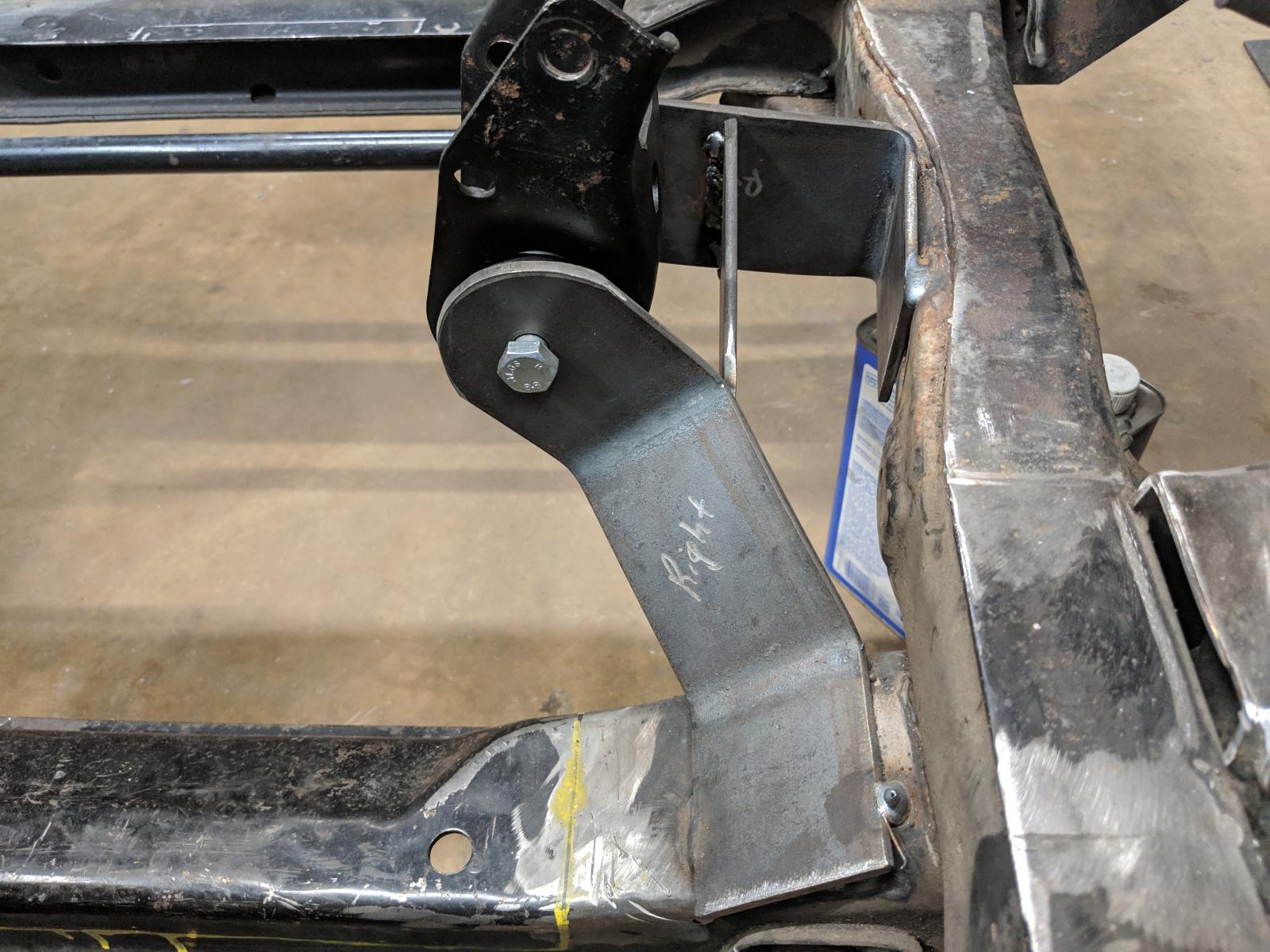

    Next was on to the motor mounts. I wanted to incorporate the stock mounts, as I want to go with a oem look, but could figure out a way to do it and keep it structurally sound. This is what I came up with. I'm not positive if this will be the final set, but I do like how it spreads out the the support of the engine to multiple points and hopefully aid in twisting the frame if the truck desides to hook up.

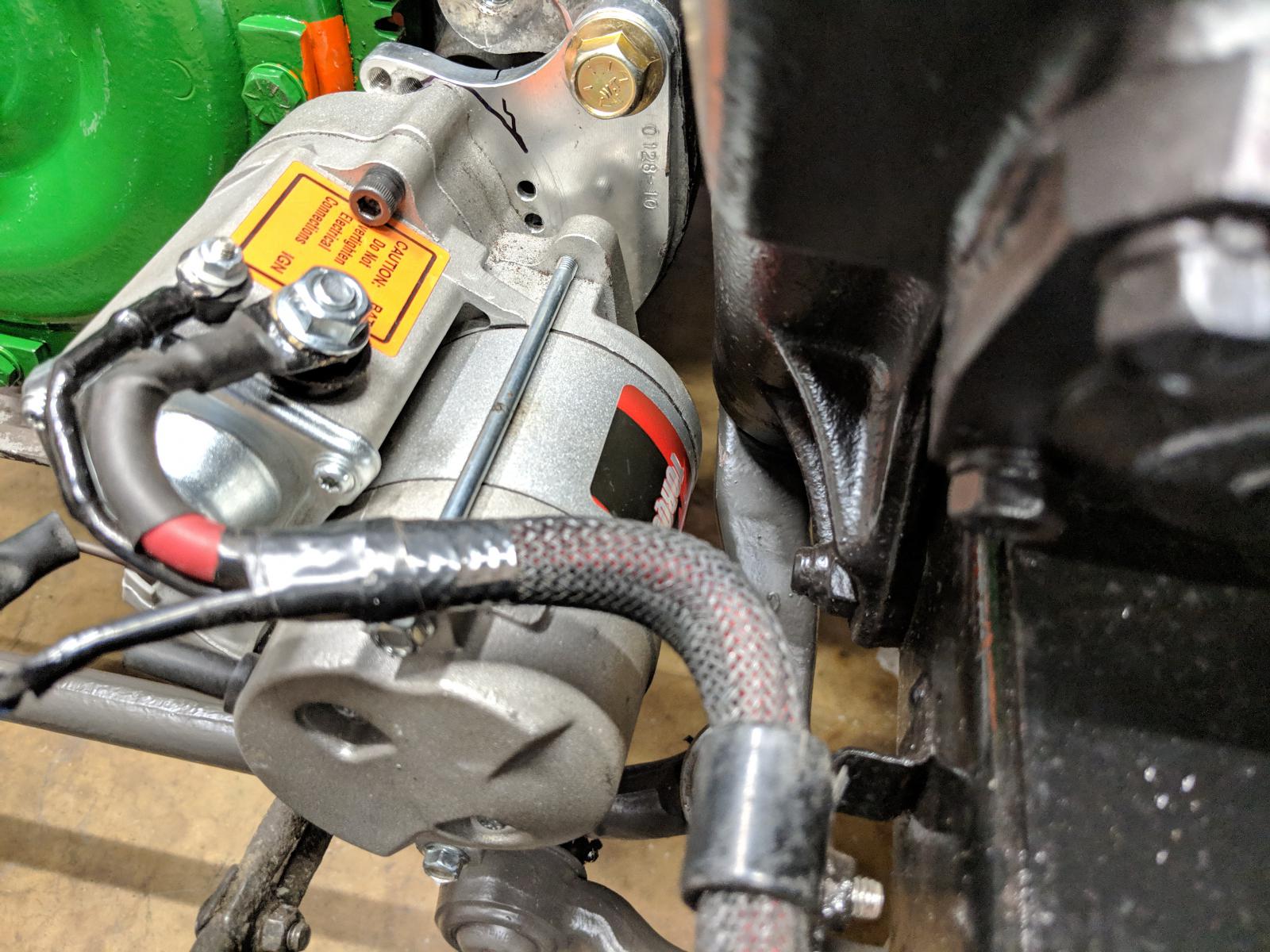

    The starter is a bit of concern, this is the biggest issue I've had with sliding the motor/trans back torwads the firewall. The stock magnum 5.9 starter hit the steering box. I picked up Powemaster XS that is clockable and it does clear the box and idler. It's close and I believe I won't have any issues when the engine torques. Worst case scenario I do have wiggle room to move the engine to to right of center.
    Powermaster XS Torque Starters 9513
    I did massage the firewall a bit where the transmission/engine bolts go. Everything cleaned just fine but I wanted some extra room to get fingers and and a wrench in there. I will smooth it out when body work starts.

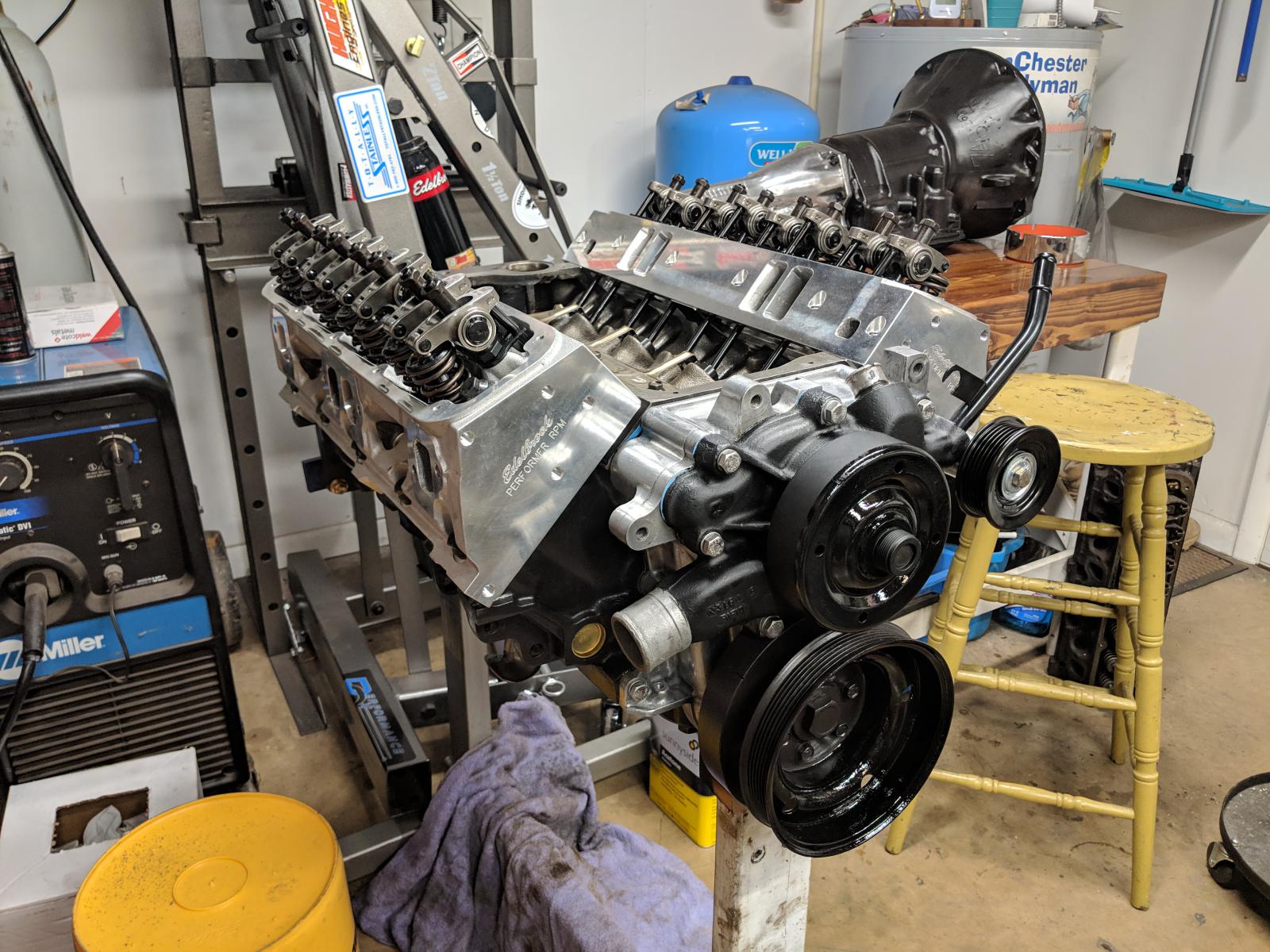

    A little about the engine, It's a 5.9 magnum out of a '98 truck. It has a balanced bottom end, flat top standard bore pistons. Fairly large street/strip cam from Hughes, aluminum heads running 10.7 to 1 compression. On paper it should produce 450hp/450torque. If anyone wants more specs I can provide more details.
    Trans is built 904 with 3500 stall.

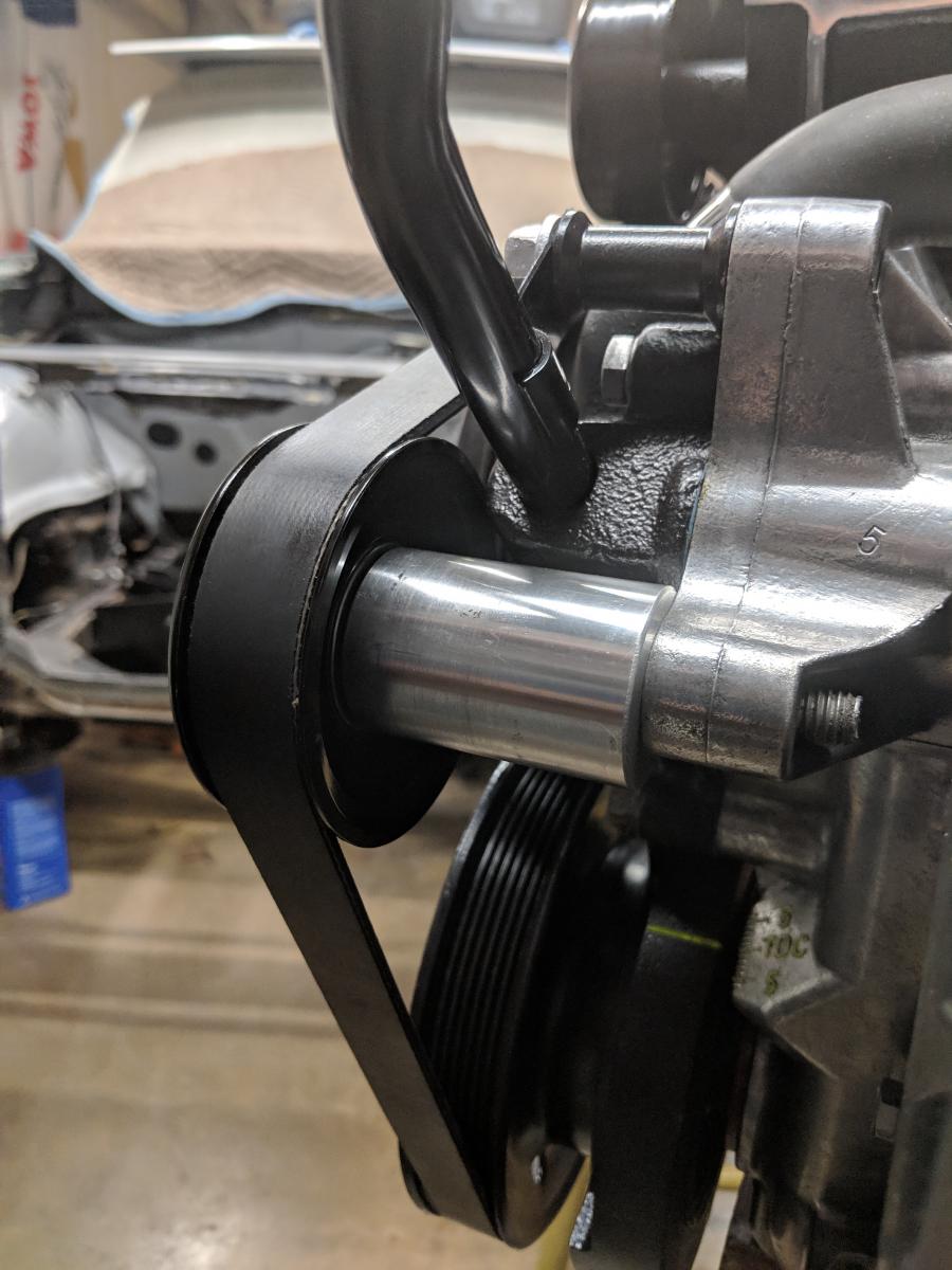

    As I mentioned before, I decided to keep the Magnum components on the front of the engine, mainly because of the shorter water pump. Originally I wanted to do a LA conversion, but this set up gives me that extra room and saved a few dollars as I bought a complete engine.
    I did modified the serpintine belt configuration as I deleted the A/C and power steering from the donor. I couldn't find any delete kits online so here is what I came up with.
    First thing I did and for those who know the magnums was to cut the huge accessory bracket in half and get rid of the a/c mount. I used a sawzall and leveled it off with some heavy grit sandpaper. After running down to finer grits the final polishing of the aluminum was done with a headlight restoration kit.
    I had to add an additional idler pulley to get sufficient surface area on the water pump pulley. The mount comes from 03 to 07 Ford f-350, but needs to be machined down 10mm. I picked mine up off eBay (Continental Elite 500008).
    I also had to down size the stock idler and used an ACDelco 38006 to make room for the belt circling back. By mistake I ordered 6 rib idler pullies and just went ahead and used them. The OEM belt is 7 rib. The belt that worked for me was a Bando 6PK1765
    This was a spacer I had laying around to mount the return line to the water pump.

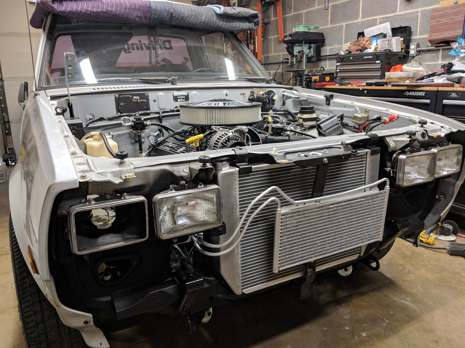

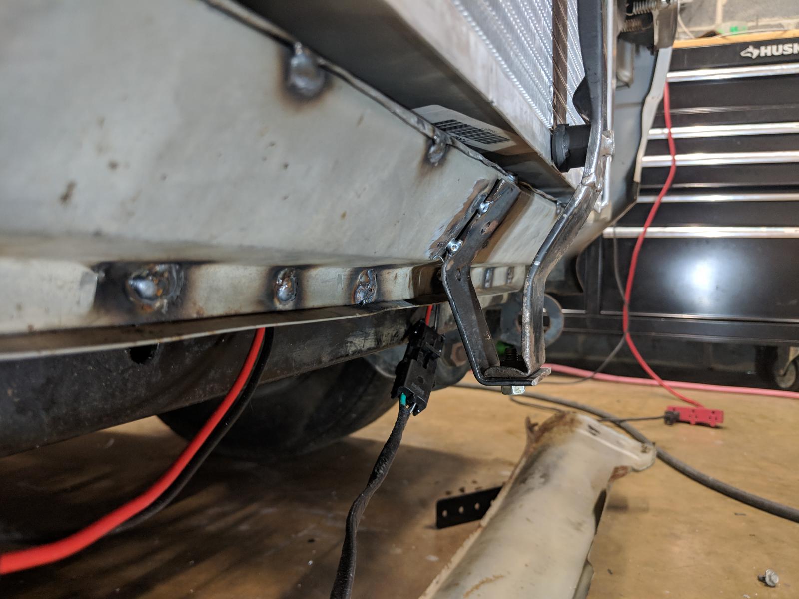

    Radiator is in place.
    Had to trim out the lower support to get it to fit. Radiator is from Griffin and measured 24" wide 16" tall and 3" deep.
    The center support is still be needed to support the hood latch and the spoiler, fabricated a new lower mount.
    The radiator cap will be unaccessible, so I will run a higher PSI cap on the radiator and add a inline filler to the top hose with the appropriate cap. I'm going to place a rubber strip ( old mud flap or something similar) under the radiator for a lower support. There are two upper supports that bolt into the upper support. I will line these with some adhesive back rubber for further cushioning.
    There is a aluminum shroud holding two 10" fans pulling air through the radiator. Power is coming in from a relay/fuse box I placed in the engine compartment. It also supplies power for the fuel pump, oil cooler fan and wire ran into the cabin for future use.
    It's a tight, but it all fits. I really wanted to run a fan shroud and keep the stock hood latch. Luckily I was able to accomplish that.

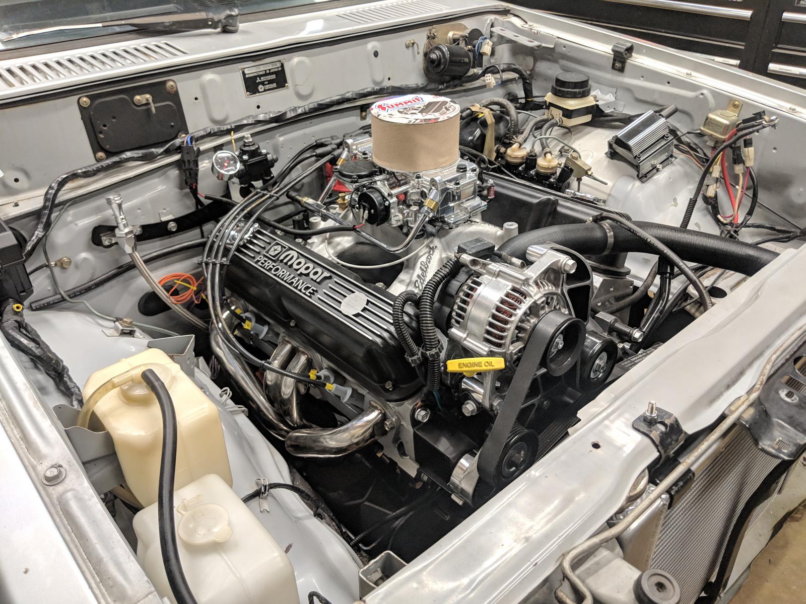

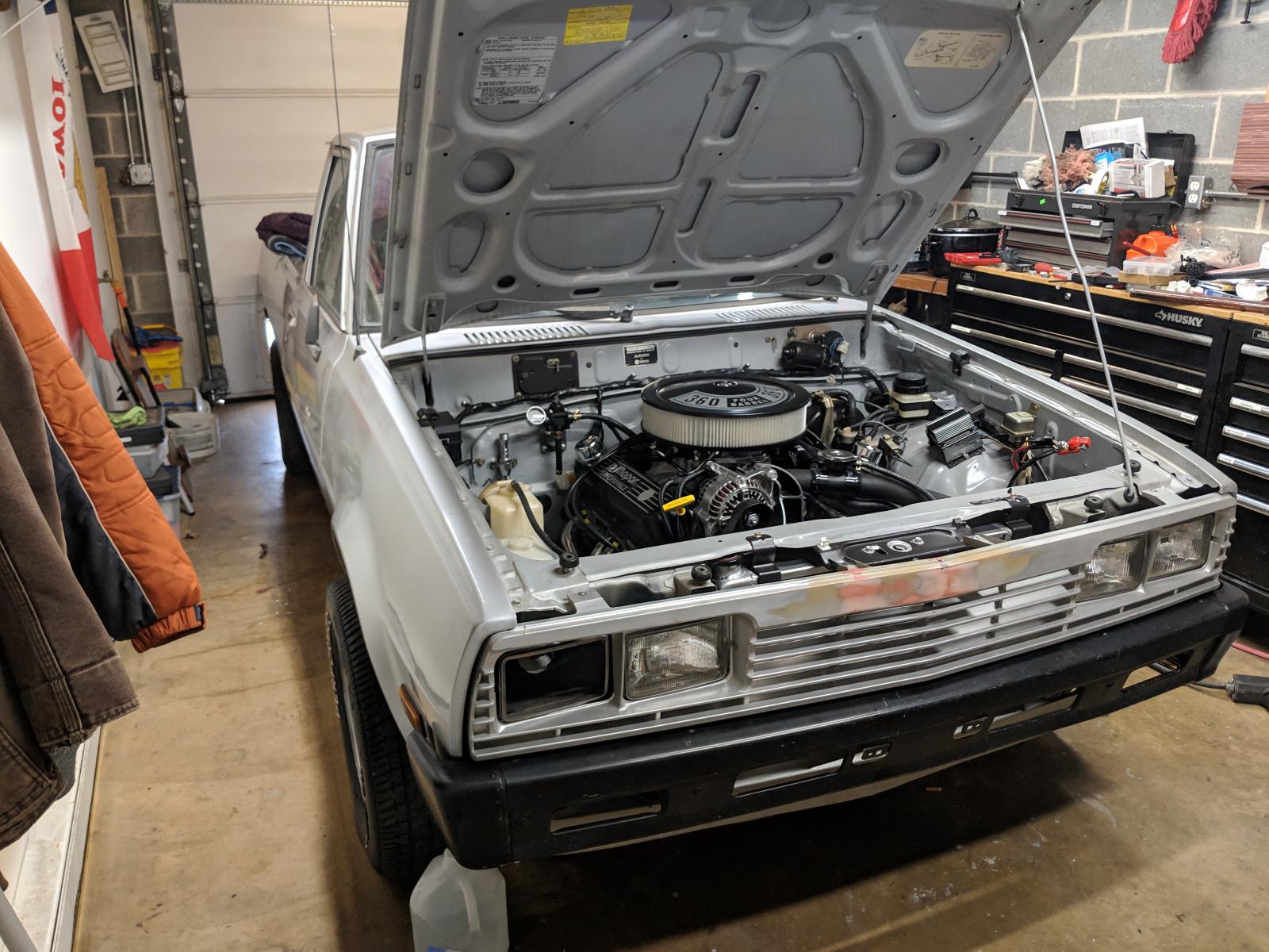

    Here are a couple more pictures of the engine bay. Almost there, still need to build the exhaust, hook up the fuel lines and make up a throttle cable and set up the kick down. The plan as of now, if all goes well with breaking in the engine, I will be taking down to speedway. After that the truck will be disassembled all the way down to the frame and body work will start.

    Excellent work, THX for taking the time to post & pic.
    Like it was meant to be in there from day 1. If you didn't know any better you'd think you were looking at the engine bay of a full size truck

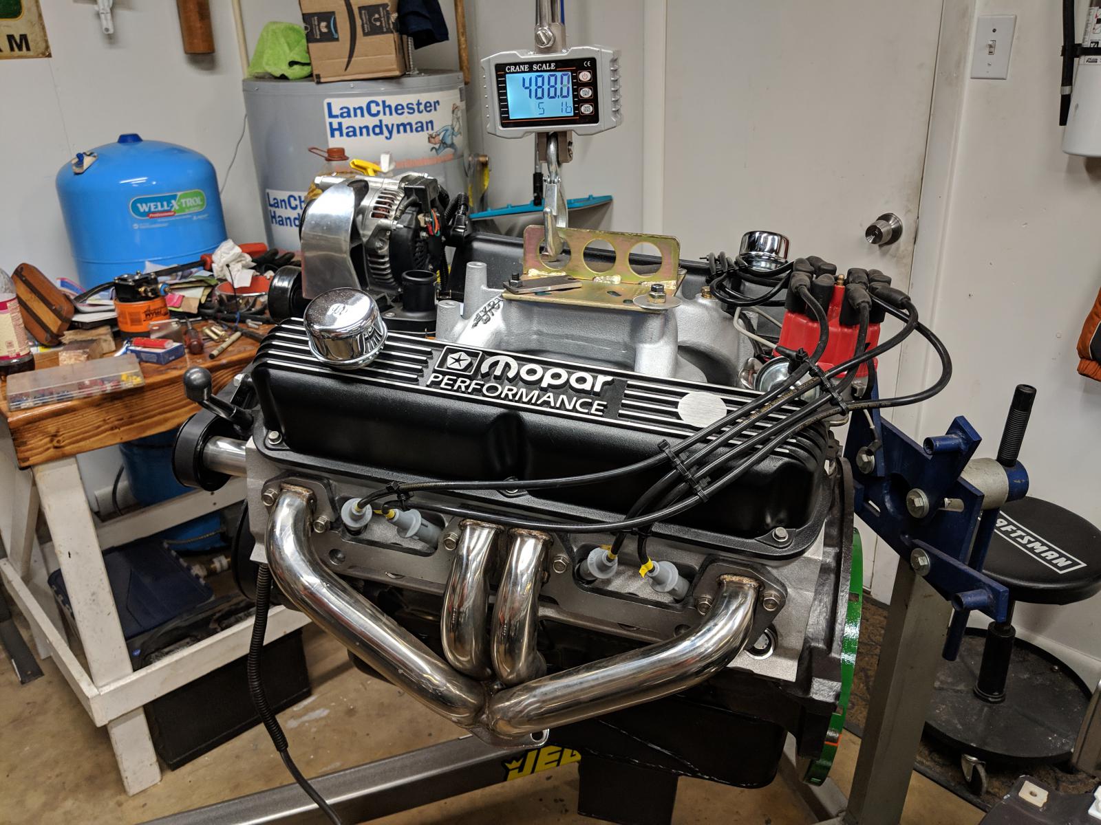

    Anyone know what the original 2.0 or 2.6 weighed? I weighed the full dressed 360 with 5.5 quarts of oil and it was 488 lbs. Pictured below.

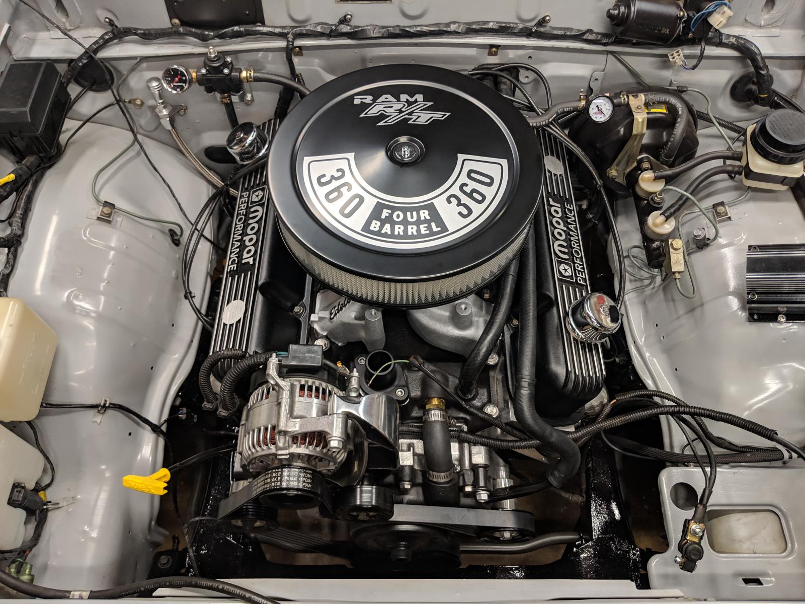

    Engine bay is all cleaned up waiting for the final insulation of it brand new 360.
    And finally and hopefully the final install.

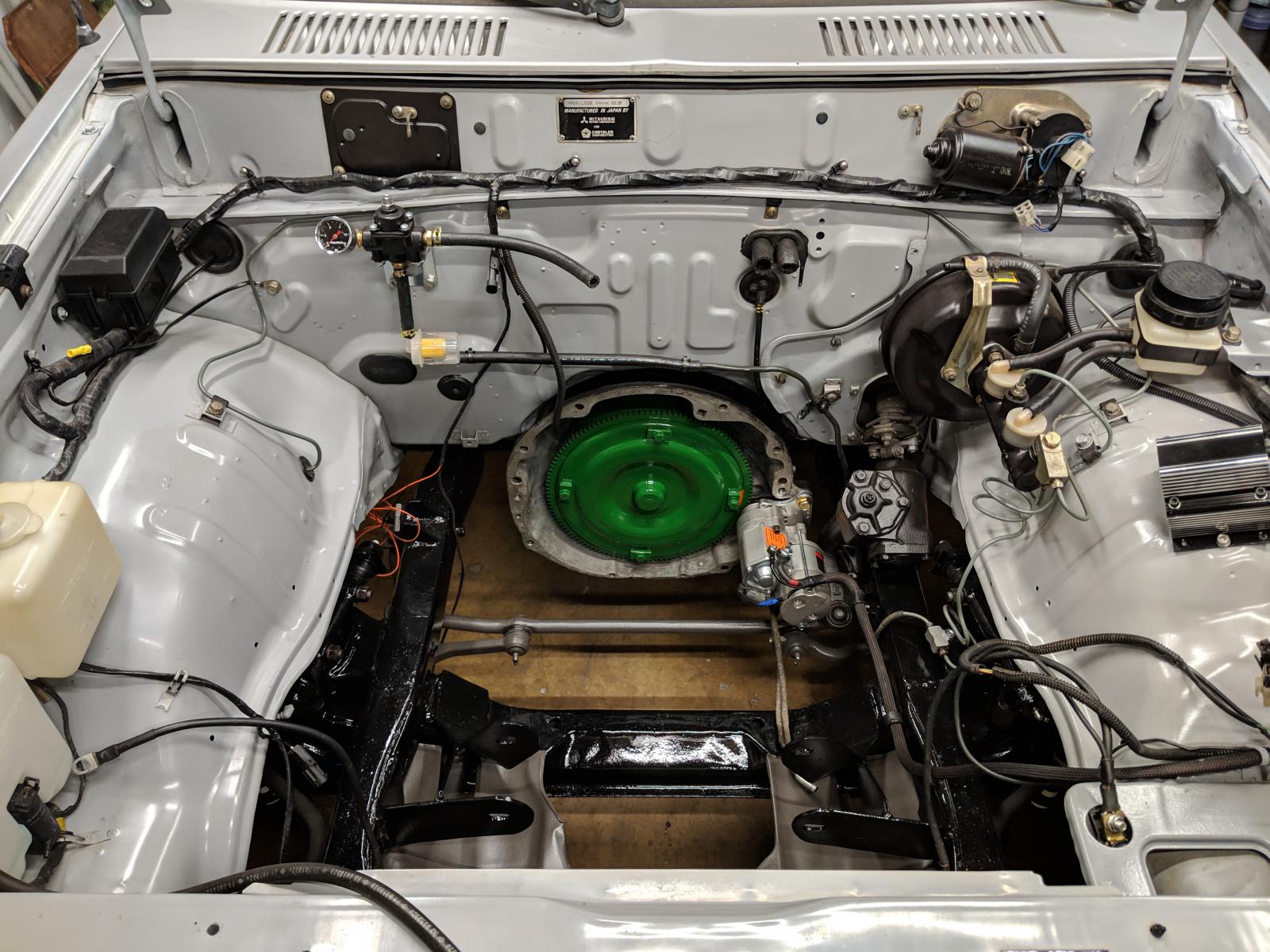

    I brought this up earlier and thought I would talk about it again being it was one of my biggest struggles. Most of the V8 swaps I've seen they install a 904 transmission in the stock location and start building from there as I did also to start off with. It just bugged me look at the space behind the engine to the firewall and figured adding a few hundred pounds to the front I wanted that weight to be as far back as I could get it. Getting the starter to clear the steering box was the biggest obstacle. After moving the transmission back 2" from the stock location I ended up offsetting the engine and transmission towards the passengers side a half inch from center. I figured this should help balance the truck as the fuel tank and battery are on the driver's side. Heres a picture of the clearance I have in the final install.

    Oh man that is a tight fit. Left hand drive vehicles have all kinds of different obstacles when doing a project build. I could easily bang a turbo'd 4G63 in my truck and not have to worry about an intake manifold hitting a brake booster or going V8 and not even think about the steering fouling something, but there's a bit of an art to planning around steering boxes and brakes etc working on a left hook. Top marks to you

    Everything fits!!! The hood even closed with a 1/4" clearance from the air cleaner. Building the exhaust is next.
