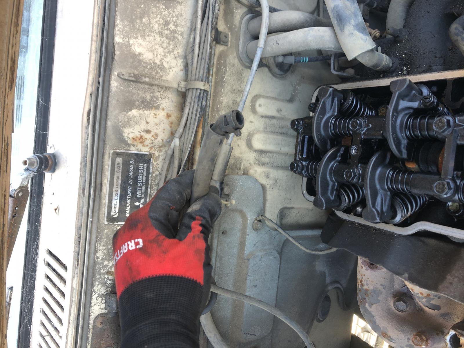

    Here’s a few pics of items I’m hung up on.
    2A985B7D-AFAA-40CE-82DC-0E57CF92409D.jpg3873C532-0030-4095-A85F-E6BB1A59F8AF.jpgD85E41B3-195E-426D-BB88-C120D5812C6E.jpg
    Image #1 - You have a bunch of breather hoses missing from the charcoal cannister and air cleaner. The hose that's bent over the side of the rocker cover should (?) connect to one of the inlets on the charcoal can and another should go from the rocker cover to the air cleaner body (somewhere on the side...?) and I think a third one goes back from the charcoal can to the barb on the air cleaner top cover.
    Image #2 - you are missing the PCV that is screwed into the rocker cover (it goes from the bridge between the intake runners on the manifold and pushes onto the 'positive crankacse ventilation' valve) There is a threaded hole where that small raised hump in the rocker cover is located.
    Image #3 - The connection looks suspiciously like a diagnostic socket for an EFI truck. The welded stand-off with the 2 captive threads - I dunno...

    Image 3 is the O2 sensor connector and holder clip and the stand-off with 2 holes is for a power steering reservoir if it had PS
    Mystery solved
