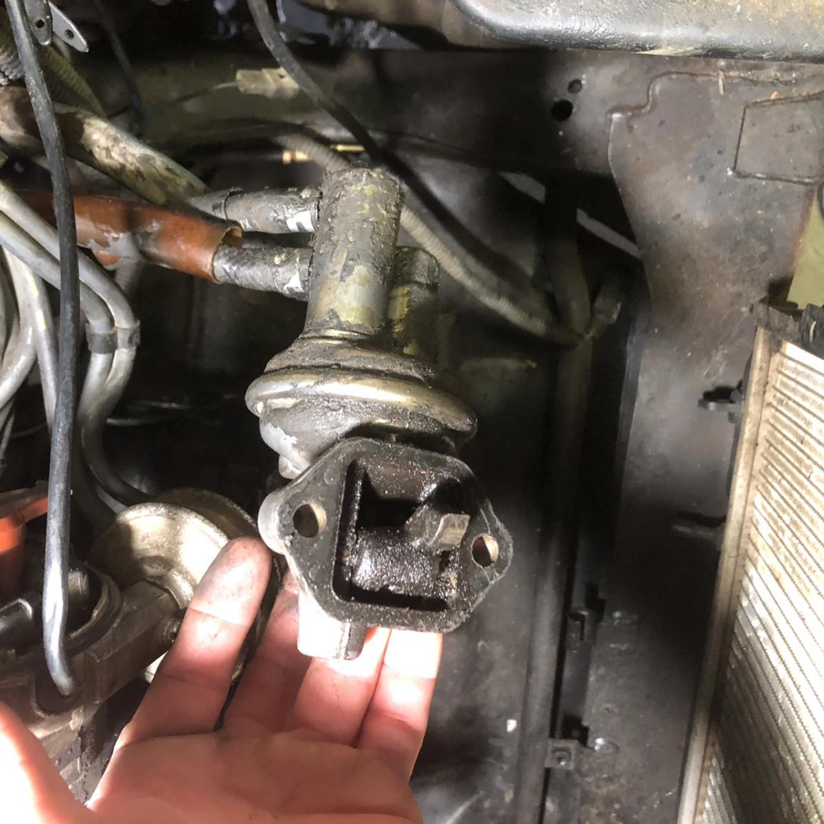

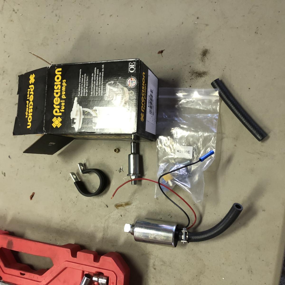

    I’m going with using an electric fuel pump. I ordered one seen in the photo. That should work right? Also what do I do with the obsolete mechanical fuel pump? How do I remove it from the closed system?
  2. #27
    10-29-2014
    1,263
    Earth, the Solar System
    You canbuy a piece to block it off or make one. I made one out of sheet metal and got some shorter bolts. Use a gasket. I also plugged off the return line in the engine bay.
  3. #28
    Got a feeling popular inline 6/V8's have aftermarket block off plates that will work for the pump delete...

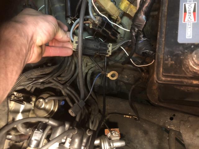

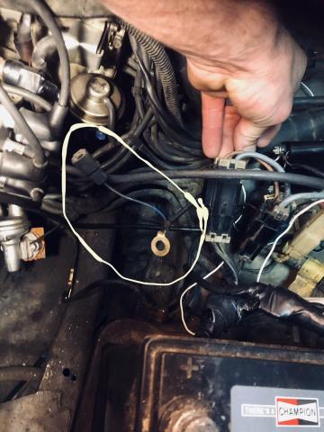

    I’m trying to figure out where this ground goes
  5. #30
    10-29-2014
    1,263
    Assuming you are talking about the brass O connector. Have you had the coil off its mount? That looks like it might be the wire that is grounded under one of the mount bolts on my 85. In that area there is a ground on the frame and the battery tray.

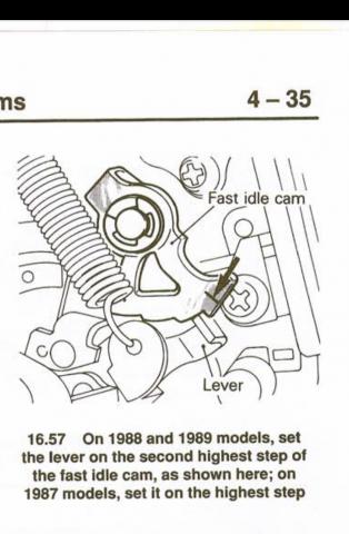

    also, my fast idle cam isn’t functioning properly. After adjusting the fast idle it doesn’t return to the set position.

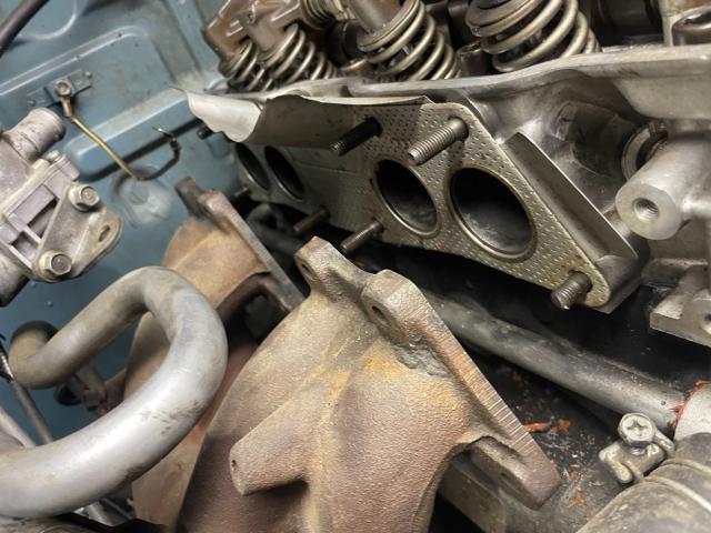

    Where can i find these exhaust manifold bolts?
    2 of mine are done.
  14. #39
    Look up metric exhaust manifold studs. Should be able to source them no problemo Pull a complete one out and measure it (they should be an M8 stud) 1G Talon, Lazer, Eagle, Eclipse etc will be a good place to start a search.

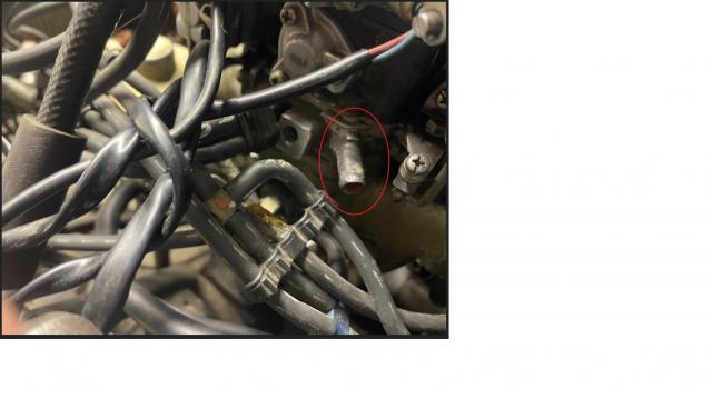

    im trying to figure out where this (coolant?) port goes to on the throttle body of the carburetor.
  16. #41
    03-06-2018
    635
    Tucson, AZ USA
    Quote Originally Posted by PrestigeWorldwide View Post
    IIRC, that goes to the coolant tee on the intake manifold which also feeds the heater.

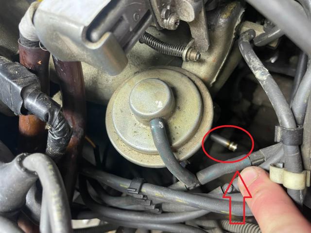

    one more
    this guy right here. seems like a hose goes here.
  18. #43
    04-01-2020
    25
    California
    thank you!
    one more
    Goes to the vacuum box

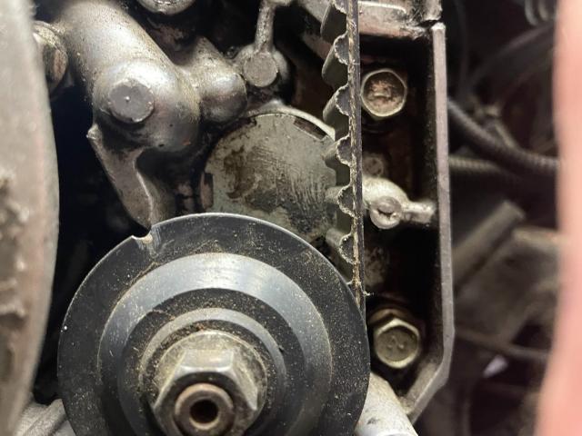

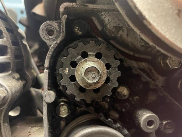

    Ive been obssessed with these timing marks, this is the best ive ever got them.

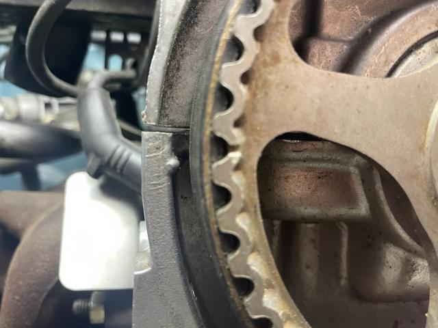

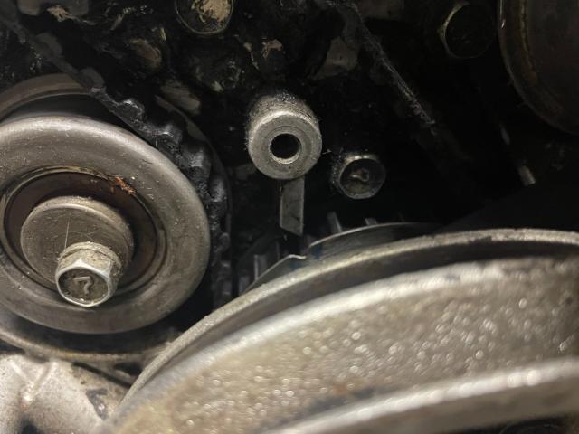

    I was beginning a timing belt guide that would have me remove a screw from the side of the block to the oil pump, and stick a flat head inside the hole to verify that the oil pump was timed correctly. But that screw was a flat head set screw that instantly became a job. Also, the cylinder header with cam came from a newer model D50. But TPDC should be the same on all models of upper cams right?
    The engine lurching during startup is concerning, timing feels off to me to. The upper cam wasn't in the greatest condition. I have not checked spark on plugs yet.
