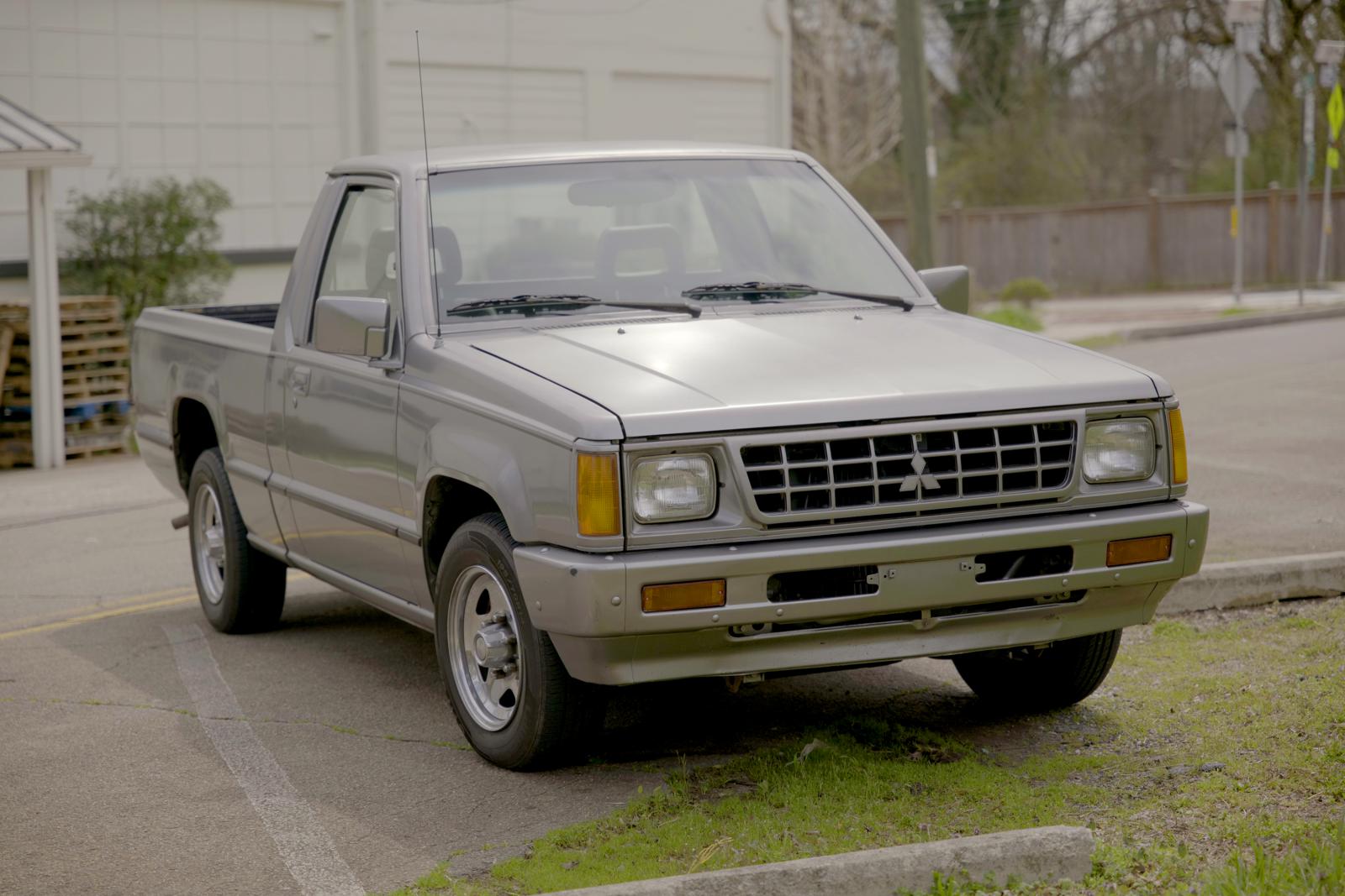

    Jrecee, welcome & thanks for posting pics of your straight truck, looks good You have a blank canvas to work with
    May I make a comment (without malice) as a senior citizen with poor eyesight & slow reaction time; it would be a challenge (for me) to see your truck on the road... Especially on overcast or cloudy days it blends into most backgrounds; I often miss seeing silver colored cars... My ex wife had a totalled silver colored 1994 Toyota Corolla; the guy that hit her said: "I didn't see you"... It would help me to see your truck if it had, tire shine, polished wheels, bright lights, racing graphics (any color other than silver) just saying, ok... I've started to make a habit of turning on my headlights because just driving scares me anymore; other drivers dart around so dang fast... Hope they see me..?

    Ha! I'm with you on that, my other car is orange. Normally I'd never buy one in this color but the price was right! It's growing on me.
