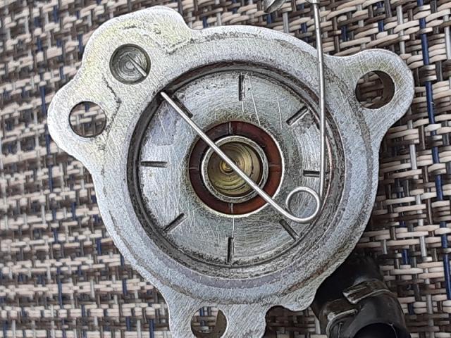

    CHOKE COVER DISASSEMBLY & FASTENER TYPE:
    (ALL 5 SCREWS ARE Tamper Proof Male Thread Metric M5 x 80) Tamper proof not required to reassemble choke cover; not sure why Mikuni used tamper proof fasteners on the choke cover piece... NOTICE THE MASSAGE MARKS FROM DREMEL GRINDING WHEEL TO MAKE A SCREWDRIVER SLOT TO REMOVE 3 steel TAMPER PROOF SCREWS & CUT OFF THE RIVET END OF 2 brass CENTER SCREWS...

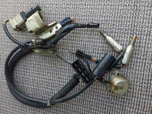

    Began testing the carburetor selenoids in my apt; one test is complete & the selenoid operates good, not sure if it will operate correctly in the truck... I will check if voltage is sent to the selenoids when the ignition key is turned to "ON" by probing the carburetor main harness connector pins with a DMM... Maybe the selenoids only receive power when the truck is running & receiving commands from the ECM 'n TPS..? Not sure if the FSM explains testing the selenoids on the truck or not; too lazy to read today...
    The Gen1 Mikuni carburetor has a throttle opener/dash pot with a large diaphragm attached to a rod that operates the throttle to prevent it's opening 'n closing too quickly... I searched to locate a source for buying another one but this part does not seem to be available... It would be great to find a seller with this part... All other parts with rubber diaphragms are available on ebay & parts stores but quantities won't last forever...

    Did some carby selenoid cleaning this morning, why is there a tiny little hole in the BVV selenoid guys..? Possibly to allow air to move into that little chamber as the diaphragm is pulled back by the selenoid (magnetic pull)..? FYI, only by cleaning did I discover there was a hole & it was plugged solid with hard brown crud... I'm sure if the rebuild carby works that my truck will go much faster now that it has another hole..!
