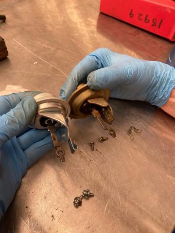

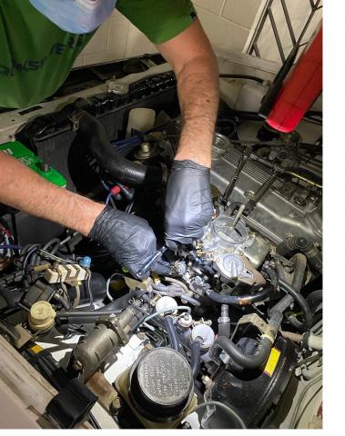

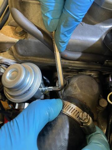

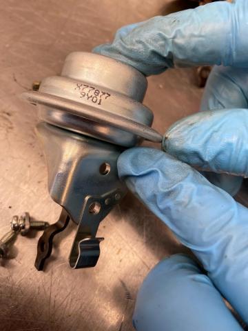

    UPDATE: The truck currently starts & runs good, idle speed a little high by 100 RPM or so (but not always?) ~ got my laptop fixed & can upload photos now ~ used laser tach, timing light & hand vacuum pump to discover a new problem, the distributor vacuum advance diaphragm began leaking, did not advance the ignition timing ~ tested the mechanical advance, it works ok...
    1) Replaced the dist vacuum advance actuator & tested vacuum advance, works good...
    2) Changed engine oil twice & added polymer-ester additive to prolong life of flat tappets ~ no more noisy tappets
    NOTE: Telltale sign of a vacuum leak on my truck is the brake pedal ~ the power feel of power brakes is deminished enuff to feel in the foot...

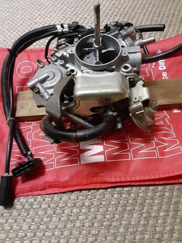

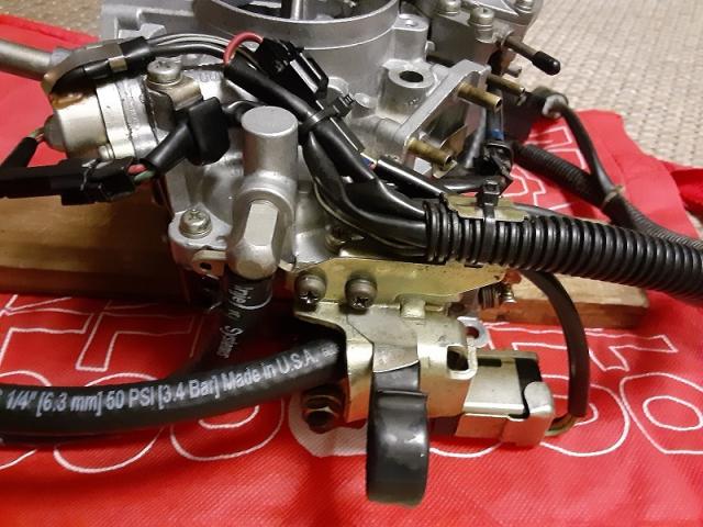

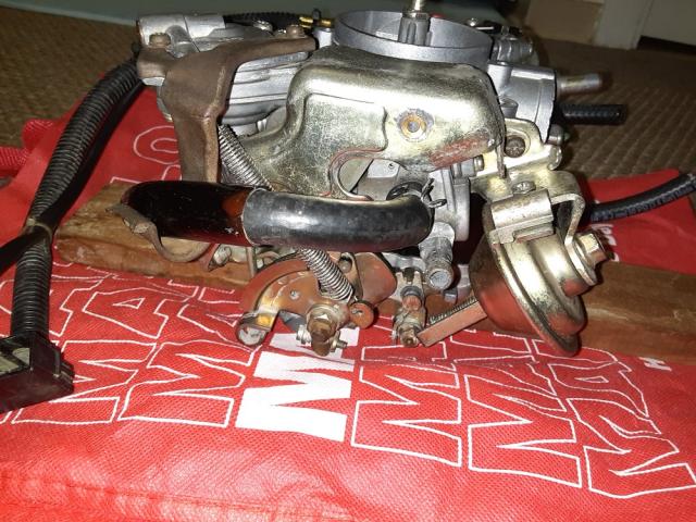

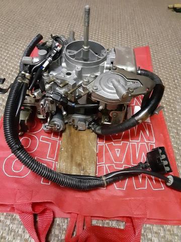

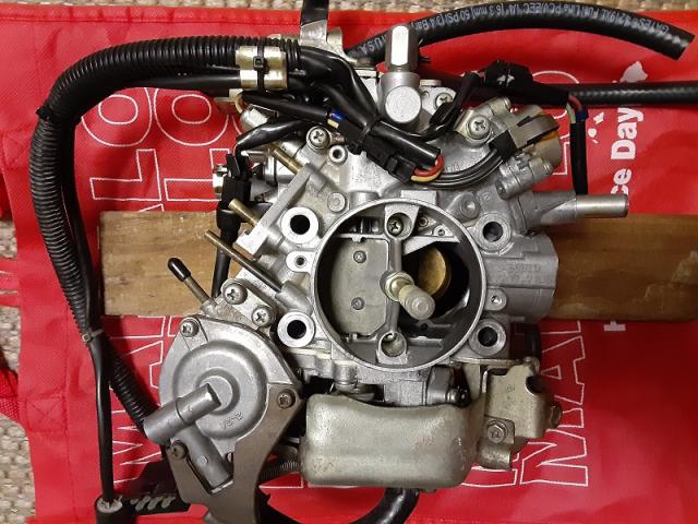

    REBUILT MIKUNI PHOTOS
    NOTICE ANYTHING MISSING ON THIS CARBURETOR PHOTO (?) LUCKILY FIXED IT BEFORE CONNECTING FUEL & COOLANT :^) COULD NOT GET THE AIR CLEANER TO FIT ON THE CARB & WHEN I WENT TO GET THE MISSING PLATE & GASKET, NOTICED I ALSO FORGOT TO INSTALL BOTH THROTTLE VENTURIES OMG..!
    NEW VACUUM ADVANCE PHOTOS
