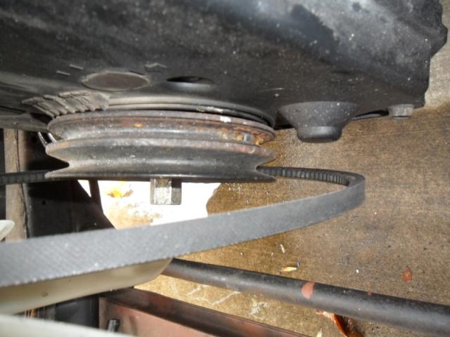

    1,575
    REBUILT MIKUNI INSTALLED
    Engine cranked but no pop sputter or trying to start -- I hope the battery will have enuff omph left to try with starting fluid... I remember mechanics getting this truck running when we 1st bought it -- sprayed starter fluid & cranked a bunch of times before it finally began to fire... I think they even dumped some gas in the carb...
  17. #117
    1,575
    Well there's your problem.
    It is meant to be a light coat. Using it on plugs if there is too much it can cause the plug wire to pop off the plug from fully seated and ditto the distributor cap. Yes it happened to me.
    You're right on both counts -- it is non conductive & directions say use sparingly -- I thought dielectric grease would improve a connection but it does just the opposite... I injected a pea size amount of it into the spark plug boot BUT I'm going back in to remove it to achieve a better electrical connection to the spark plugs...
  18. #118
    1,575
    Rebuilt Mikuni installed but truck won't start or act like it wants to start... Used tablespoon of gas or 3 seconds spray of starter fluid one or the other 8 good tries..! Battery cranking good & good spark at the plugs... Eng front cover has marks 10BTDC 0 10ATDC -- no mark or notch on crankshaft pullys... Will have to remove # 1 spark plug & find TDC on compression stroke... <--- how is that done without removing rocker arm cover..? Thumb on sparkplug hole or buy a compression gauge..? Truck not running or started for 3 months, maybe it needs oil fog sprayed into the cylinders not just for lube but to ensure having compression..?
    We will be very sad to let this truck go... But we need transportation not a never ending class in auto mechanics with us supplying the school with tools...
  19. #119
    10-29-2014
    1,286
    Earth, the Solar System
    The mark on the balancer is one line full width, indented. You might be able to feel it if you cannot see it. I mark mine with a silver sharpie when I need to see it. Is gas pumping through the carb?
    To find TDC I use a tissue to watch as I turn for the compression stroke. It will blow the tissue, then I put a screwdriver in the plug hole and hold it loosely. When the piston gets to the top it will start to go down and you will feel it. There ya go.
  20. #120
    1,575
    Thank you 85Ram50 the tissue idea is trick, I don't think my 3/8 socket set will fit the crank bolt, so I either learn how to use a screwdriver to short the starter selenoid wires or use the ignition key -- I don't plan on spending $25.00 for O'Reilly to sell me a remote starter switch... OReillys is charging my battery now, the battery has plenty power this is just extra step -- I don't know if the fuel pump has gotten fuel to the carb -- I thought after checking ign timing that I would remove the carb fuel supply hose from the fuel pump barb -- I rented a compression tester from O'Reillys and bought a spray can of fogger fogging oil -- the cylinders could use some lube I bet & as well as checking ign timing might as well do a compression test -- there might be more to this than a previously flooding carb -- ? -- if the balancer has a line to mark TDC I will be super suprised nothing there
  21. #121
    10-29-2014
    1,286
    I think the crank is a 17mm. If you are removing the plugs any wrench that opens big enough will work, it turns pretty easily with the plugs out. My 3/8 drive turns it easily. A remote starter or bumping the starter will move it to far too fast. I should have stated TDC Compression stroke, as there is the exhaust stroke 180 out that will feel the same so making sure the rotor is pointing at #1 helps. It ran so you could not have been too far out when you parked it. I thought you just wanted to improve annoying things it did because of the carb being old. You need more then a few teaspoons of gas. At least use tablespoons.
  22. #122
    I always just put the truck in reverse gear and released the parking brake. Then pushed on the bumper with my knee to rotate the engine over.
    if the truck has a belt. The timing mark is below the flat of the head. Many people get it off 1 tooth because they go off the flat of the head.
  23. #123
    1,575
    I need these details, thanks guys... The timing mark I'm searching for is on the fan belt pulley somwhere, this truck has two V belts alt & pwr steering -- I'm gonna look at the pulley lip closest to the engine (Dr. geezer's advice)
    Darn, my resident apt mgr just texted me if I got the truck running yet or if I wanted to sell it..? Howz that for moral support..?
    Going now to get my fully charged Interstate battery -- O'Reillys charged it for free... They have a $26.00 + tax remote start switch -- now I'm confused if it will help me spin the engine with spark plugs removed to inject the fogging oil I bought yesterday -- all this extra stuff is beyond just starting the engine after a carb rebuild BECAUSE before we got it parked back at the apt Vernon could not get it to start & neither could Sam @ his Windward Muffler repair shop -- not any responce even with good spark starter fluid & gas stopped on carb -- something is amiss -- Dr. geezer has a few more things for me to check as well
    ALOHA George
    Ign timing check
    Spark plug wire routing check
    Compression test
    Test each spark plug separately for firing
    Check proper fuel line connect to carb
    Check gas tank level -- dash gauge reads 3/8
    Remove fuel pump to carb inlet hose to check if fuel pump is pumping gas
    Yada Yada Yada
    What then if still NO RESPONCE when trying to start..? Just fishing for more ideas that hopefully won' t be needed in the near future...
  24. #124
    09-26-2014
    495
    Ca
    1993 Dodge Ram 50
    xboxrox,
    Remove the fuel inlet line to the carburetor, fab up a remote reservoir & hose, attach to inlet--- fill the float bowl ---
    Pump pedal thrice ,start & report back.
    Thx
  25. #125
    10-29-2014
    1,286
    I misled you Xbox. I was picturing my Dakota when I told you about the mark. Here is a picture of mine. The white spot is the notch on the inner pulley closest to the timing belt cover. It is a notch so you should be able to feel it.
