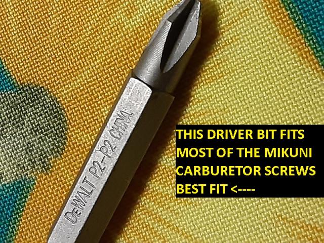

CHOKE COVER DISASSEMBLY & FASTENER TYPE:
(ALL 5 SCREWS ARE Tamper Proof Male Thread Metric M5 x 80) Tamper proof not required to reassemble choke cover; not sure why Mikuni used tamper proof fasteners on the choke cover piece... NOTICE THE MASSAGE MARKS FROM DREMEL GRINDING WHEEL TO MAKE A SCREWDRIVER SLOT TO REMOVE 3 steel TAMPER PROOF SCREWS & CUT OFF THE RIVET END OF 2 brass CENTER SCREWS...
