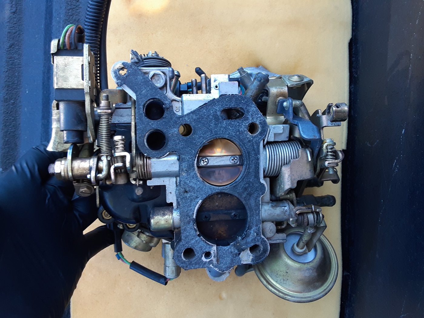

    ----------- (1985 Mikuni PicknPull J/Y) ------------ ---------- (Original 1986 Mikuni) -----------
    Which one do ya think had the bad secondary throttle actuator..? Why ya think so..?
  4. #54
    Hmm. Good question. A badly fouled secondary throttle butterfly and a sketchy looking primary on contestant #2 HINT HINT
  5. #55
    1,575
    THAT'S CORRECT the 1986 carby gave the truck much less power than contestant # 1

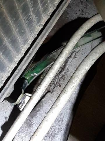

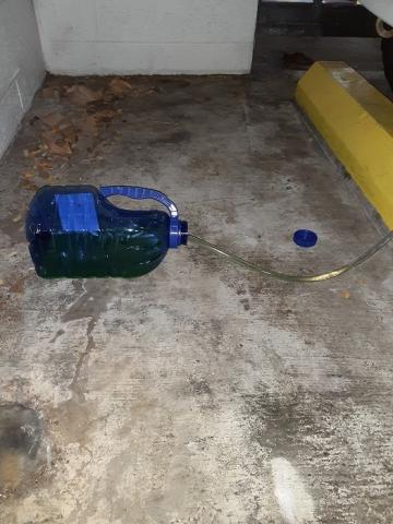

    PROGRESS ~ Remove Carburetor: (finally working on doing it ~ towards it...)
    1) Disconnect battery, done neg side anyway
    2) Drain coolant, done one gallon, should be enough to lower coolant level below the intake manifold PHOTOS BELOW
    3) Remove air cleaner, pending
    4) Disconnect throttle cable, pending
    5) etc... pending
    My original Mikuni is in my apartment looking like a 500 piece puzzle ~ a PicknPull Mikuni is on the truck (but not for a lot longer)
    COOLANT DRAIN PHOTOS

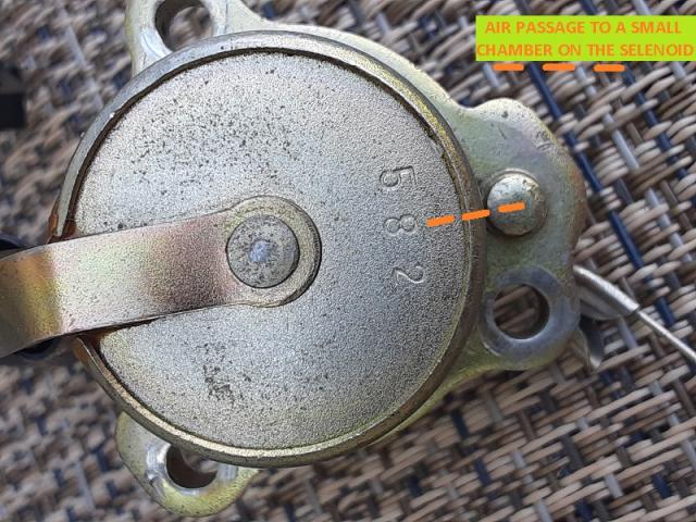

    Did some carby selenoid cleaning this morning, why is there a tiny little hole in the BVV selenoid guys..? Possibly to allow air to move into that little chamber as the diaphragm is pulled back by the selenoid (magnetic pull)..? FYI, only by cleaning did I discover there was a hole & it was plugged solid with hard brown crud... I'm sure if the rebuild carby works that my truck will go much faster now that it has another hole..!

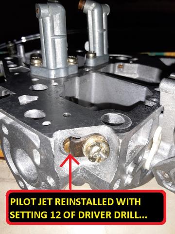

    Made some progress on the Mikuni rebuild this morning, delay, delay... The nuclear navy taught me that "STOP IS GOOD PROGRESS" [it's better than guessing] and it just came into play... I tried using a 12mm combo wrench to remove the carb's fuel inlet nipple because I thought like all the other threaded fittings, it's O ring would need replacing... Perhaps not..!?! Maybe it does not have an O ring ~ maybe it's a pipe thread connection..? So, I made a command decision to STOP [stop guessing & get some real answers from my friends here at MightyRam50...] The real reason I stopped was because it will require a great deal of torque force to remove that fitting; more than my one old hand X 3" wrench length could muster... an I don't wanna break anything + I don't have a vice, yada, yada...
    WHY CANCEL THIS STEP in the rebuild (?)
    1) The nipple is on there very tight (might break sumpin removing it)
    2) The nipple never leaked (before ultrasonic cleaning in boiling water) and later on the truck, there is easy access & the carb is held solidly
    3) If it ain't broke don't fix it (same goes for choke, wax pellet, throttle butterfly blades & throttle shafts...)
    4) STOP guessing & get real answers before proceeding
    5) A good Nuke is always able to stop a job one way or another much like the P.O. or eBay

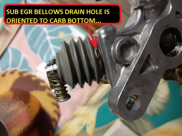

    Reassembly Photos
  20. #70
    1,575
    REASSEMBLY PHOTOS II
    LESSONS LEARNED SINCE LAST POST:
    <---- NOT GOOD FOR CARB REBUILDING..!
    1) BICYCLE SHOPS CARRY SMALL INDIVIDUAL STEEL BALL BEARINGS (LOST THE EGR BALL BEARING ~ MY LOCAL BIKE SHOP HAD THE 1/8" BALL NO ONE ELSE HAD EM THAT SMALL)
    2) EXFOLIATION HAPPENS TO METALS WASHED IN WATER SOLUTIONS
    3) LUBRICANTS ARE NEEDED TO REMEDY THE EFFECTS OF EXFOLIATION

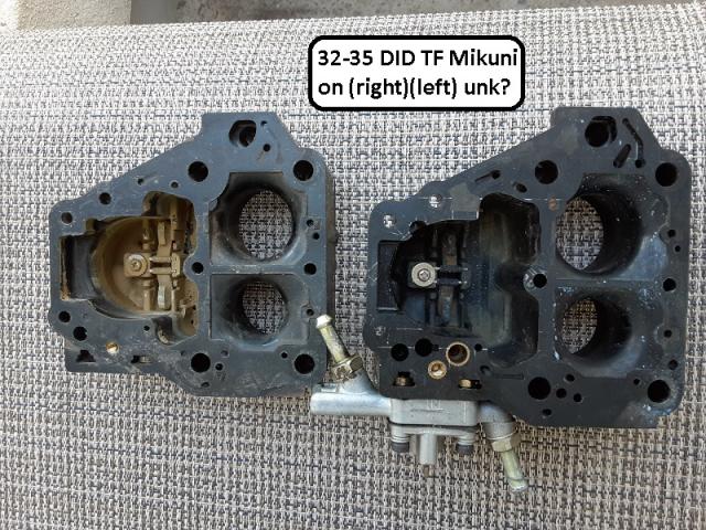

    My original 1986 Mikuni 32-35 DID TF has the accelerator pump still attached -- it is a California emissions feedback carb with O2 sensor... Not sure what version the other Mikuni but hoping the 1985 carby on the truck has a matching phenolic body -- do you see any differences in these two carb bodies? Will try uploading a cell phone photo:
    The 1985 carburetor arrived & does have the same phenolic throttle body as my 1986 Mikuni
  22. #72
    1,575
    Uploading a photo from cell phone (previous post) resulted in a link to the photo but not a ready to see photo... Here are the photos resized with MSFT Paint & uploaded with a laptop PC:
    As a result of the differences in the photos above; the Mikuni rebuild project will require removing the carby on the truck & seeing if it has a matching phenolic fuel bowl/throttle body/center section... Awaiting a set of hose pinch clamps from Harbor Freight to arrive before removing the J/Y flooding prone carb... The truck has new ignition module (in the distributor) new dist cap, new dist rotor, new spark plug wires, new coil, new spark plugs... Ignition module gap not checked by me, a local shop did that install, hope they gapped it correctly..? Ignition timing never checked by me, a local mechanic friend (Vernon) did it by ear... If the truck runs again, I may purchase a timing light & Tachometer...

    I see a lot of extra drill holes. I would put on an early first gen all metal one and try it. 90% of the smog tech's don't know anything about carbs.
    Never mind you have feedback. Your stuck with the BS.
  24. #74
    The non Cali carb doesn't have the fuel shut off gallery next to the accelerator pump/fuel bowl. A lot of the air galleries appear to be smaller diameter too but that may only be as a result of the picture angle. The early resin body carbs didn't have a lot of air gallery control solenoids (only one IIRC) so the extra galleries are probably feeds to those air circuits.
  25. #75
    1,575
    Thanks for that feedback camoit & geezer ~ you must know I love all feedback including Mitsubishi's & Mikuni's & California's... Thank you member 4cylinders for sending me that carburetor simply for the price of shipping... There is a 4 digit letter/number in white letters on my 86 Calif phenolic body but only one white digit is partially visible on the unk # donated phenolic body... There is a big Wasp drinking from my window A/C out on the lanai where both those phenolic bodies are stored... Otherwise, I would run out there right now with a magnifier and check the #s again... No need really, even with the gasket in place, I can see several differences as you guys mentioned... This is a good learning experience for me & hopefully other feedback lovers :^) Last time I checked, Shamrock Wrecking yard in Ridgecrest, CA had three used Calif Mikuni carbs...
    As time goes by, I understand more clearly how given the need for a complete rebuild on an OEM Mikuni or installing a new Weber compares... I think a main benefit of the Weber is simplicity and Parts ARE more readily available... Now if there was a similar fix for my leaking steering gear box that a seal replacement did'nt fix, I would like to know about it (does Weber make new steering gear boxes too..?)
