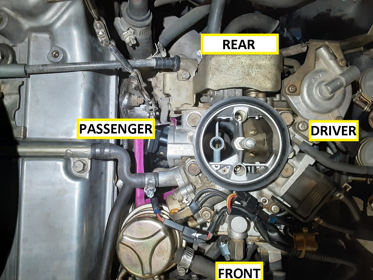

    This thread is about me & (you my helpers) trying to fix my 1986 Dodge Power Ram50 (32-35DID TF207 7Z08 Mikuni carburetor, California emissions)... It got broke trying to replace a leaking accelerator pump diaphram (cracked off a "L" shaped sliver chunk of the phenolic resin mixing body machined surface under the accelerator pump cover... It now leaks gas big time..! Truck sits...

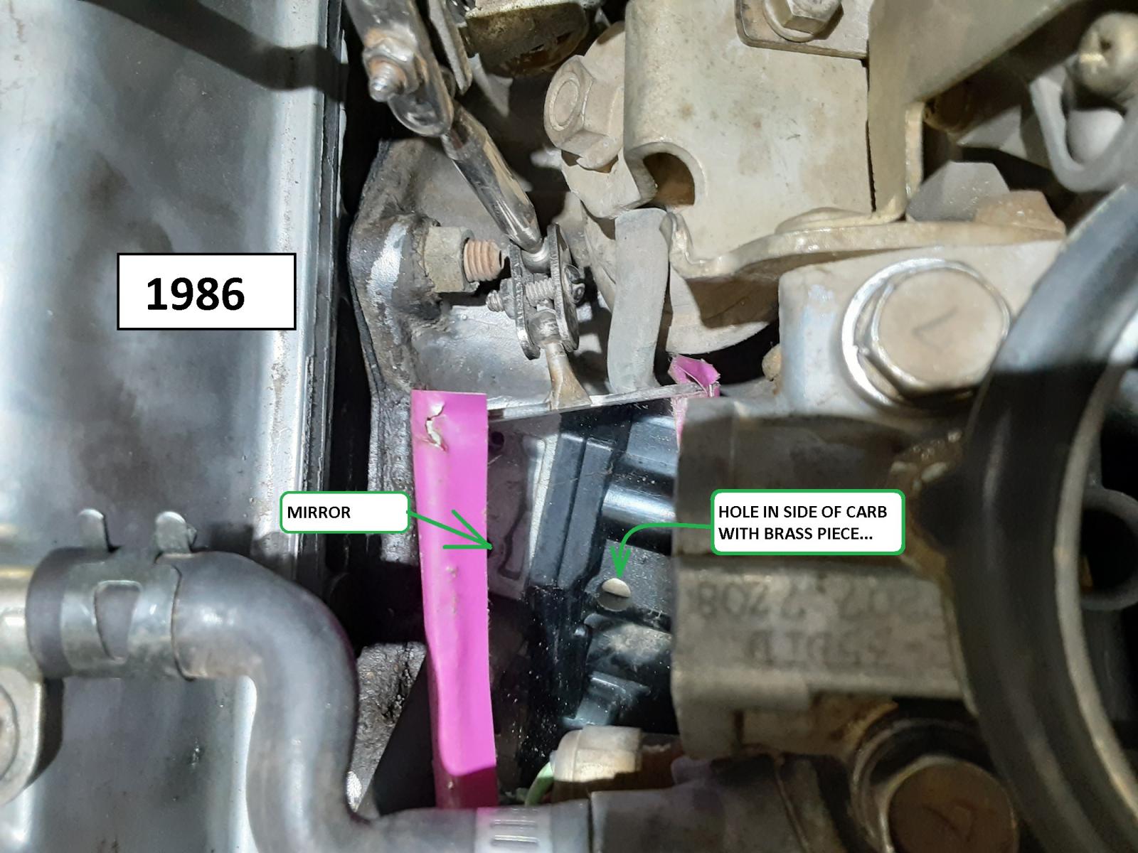

    I discovered today that my carburetor is original & never rebuilt, photos coming soon... I also know that the 1985 carburetor from PicknPull is all same as mine (except it's from a RAM50 RWD not 4X4)... From now on, I'll refer to this carb from PicknPull as "1985" & my original as "1986"
    Today, got photos of the HOLE in the phenolic resin mixing body on 1986 and unlike the melted edge looking HOLE on 1985 there is at least a HOLE on both carburetors... 1986 looks as though there is a brass shaft in the hole & 1985 looks like a ball bearing deeper in the hole... At least I now know that 1985 is not trash coz of it having the HOLE in the mixing body... When I first looked at 1985, I thought "oh crap, a nipple or something is busted off"
    1985 has a slight sticking spot about half way through the throttle travel & 1986 throttle movement is smooth throughout full travel...
    PLAN ??? as of today --
    1) Spray carburetor cleaner 'n oil on 1985 and install it on the truck, cross fingers & hope to get toilet tissue as needed..?
    2) Investigate possibility of machining 1986 mixing body and installing a spacer under the accelerator pump cover..?
    3) Rebuilding 1986..?
    4) Locate & purchase a non trashed phenolic resin mixing body..? good luck
    5) Order an Ultrasonic Cleaner from Amazon (Jeff needs more CORONA$$BUCKS) and Aliexpress cancelled my order..!
    6) Leave 1985 alone 'n keep it as an example how to reassemble 1986..?

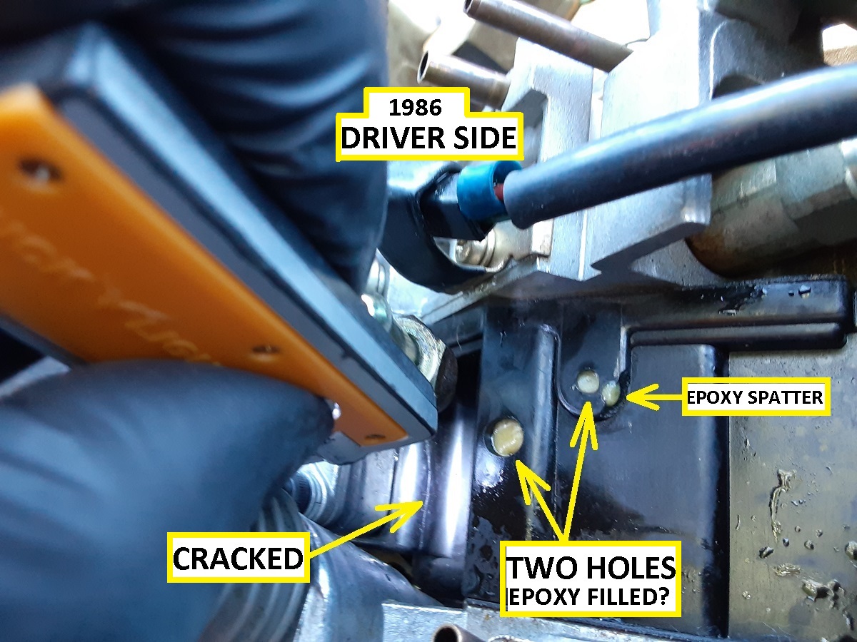

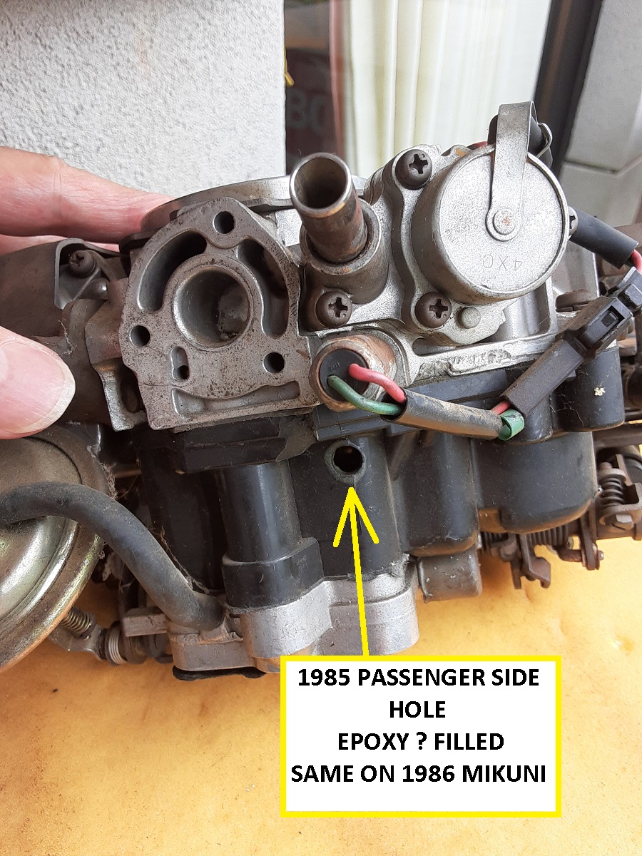

    UPDATE April 1st (No Fooling) Took photos of both the 1985 & 1986 Mikuni carburetors; looking the sameOh sameOh... They both have 3 HOLES plugged with what looks like two part epoxy... Not sure what the glue is meant to hold back or plug off: Gasoline, vacuum or close off the phenolic mixing body's casting vent holes..? Maybe I could use the same epoxy glue to fix the crack in my 1986 Mikuni (see carby2 photo)..?
    Truck ran perfect today although still had a little rough running the first minute while choked BUT it's much less rough less duration & no black smoke or rich gas smell like before... Starts quicker too & has more umph to do 80MPH in an area previously limited to 60MPH by the truck's performance...
    NO FOOLING HERE R PHOTOS:
    When they build carbs they have to cross drill galleries sometimes to get them to route in the direction they need to operate various vacuum circuits. They use pressed in brass plugs on cast alloy carbs to seal off the externally drilled holes and that wouldn't work on a resin bodied carb, so they use an epoxy instead.

    Just browsing this old thread & think it is ball bearings epoxied into the cross drilled holes of the Mikuni...
    Webers use alloy plugs. Nearly every every bike carb used pressed in brass that I'm aware of. All alloy Mikunis use brass as well and there is at least one exposed brass plug on the top cover of resin body Mikunis.
